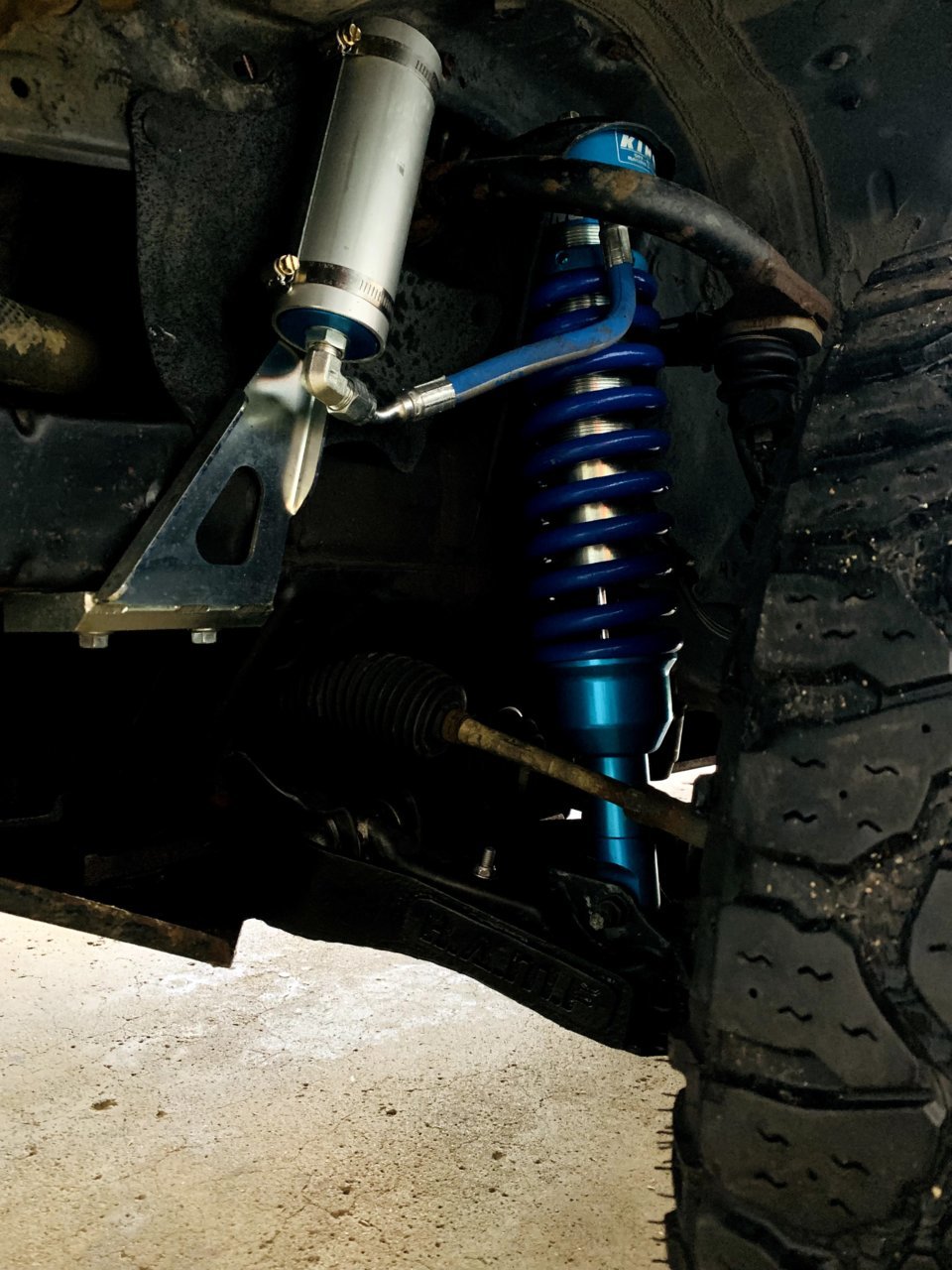

    Gonna add some super bumps to the front now and I should be set I think
