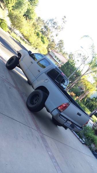

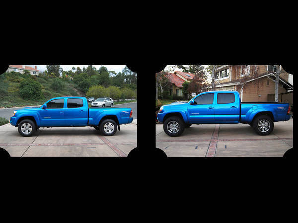

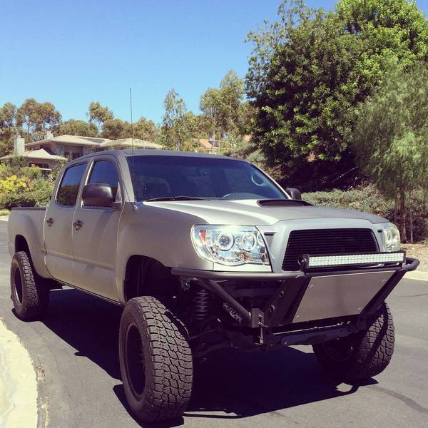

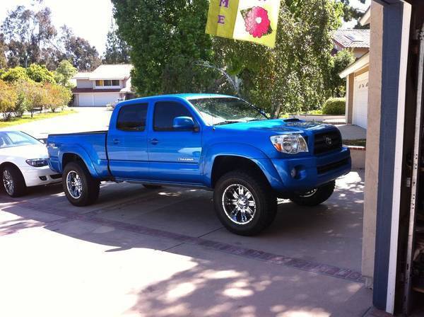

    ** The truck has been totaled and this build has come to an end. Thank you to everyone who followed my crazy build, commented on how much they disliked or liked the white or grey wrap haha. Until next time. RIP sweet taco.
    Build:
    Fox mid- travel
    TC UCA's
    Maxtrac 4" spindles
    Add a leaf kit in the rear
    285/65/18 Nitto A/T
    Prerunner Bumper
    Wraps:
    Matte White 2013
    Brushed Aluminum 2015
    JL stealth box
    Arc Audio speakers and amps
    [​IMG][​IMG]

    sounds good but I don't think one picture shows your truck well

    Welcome...truck is looking good. Post some more pics!!!

    Great looking truck

    do your tires rub?

    they did at first but a little bit of trimming did the job. Not to bad

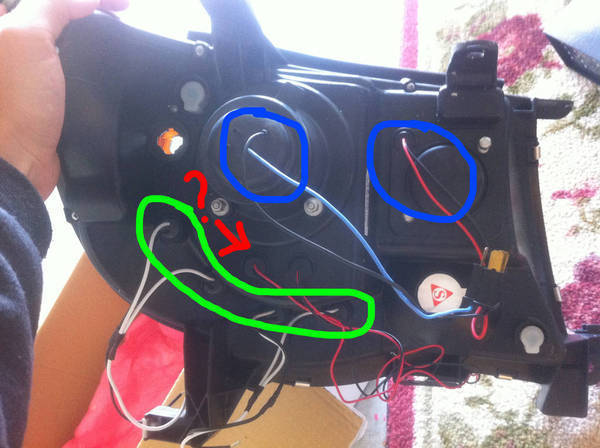

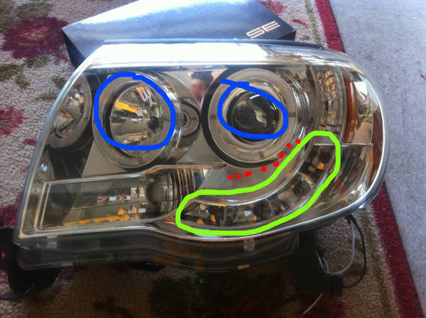

    will pay someone for help in San Diego

    yeah i got the same set up except mine are the smoked version, and i have yet to do the hid conversion yet. i was a labourous process and i dnt feel like tinkering wit hid conversions yet, the green marked wires (white) are your 4 led lights under the main halogen, i hooked those up to the main headlight wire, the two red and black ones above the white ones are your halo's. hooked those up to the orange side marker light. the blue marked wiers are this- the blue and black combo wires are the main, and the red and black combo wires are the high beam. those should plug into the socket after u disconnect the old headlights. if u need anymore help pm me, ill send u a pic on how i did mine

    yeah can you show me the pics on how you did yours?? that would be great thanks!
