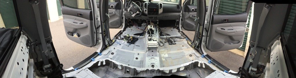

    *Update*
    Front and rear Diffs oils changed.
    Trans case oil changed.
    Fronts were a bit milky/cloudy. The others were fine.
    Greased up 5 Zerks. All I could find were 5, hope there weren't more.
    Rear diff breather mod parts ordered also.
    Everything is currently torn out so today ill be visiting local truck shops and sound audio shops.
    1. To get an idea of what I can do to make the cab more water resistant.
    2. Find out what recommendations are for some sound deadening.
    Oh and going to disconnect and grease up whatever connections are in the cab right now.
    Later this week Ill end up taking the interior carpeting somewhere for a professional cleaning(more than likely)
    Or just get lazy and take it to the local car wash and pressure spray it.
    That sound deadening material takes FOREVER to dry though.
  16. Aug 20, 2015 at 7:56 AM
    #36
    slcsez2000
    slcsez2000 Well-Known Member
    Jul 16, 2012
    #82775
    7,289
    St Aug, FL
    12 TRD Sport 4x4
    Exterior: -Current Suspension- Icon extended travel front struts w/ 700lb coils Icon extended travel Remote Resi rear shocks Dakar leaf pack Icon Tubular UCAs with covers Icon neoprene shock covers -OEM Roof Rack -2 fold down cup holders in bed -Bed bottle opener -Access lite rider roll up tonneau cover -AFE Prodry air filter -Pop and lock bed lock -Rear differential breather relocation mod (behind tail light) -Aeroturbine 2525XL Muffler Armor: -SOS Concepts bolt on sliders W/ kick out -SOS Concepts aluminum front bumper with full hoops -SOS Concepts Rear HC Bumper -SOS Concepts IFS/Mid skids
    if you find many points to seal up to better waterproof the cabin please post up details and pics....I would love to make mine more "water resistant" and have searched for this many times.
  17. Aug 20, 2015 at 8:19 AM
    #37
    mach1man001
    mach1man001 eh whatever
    Nov 4, 2009
    #25415
    22,413
    Rob
    Bellingham, MA
    2024 Tundra Limited
    I love my new truck but miss my Tacoma
    I just replaced my carpet. No way in the world all that soot was going to come out of it. :mad:
    I got mine stuck almost 2 years ago and never had any mechanical or electrical problems other than having to replace my starter. If it's running fine than you should not even have to consider trading it in.
  18. Aug 20, 2015 at 2:22 PM
    #38
    Jaahmez
    Jaahmez [OP] Active Member
    Sep 14, 2014
    #138285
    31
    Trading it in never crossed my mind. It still runs like it did before.
    I feel like it's a learning/growing point. Although I wasn't ready to go down this path yet I guess there's really no better time than now.
    I'm gonna work inside out anyway.
    Got quoted 350 for raptor-ing the entire interior. I've done all the hard work and removed everything anyway.
    They'll end up doing a couple coats.
    I guess there's the possibility of applying it over the electronics/wiring but he mentioned they'd pull everything
    to first.
    What do you guys think?
    And as far as drain holes go, I'm only going to leave the higher on on the rear hump for now because I need to run coax through it, I'll seal it up myself when he's done.
    Other than that there just an abundance of dead space in here.
    I talk for about 2 hours to a professional line-x guy and he helped me realize that's not really the way to go about this.
    Line x is a pressure spray and it's just wayyyyy too much work to be done in a cab, the prep work alone is astounding.
    He actually wasn't totally into the Hercule/raptor/lizard skin idea either for fear of under rot.
    He made a great point about potentially sealing in moisture and dirt and over time that would become cancerous and I wouldn't even know until it was too late.
    But unfortunately I'm a risk taker and for my level of application and the situation I'm currently in; I'm probably gonna do it next week when my bike gets done.
    Do basically, the raptor will be tri- purpose if done correctly.
    Water sealant, sound deadening and heat protection.
    I still have concerns about the electronics, there just so damn much of it.
    But I honestly don't have future plans of taking this baby swimming anytime soon, so why not.
    Other than that this had given me the opportunity to properly mount my cb radio and inverter and run the wires nicely.
    That's about it for now.
    Oh and I finally pressure washed the carpet. Still had a lot of shit come out, might still take it for a shampooing, haha.
    slcsez2000 likes this.
