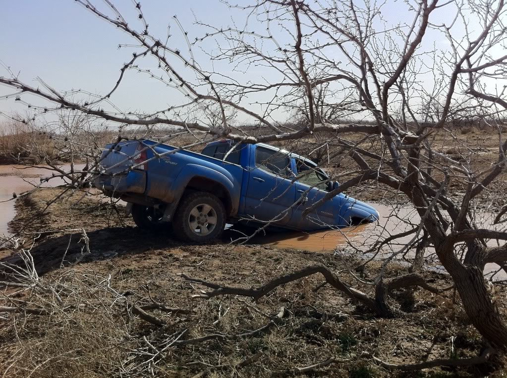

    I think it's important to mention the ONLY way you'd suck in water from the tail pipe (if that's even possible) is if the truck is stuck nose-first on an incline. When you're stuck like this, water enters the tail pipe and flows up it towards the headers. If you are stuck butt-down it shouldn't be an issue. And yes, I too have been here before. My intake was under water and I was smart enough to kill the engine almost immediately as soon as I realized we weren't getting out of that shit.
    My advice for anyone who's flooded the cab is to do the following...
    1. Strip the interior IMMEDIATELY. Seats and carpet must come out ASAP.
    2. Remove the stock carpet pads. They're worthless sponges now. Go to Home Depot or Lowes and buy new home carpet pad. A roll of it is something like $20 and that's more than enough to do the whole cab.
    3. If you can't get a carpet cleaner to steam clean the carpet within 24 hours use a can of unscented Lysol all over the carpet to ensure nothing starts growing on it. This will prevent mildew from setting in till you can get it steam cleaned with a legit carpet cleaner. This step is critical.
    4. The starter motor is likely going to start failing soon so expect it. Since it sits so low on the engine, water gets in there and slowly corrodes the copper contacts on the electromagnet. If your starter begins to exhibit symptons, remove your starter and dismantle it. Blow out the water with an air compressor and use some fine grit sand paper to sand down the copper contacts where the large bolt slams down on the contacts to complete the circuit.
    5. This is a good time to change all your fluids. You have no idea what seeped into the reservoirs whilst sitting in the water for a period of time.
    6. If you were in a nose-down situation your headlights likely filled with water. Good time to do the BHLM while you have the headlights apart to clean the inside.
    If you do these steps properly your truck will be as good as new. Not many people know (or would guess) I've flooded the cab. PS: This was about 4 years/70k miles ago. Truck runs like a champ.
