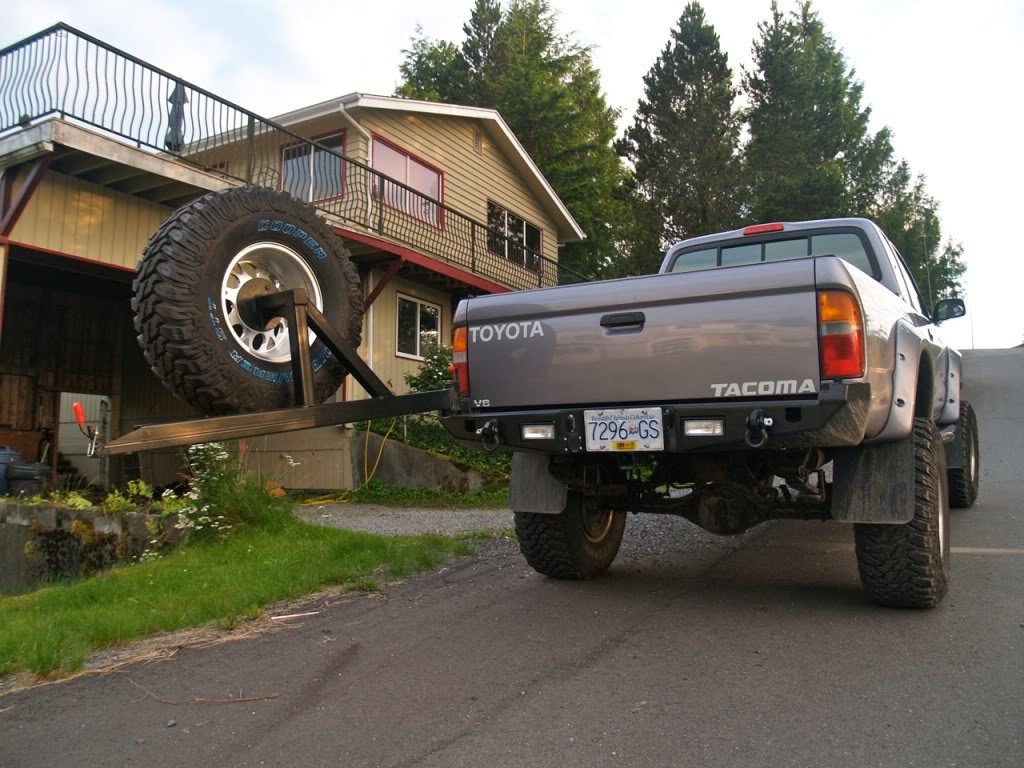

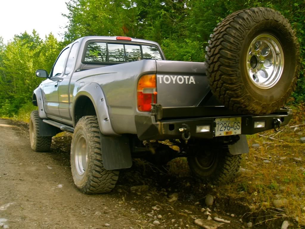

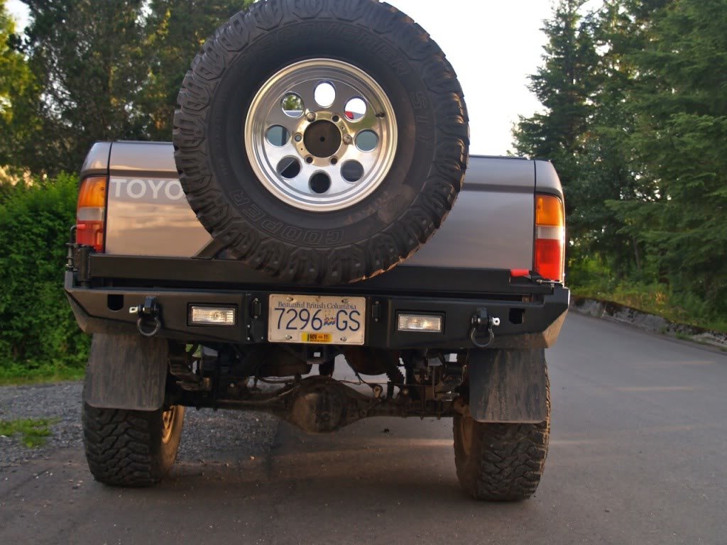

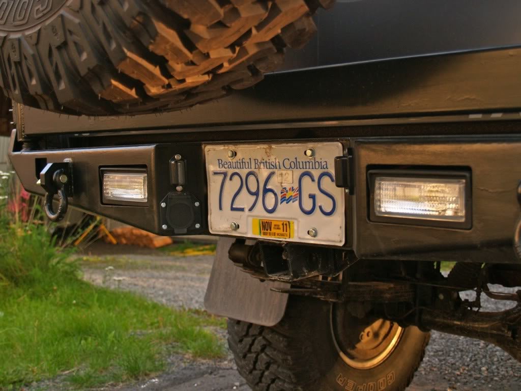

    Here's some pics of one on a 1st gen rear.
    Final swingout design on future 1st and 2nd gen bumper orders may be slightly different than the one pictured. It was the 1st one built so there were a few things i'd like to do slightly different for future ones. :cool:

    Eric , what size is the pin ?
  9. Aug 5, 2011 at 11:17 PM
    RelentlessFab
    RelentlessFab Tacoma offroad armor fabricating beast Vendor
    Feb 17, 2008
    #4772
    14,860
    Eric
    Eastern side of the Sierras: Sparks, NV
    07 SR5 6mt to 03 SR5 to 08 Sport and 17 6MT TRD OR
    Relentless Armored! Too many others to list.
    Spindle?
    I believe 1 1/2" spindle shaft diameter with 2 1/4" DOM for the outer sleeve, and has tapered roller bearings. It's 1750lb rated IIRC.
    However, I may be switching to a different spindle in the future. It's not due to one really being better than the other, but because there is someone local that makes them so its a little easier to just call them and then go pick them up when needed versus having to order online and deal with shipping these things and the time of shipping. Shipping was about $20 for 2 of those spindles due to their weight!
