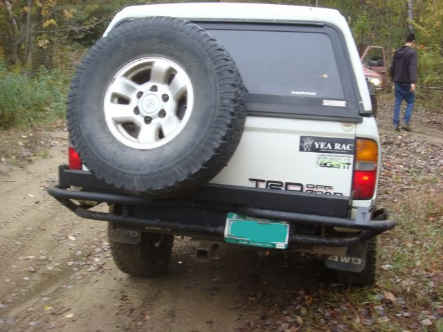

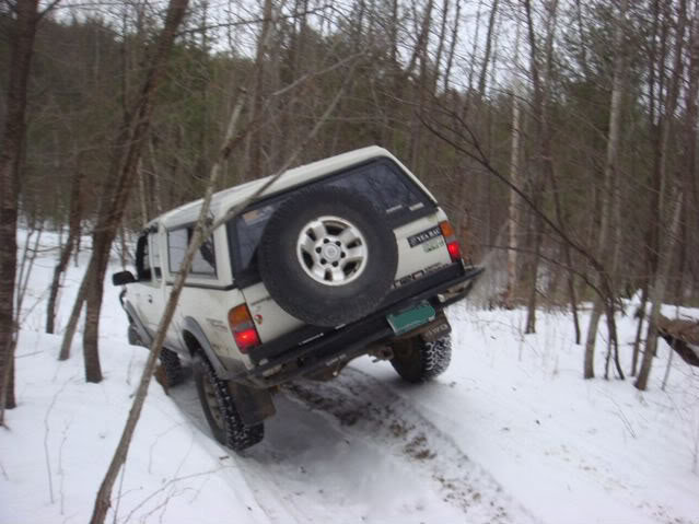

    Here ya go... I built it with a friend. It was on my old truck and now it's just sitting in my driveway. If you want more pics just ask.

    Oh and sorry that it has a tire carrier...but I could have just as easily skipped the tire and put cans, jack, and tools like you mentioned. It's just a rectangular metal bar welded to a trailer bearing (for a spindle).

    so what did you use for the bracket? im assuming you went of the existing one, but what thickness of metal did you use? i have like quarter inch, and figured that should be plently good.

    uhh 3/16ths I believe. It is just as strong as quarter inch. But yeah we took the stock bumper off and used the same mounting bolt holes in the frame.
