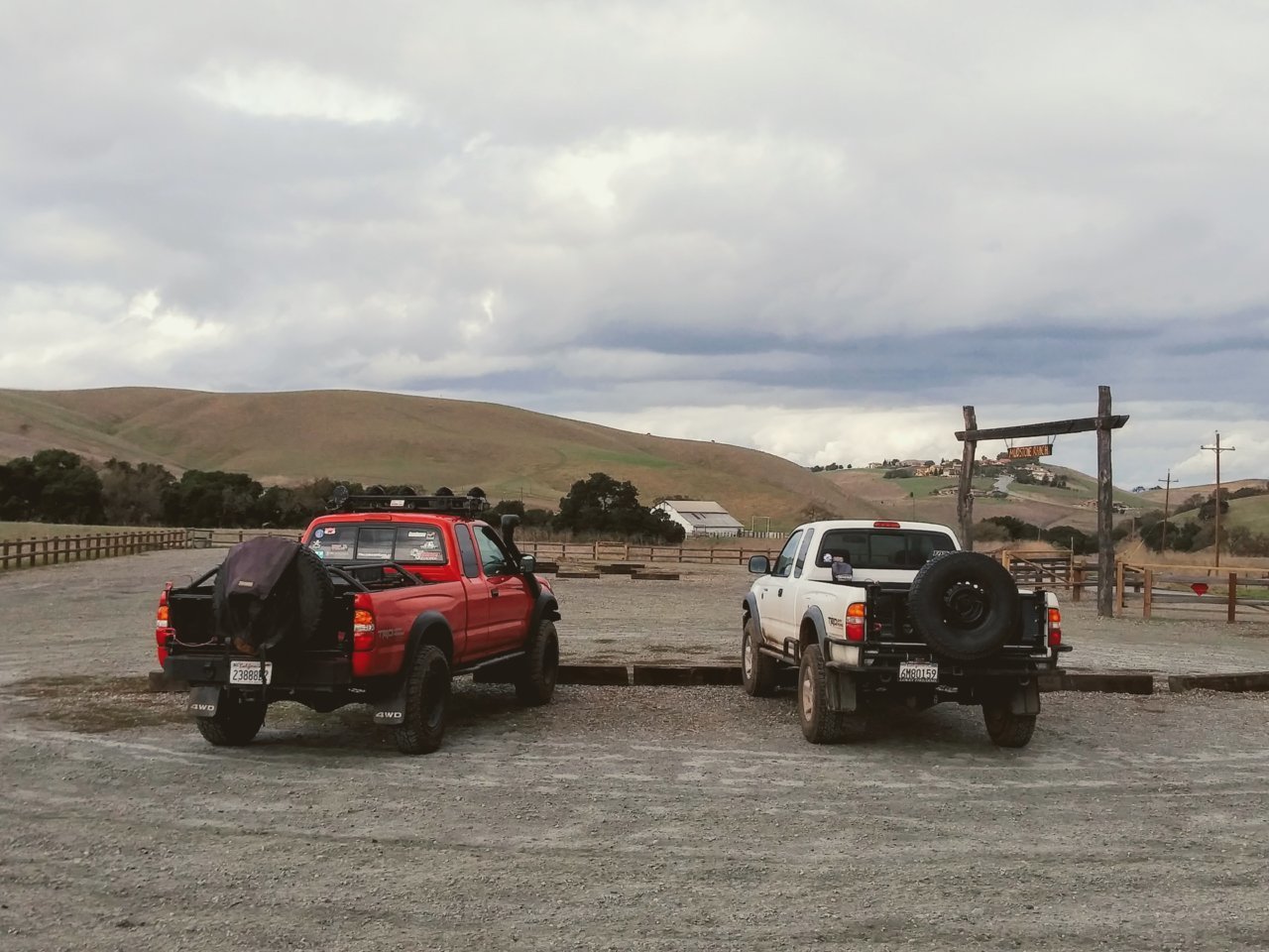

    On the otherhand, @GHOST SHIP fabricates a pretty badass tire gate that works similarly, except he can add shit like a fold-out table in case you're not able to fabricate your own. This one belongs to @eon_blue (red), next to my old Tacoma (white) -
    You can have these built onto a rear bumper as well, or just order one from the handful of companies that still make them.

    swing out bumpers are cool but spendy if your'e going to buy one already made. The swing out tail gates like pictured above are a nice compromise, but you do lose the tailgate. I love mine but not having the tailgate is sometimes inconvenient when camping or if I have to put something in the bed that's longer than the length of it.

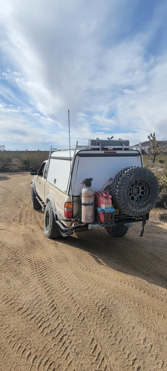

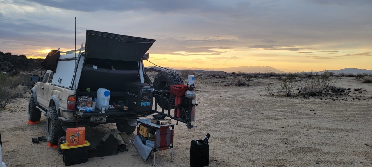

    Op if you can I'd consider a duel swing out. Having everything on one side definitely makes it so you have to compromise on how you setup at camp ect beacouse you have a long pole to walk around. .. it's not really a big deal but definitely something to consider.
