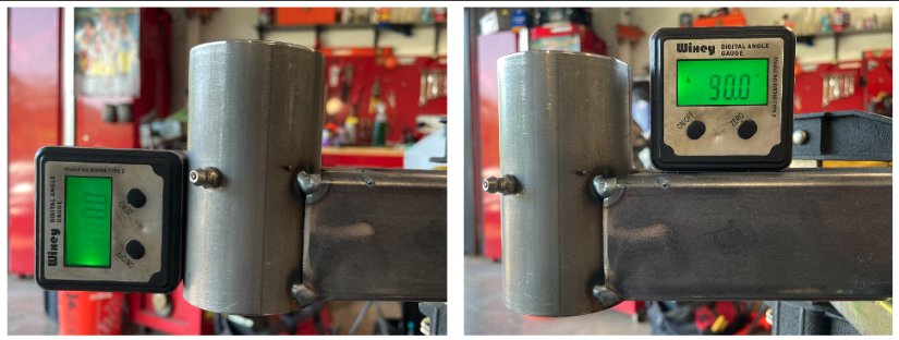

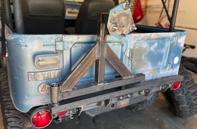

    Get it mounted how you want it and go from there. Not sure about the adjustments but when I built the swing out for the bumper on my 40 I got it all tacked together while it was mounted - so I used the magnetic angle finder A LOT to square it up and get it setup. Get it all tacked while the bumper is mounted and then optionally remove to finish the welds

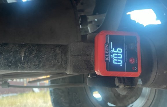

    phone works well but one (or 2) of these is invaluable ...
    I think you commented on my other thread where it appears someone cut my ABS line on my Tacoma - strange. Can't wait to put some eyes on it Saturday

    Digital angle finders are awesome, I use mine every time I'm doing shop work.
    As for the swingout, you can get away with slightly thinner tubing if going larger - 2" x 3" at 1/8" vs 2" x 2" at 3/16"
    Lastly, keep in mind when setting things up that your swingout will "sag" a bit when it's open and has weight in it. You can offset the mount a tad to make up for this but a little sag is normal and expected.
