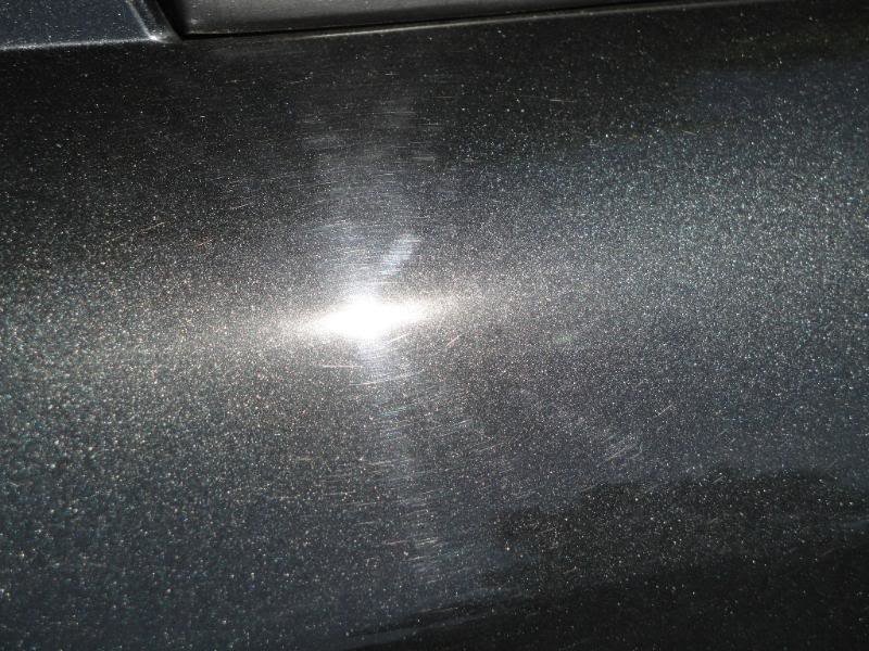

    It can. Heres an example:

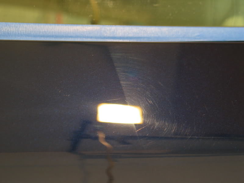

    And heres a 50/50 shot using halogen light. Half corrected, half not.
    I've been at it for a long time, so can hopefully help point you in the right direction :)

    thanks peeps and yeah the first pic is like mines exactly
