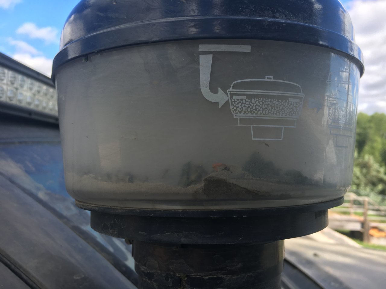

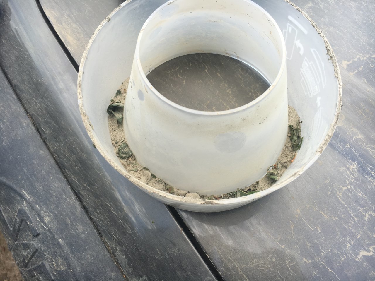

    I bought a pre filter for our Swisha trip..

    Surprised the size of the stones that picked up.

    Most likely a sand ball. While driving I can actually peer over and look into the pre filter and see the vortex spinning, with some wet weather/puddles, and dust it creates balls similar to rolling snow to make a snowman.

    They do work good but in my mind it’s one more moving part that can fail. Not a deal breaker by any means in the situation as it not catastrophic, it just means you don’t have a precleaner anymore. Also our wood chipper has an enginaire precleaner on it and it seems like they fail every 3 years or so, but that’s on a machine that’s at wide open throttle everyday. Not the case with a pickup truck so it will probably last much much longer. I prefer the bowl style myself for the simplicity and I just check it when I’m on a trip and do my morning walk around. @Chux pics are after a few days so it’s not like it fills up fast.

    How in the world did it get those rocks? That's pretty amazing how much crap it caught.
