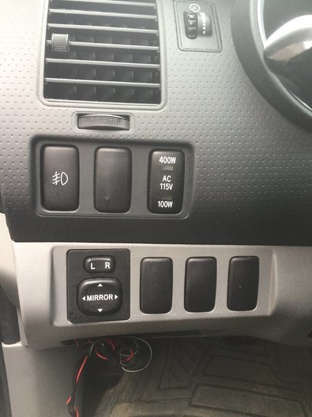

    I am trying to pit a switch in my truck in one of the blank knockouts, when I reach up under I can only push out the bottom row, there is no way up to the top row, anyone know how to get at the top row knockouts? beside the foglight switch

    Looks like the best way to reach those blank switch slots is to drop "just the lower section of the dash panel". Not really hard to do just be careful and take your time.
    Check out and inspect what tool(s) is needed (small screwdriver? 1/4 socket?, etc.) for removal.

    i used a plastic pry bar but be careful put a rag on bezel not to damage it the bezel scratches easily and pry on bottom than side.

    put a wood screw in the blank, in the middle of the blank, and just pull, good luck. It works great, added fogs, was able to access everything fine without removing anything else.
