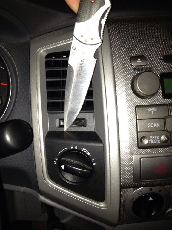

    Take something like a thin butter knife and stick it in the top between the switch housing and the air vent and gently pry it out. The whole switch assembly will pop out. Just be careful not to scratch things up if that's something your worried about. Here is a photo.
    4835019A-2594-4D13-A346-05840168B032-287_d697b04f1418e5c3be6a5029bfa59ba79e974da2.jpg

    Thanks moon death..there is always an angle to take when working on something in the dash to get it out. I was not sure if it was the top or botom or possible the whole area by the air vent. looking at the multiple posts looks like replacing this switch happens on occassion.
    Door ding I have a Harbour Frieght store close...for 6 bucks why not
    thanks
