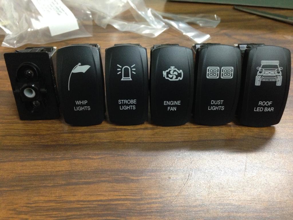

    tacomonazul Well-Known Member
    Mar 4, 2012
    #74163
    3,384
    Luis
    SOCAL
    07 DCSB LT/4LINK
    http://www.tacomaworld.com/forum/2nd-gen-builds/227832-my-never-end-build.html

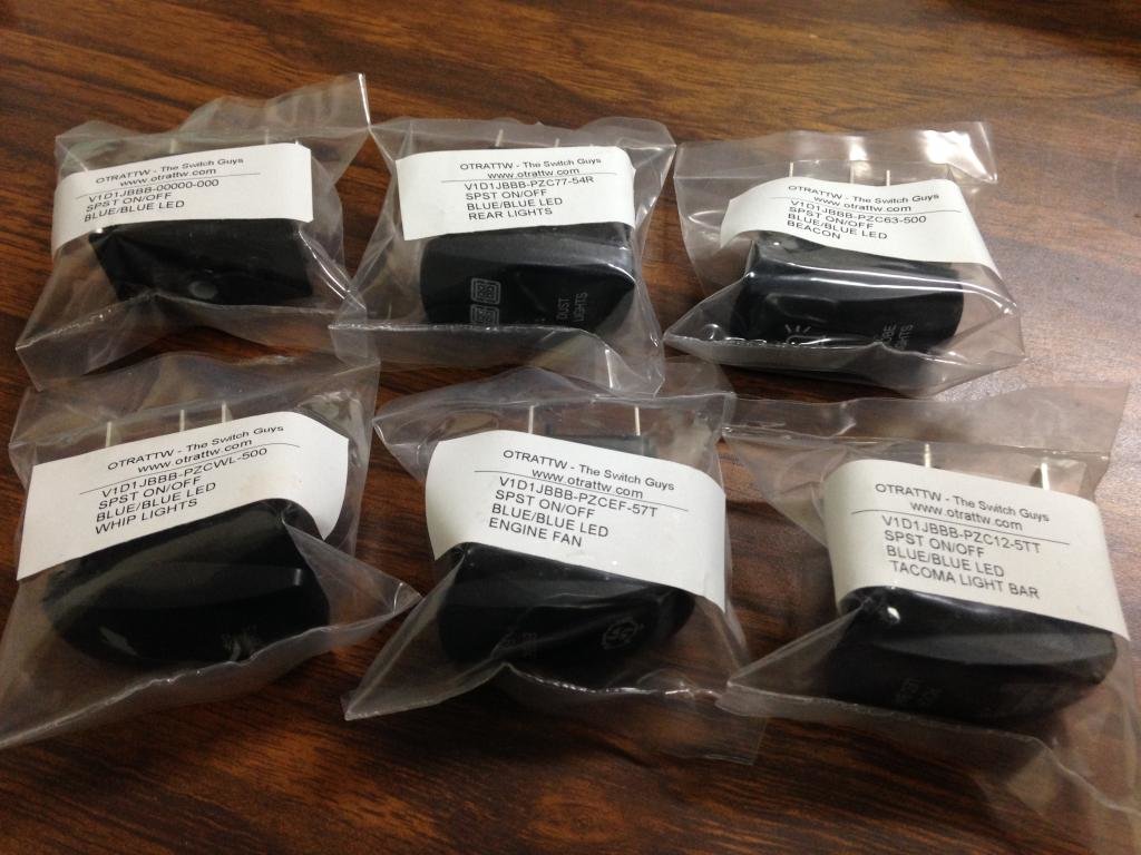

    Received my switches :woot:
  10. Jan 27, 2015 at 10:47 AM
    #670
    Iggy
    Iggy [OP] Well-Known Member
    Feb 2, 2012
    #71971
    4,016
    Northern CA
    09 4x4 Off-Road Access Cab
    Check out the build
    Looking good!

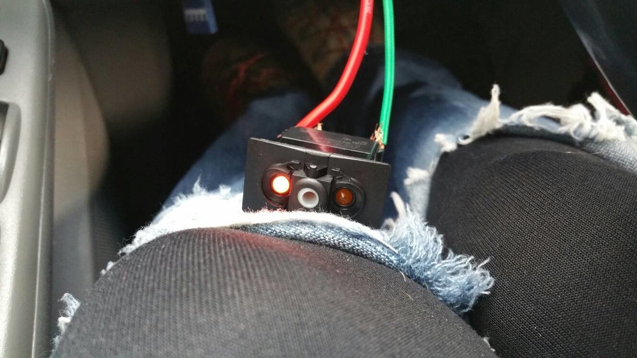

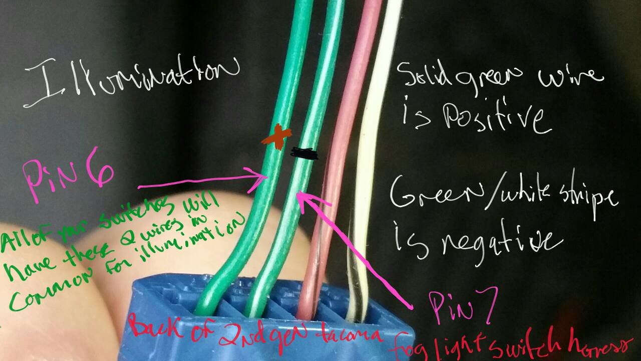

    Quick question anyone with a '13+ figure out how they ate wiring the v1d1 switches from otrattw? Me and skygear have been working on wiring the switches with his fuse block and I think he figured it out and I'm going to test it tomorrow. Just wanted to see if others had any other info

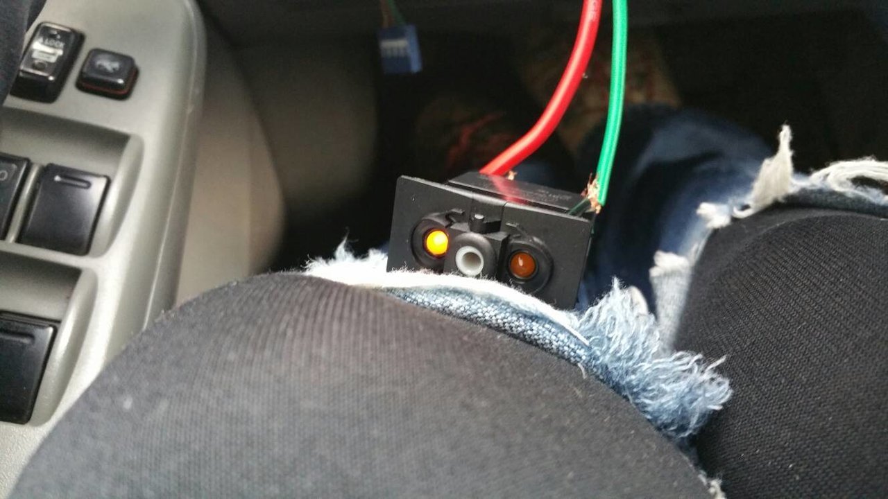

    Here is your holly grail pic for the illumination wires for the tacoma 2nd gen/
    This is proof on the illumination works with these wires I notated in the pic above.

    Light, Bumpers, and lots of switches.

    You're my hero. I just used the positive wire and got spotty output.

    Some flags and center console divider... lots of things on the wanted list.
    That's from the fogs switch? Instead of routing wiring from your battery?
