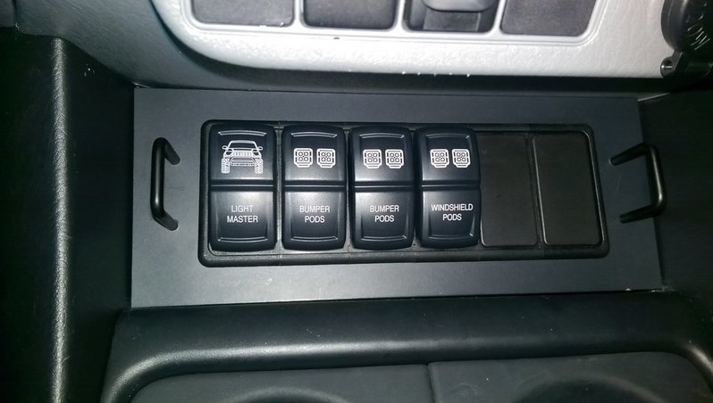

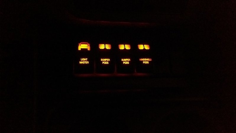

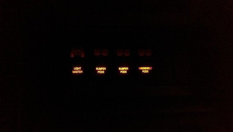

    Quick question for anybody that can help me. I am using the green and green/white wire from the back of the fog light harness for the switch illumination. I have the green (+) wire hooked to pin 8 and the green/white (-) hooked to pin 7. The switches I am using have the lower independent led. I am not getting any illumination in the switches and now my fog light switch will not illuminate. Can anybody tell me what I'm missing.

    For the lower light, you should be using pins 7 and 6

    Yeah right after I posted I realized they sent me with the wrong switch diagram. I got it all figured out. Thank you. IMAG0666.jpg IMAG0667.jpg IMAG0665.jpg

    Good deal! Looks good!
