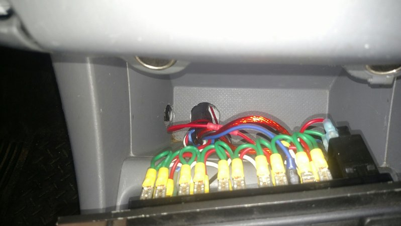

    Where are the wires being ran through? Just drilling a hole in the back? Couldnt seem to find any pics in the thread

    Yep just drill a hole in the back pocket area and run everything through there. I'll try to snag a pic when I get home here in a bit and load it in.

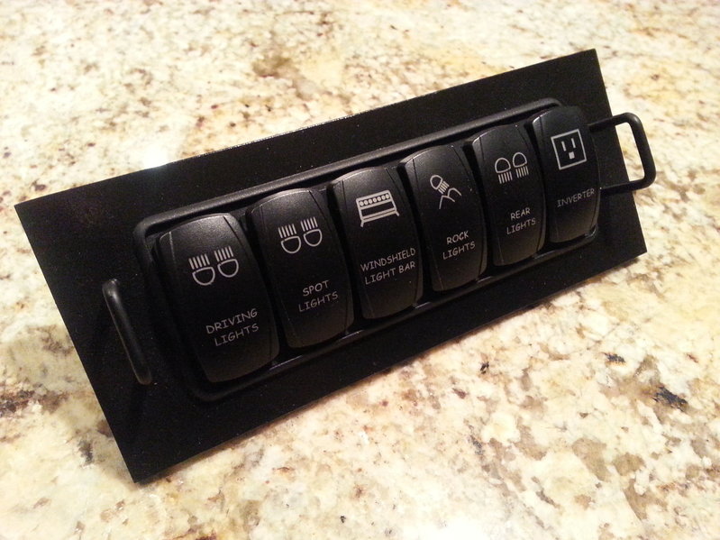

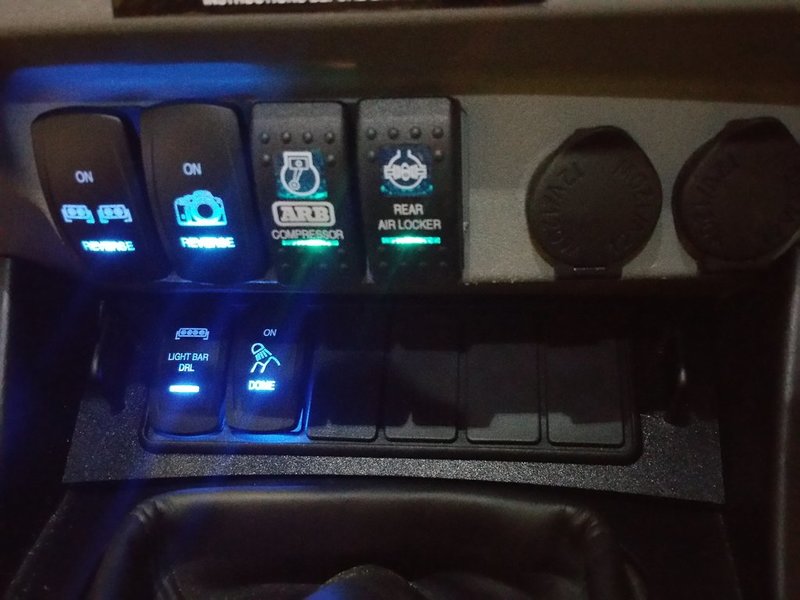

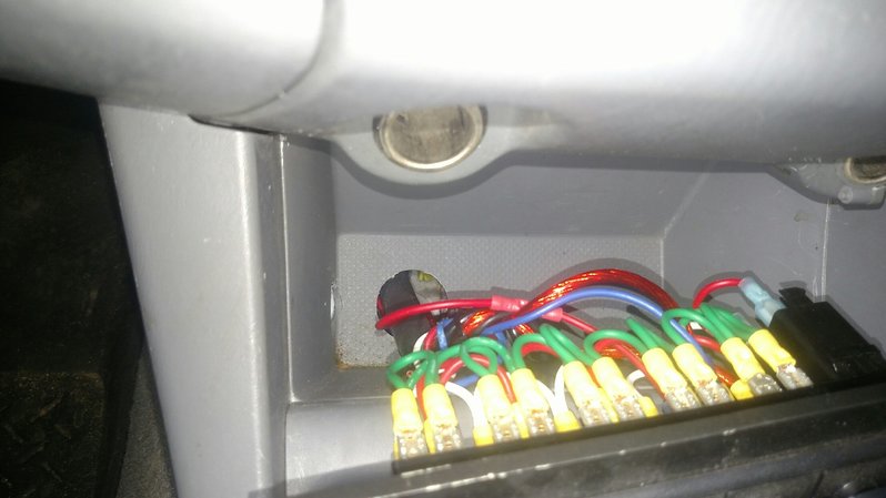

    Okay so here they are. As it shows in the 2nd pic the hole on the far left was the 1st one that I cut and figured that the wiring took too much of a turn that it started to bend the wires a little too much. But to do it again I would move them a little closer together and just make it a little bigger. Mainly for the way I bundled the wiring. The last few pics I'll add, or put up again, is how I'm holding in the panel.............in case anyone missed it from a few pages back.......
    Here are the magnets that I used....
    https://www.kjmagnetics.com/proddetail.asp?prod=BX044-N52
    https://www.kjmagnetics.com/proddetail.asp?prod=BX048
    Epoxy I used to the panel....
    Additional magnet behind the plastic of the console right where the pen tip is pointed....
    Way the magnets are mounted to the panel.......

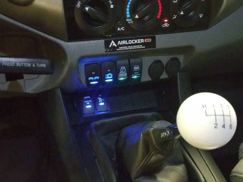

    I finally got around to installing manual trans panel. Came out pretty good.

    Yeah, looks good. I just wedged that sucker in tight to hold it in. Pushed the bottom in kind of hard and it felt like it slid over a hump and wedged in good. Is that how it's supposed to be?
