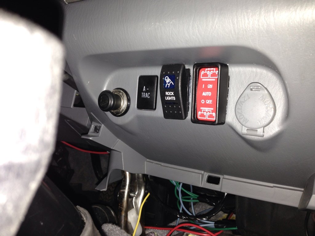

    Yea it's a PITA to get to, but if you go for it, it would be wise to wire all of the switches, even if you don't have anything to use the switch for yet. Feed a wire out of there so that when you do add something, you don't have to take it all apart again.
    Mine:
