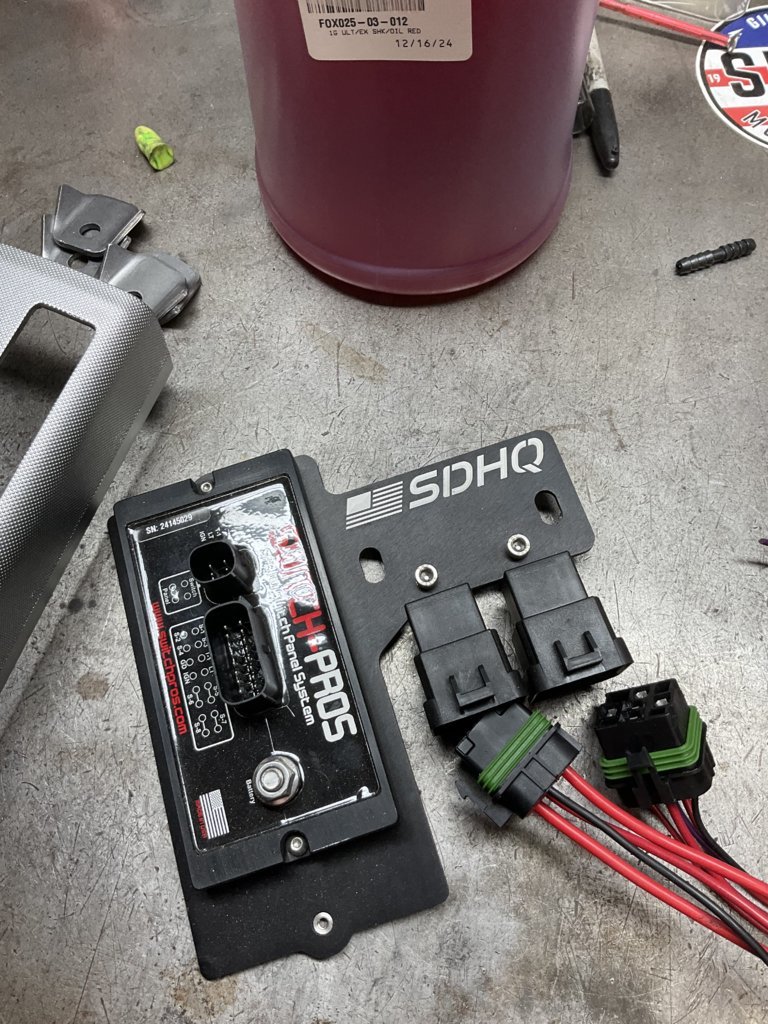

    I’m currently in the middle of my SwitchPro install. I’ll be using the SDHQ Module Mount in the engine bay.
    The SDHQ mount... The two relays are for the Module to power on with Key On, and the other relay is for the DD Fog Lights. I have the Diode Dynamics Background Light circuit to pin 87A of a relay that I installed that powers the Diode Dynamics Back Ground Light whenever the actual Fog Light is off. It’s simple and works perfectly.

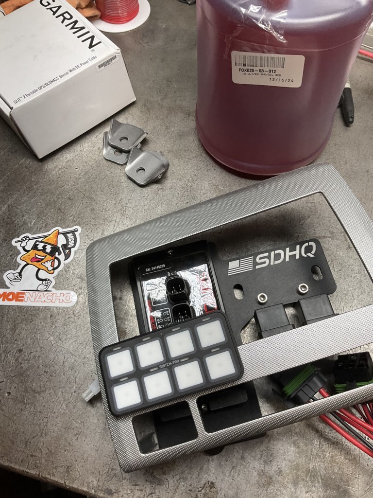

    The Switch Panel is mounted on a new Metra Double Single Din Dash Mount. I’ll be installing a new Single Din Alpine Head Unit at the same time ..something finally that has Bluetooth built into the unit..
    A tiny bit of material needed to be removed..
    There’s going to be a tray the will run the bottom length that will extend out roughly 1-1/4”. That todays project..

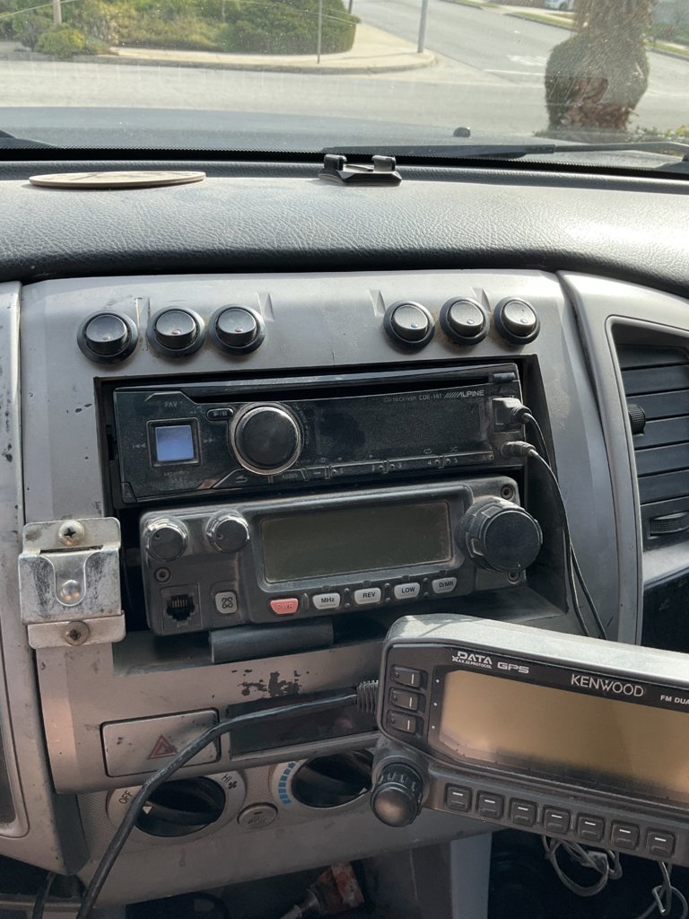

    The current setup that I did way back in 2009, still rocking to this very day.
