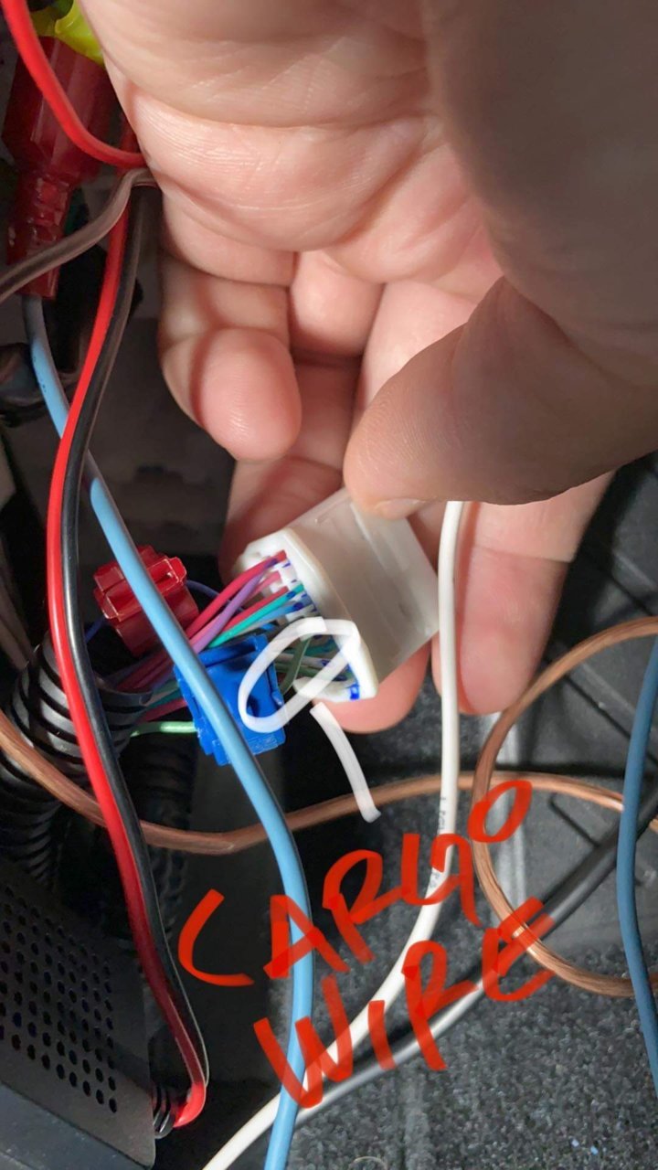

    Can anyone help me to find which wire the dome or cargo lights for a 3rd gen 2020? I'm trying to tap my trigger 1 wire (pink) to one of them so it will turn on some of my lights that I've enable to turn on when unlocking the truck. so far, ive looked through forums and I believe I found the wire for the dome but its not triggering the other lights that I've enabled to turn on when unlocking.

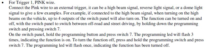

    It's for the 2017 MY, but I can't imagine it would be much different, if different at all.

    with the trigger wires, if it detects some power, for example the dome lights, it will trigger whatever that is enabled to turn on without the Ignition being on. Example you can make the chase lights turn on when the door unlocks from the dome light, or the cargo lights

    Yeah there’s 2 trigger wires. Each wire can trigger 4 outputs

    so I definitely tapped the cargo light wire and I'm positive its because I used a multi-meter. I enabled the function in the app low and high and its still not working. I'm trying to have my raptor lights that is connected directly to the switch pro on switch 4 and its not turning on when I unlock the vehicle.

    And you've enabled both function? You need only low.

    i connected to a green wire down in the drivers cab area. One of the plugs. And yeah I’m just saying I tried it on high and I tried it on low

    yes and yes. I used a multi-meter and it’s definitely that wire. Turned it off, went to 0. Turned it to door, hits 12v.

    that’s what one thinking too but I squeezed it pretty good with pliers

    so I checked my t-tap and its good. it spliced into the wire and its pretty secured and trigger 1 or 2 isn't working at all
