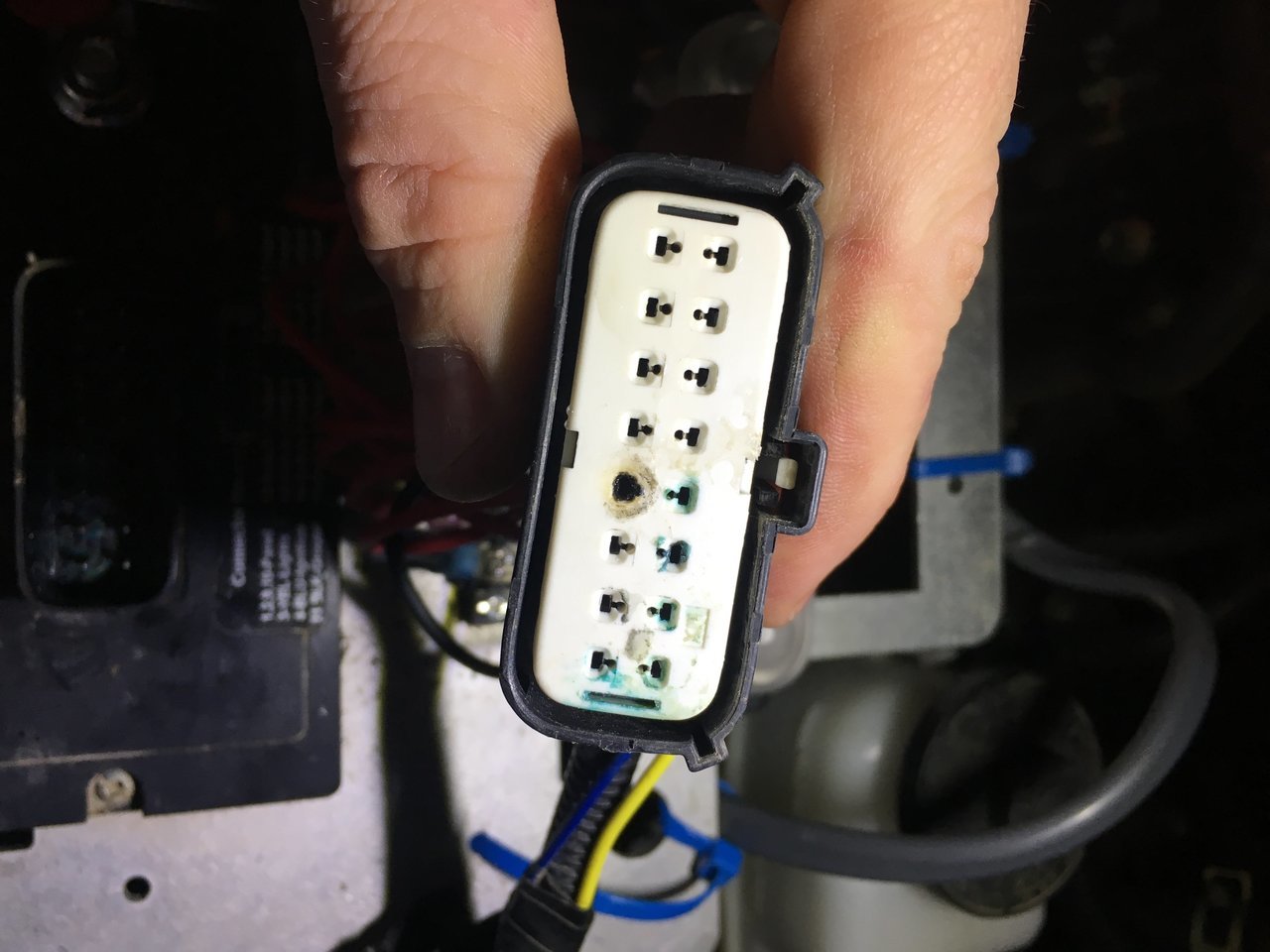

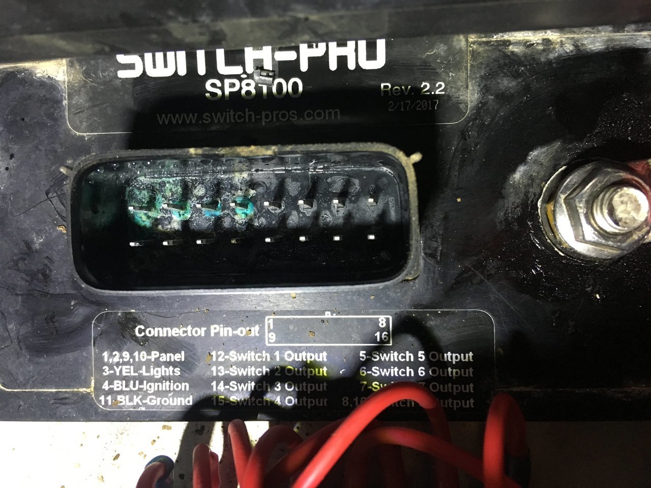

    So, talked with switch pro today and they confirmed there was an issue with the wire/pin that I was looking at. Which I had suspected, as when I touched it it would give a flashing orange light on the switch pro button and cut the power to the accessory. Didn't matter what accessory I wired to it either, I was changing them all around to see what the issue was or whether it was the actual accessory itself. The accessory I had wired to it is under the amperage limit for the switch as well. My light bar runs at 16.5-amps and the connector is rated for 18a according to their website. Which states 7 connectors at 18a and one at 30A which if I remember correctly is the bottom right pin.
    They sent me over the instructions to dismantle the switch pro and replace the plug/wire, we were hoping that it just wasn't seated properly in the connector when it was manufactured, which I guess sometimes happens. Well once I got the connector off the base, I found the problem.
    With how my base is set on the truck at a slight angle to the drivers side and a bit to the rear, I can see the path the water took down the wire, shorted the pin out and worked its way along the bottom/back of the switch pro to the four pins in the back rear corner of the plug. So much for these connectors being water resistant. Although I suspect the issue is the pin was not seated properly as I can feel the wire moving, which seems to be more of a manufacturing defect.
    I'd check your connections if you have one of these and check for signs of corrosion, there should be none, keep in mind though i live in the PNW and am all over Northern Canada with my truck in constant freeze/thaws, so that may play an issue as well? Although I have never seen corrosion in any of my other connectors. Regardless, if you do have corrosion clean the contacts and coat them in di-electric grease.

    They replied to me late last night, Rob must have been burning the midnight oil. So they are going to replace the wiring harness and base for the switch pro. Although I may just have them upgrade me to the new one when it is available for whatever the cost is to do it. In the mean time, on their suggestion, I am taking the cable lead off that switch and moving it to the one adjacent to it, which is a blank on the switch pro at the moment so that I am able to use the light bar on my upcoming trip here in a few days time and not risk further damage to the connector. Fingers crossed.
    Make sure to check your plugs to make sure they are not corroding especially if you're in the same manufacture date range as mine (February, 20, 2017) on the switchpro, any sign of green/tarnish is an indication of moisture getting into the plug these are suppose to be sealed plugs and should not have any corrosion at all, if none I would coat them in dielectric grease to help isolate them from shorts. I am sure this is a one off incident, but better safe then sorry, last thing I would want to see is to read up about is someones rig going up in flames and I didn't say anything about my connector. Their warranty is amazing by the way, zero hassles, although I would prefer to never have to use a companies warranty at all.

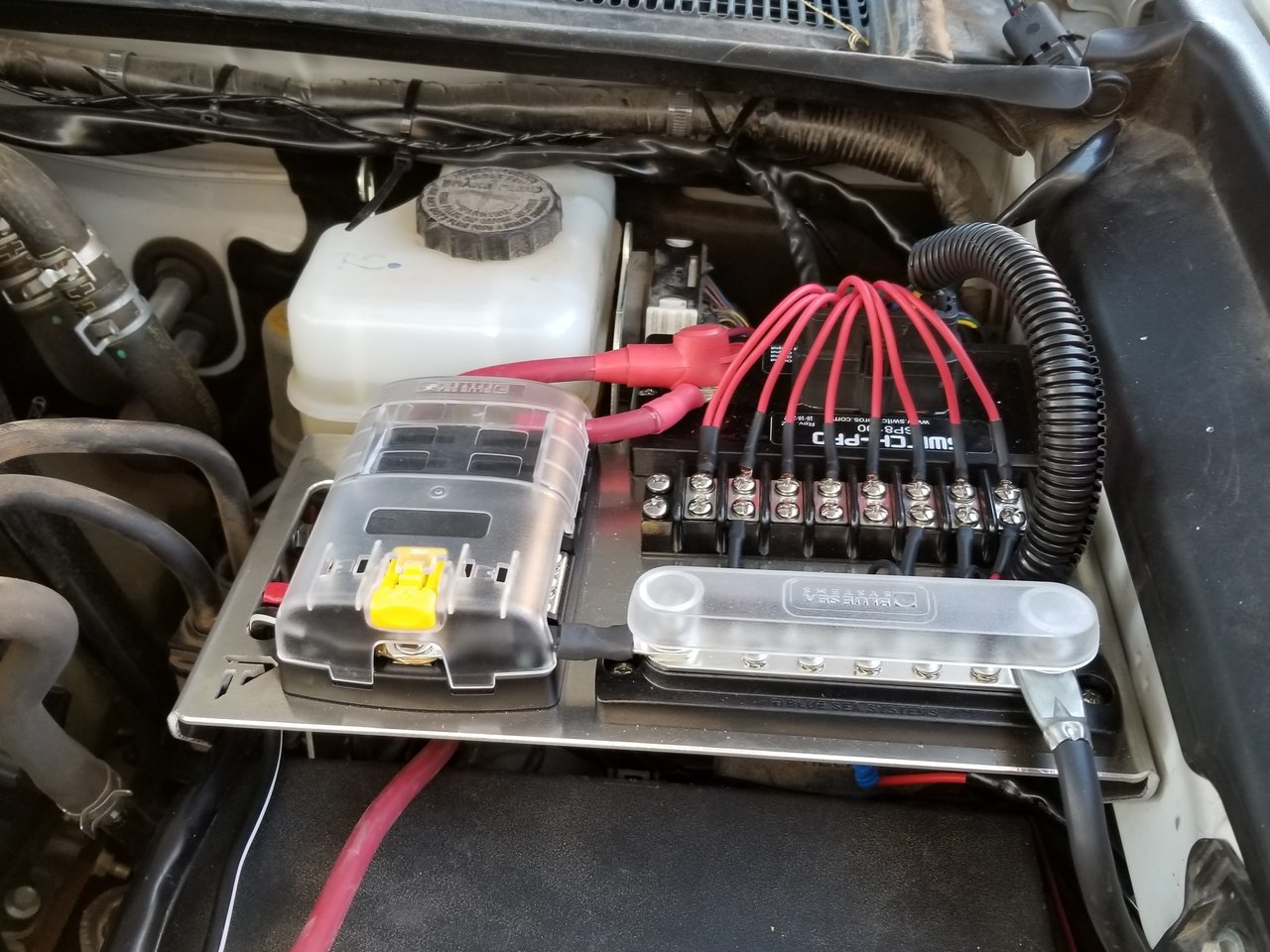

    Does anyone know if the 8100 and 9100 have the same base footprint? I bought a powertray, painted and installed the other components (fuse box, terminal block and buss bar) yesterday and now am worries the 9100 switchpro (which ships Monday) wont fit into the predrilled holes as it was designed for the 8100.

    For what its worth, the Amazon descriptions list the same dimensions "6”L x 3”W x .5”H (excluding connectors)".

    The brain bolts up the same as the 8100.

    Their xustomer service is amazing. Rob and Laura are fanyasti. To talk to. My 8100 failed by leaking water into the connector and fried a couple of the pins. No questions asked they shipped out a new one and uograded me to a 9100.
