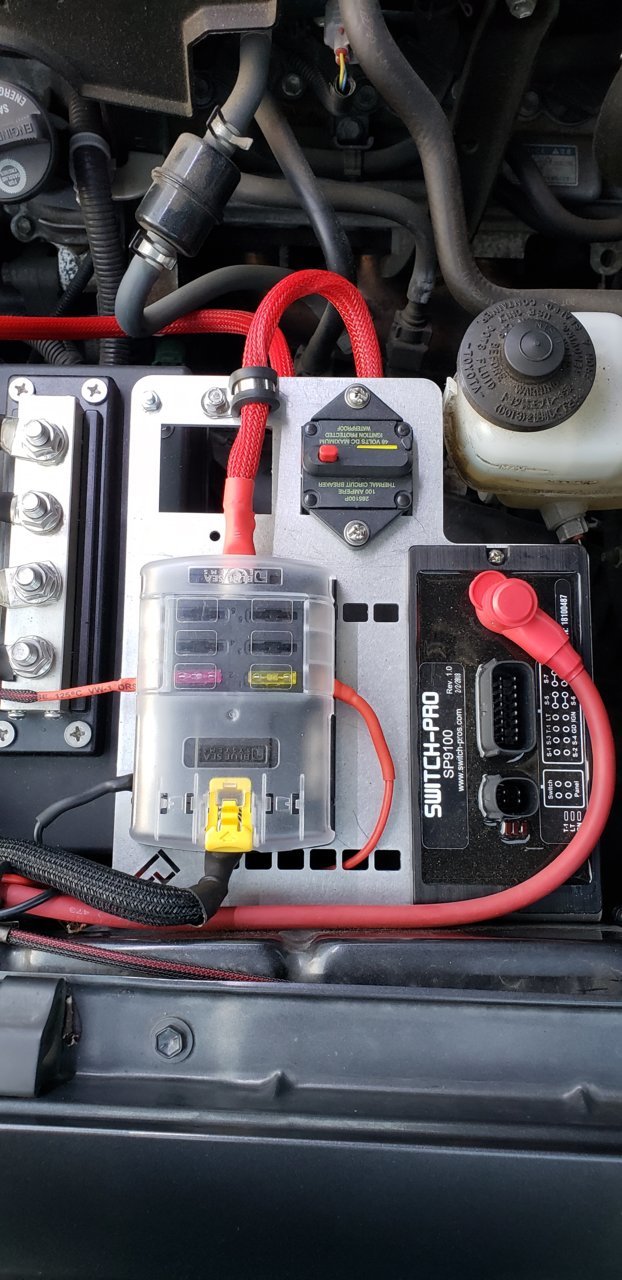

    No, that pelfreybuilt mount does not have a hole for the switch pros unit and that black piece mounted to it is not a switch pro. That's a fuse box that will be mostly pointless with a switch pro installed because it's the low tech equivalent of a switch pro.

    That's what I was thinking. Just wanted a second opinion. Thanks

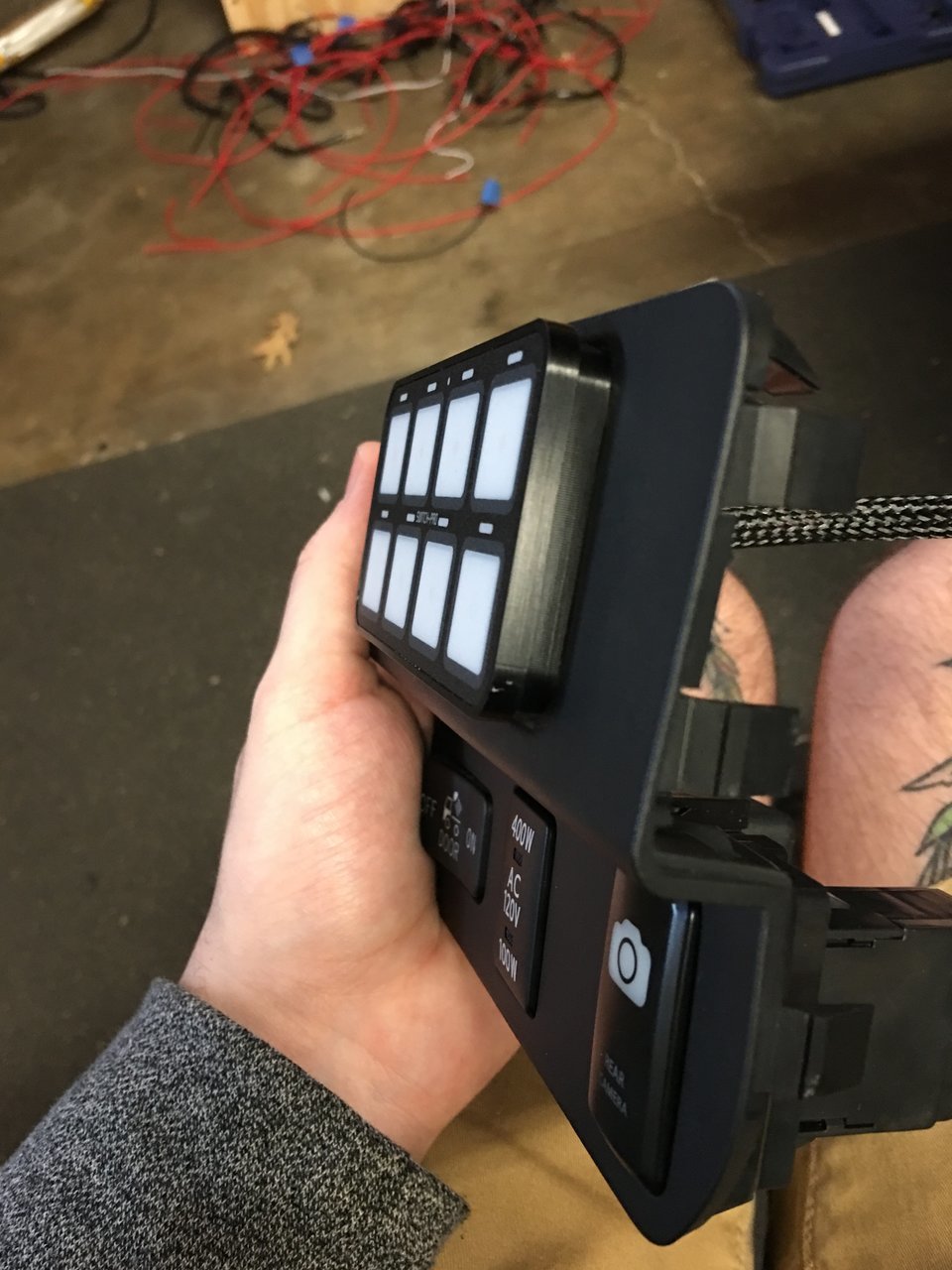

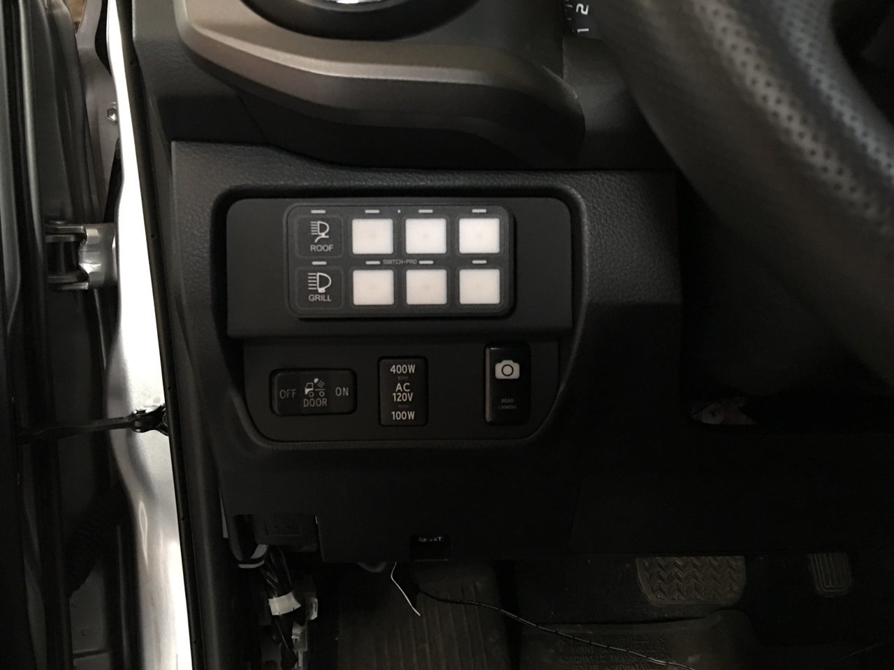

    Part 1 in the bag... (h/t @monkeyevil )
    Laser level
    Almost done / done

    I got it right here. Had to drill a few extra holes in Pelfreybuilt mount, but works well. Had to switch to the smaller BlueSea (will use the other for solar at the house). I use the Bluesea for things I dont need to switch. Inside hood lights, Hella horns, etc.

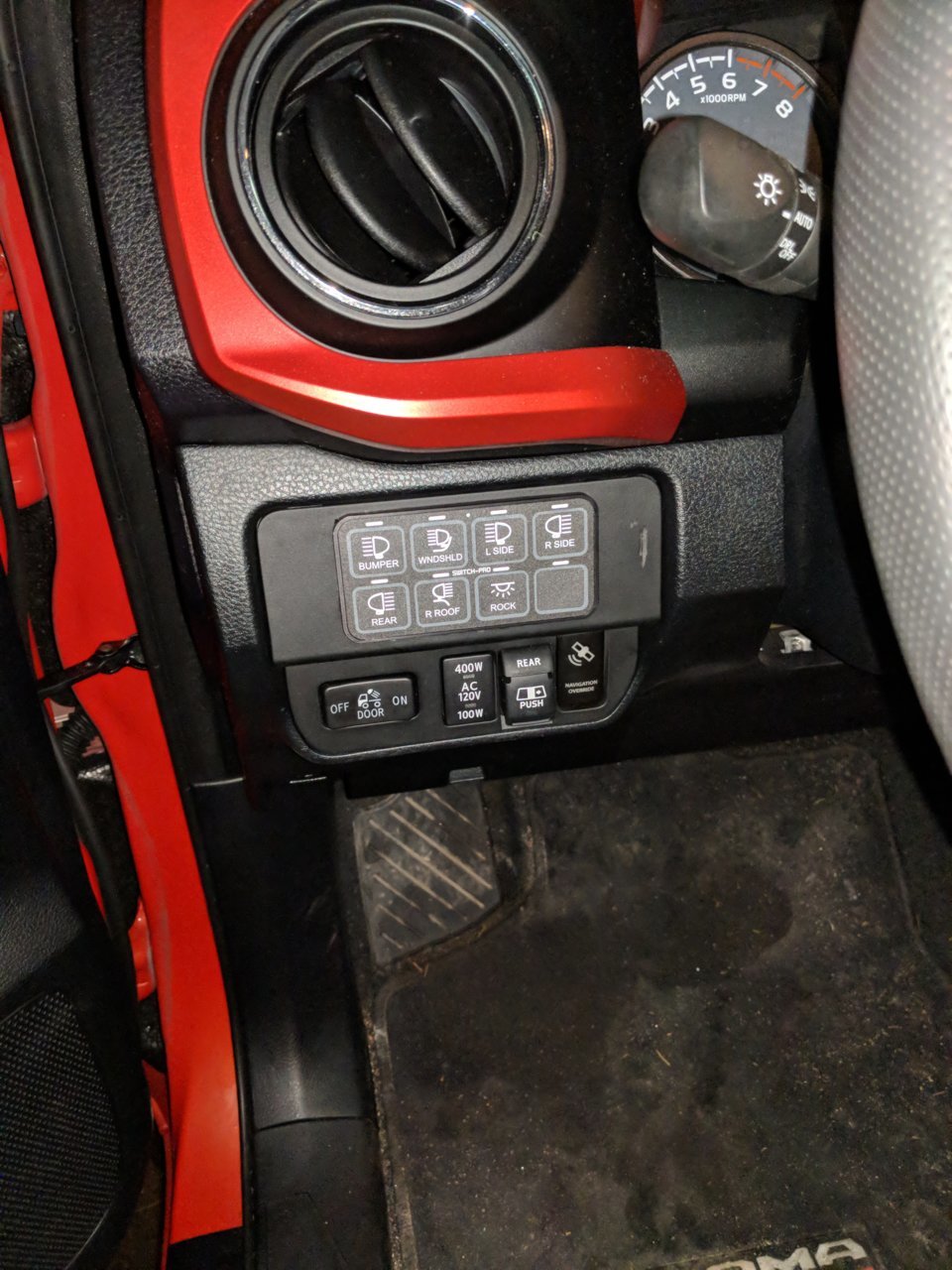

    I used the existing cubby, trimmed the opening a little bit and attached it there. It isn't flush mounted, but it works for me.IMG_20180211_222522.jpg

    Yep I just used the hardware included, removed the plastic cubby and installed it there. It’s been great the whole time since whenever I posted, never had it wobble or needed to retighten the bolts!

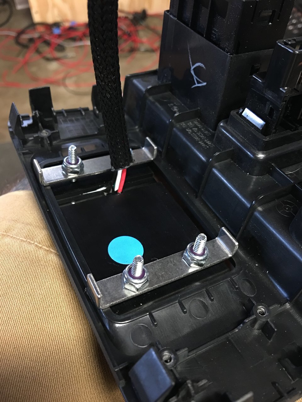

    I don't have one of meso's... I trimmed the piece the original cubby spot to fit the inner bezel of the switchpro.

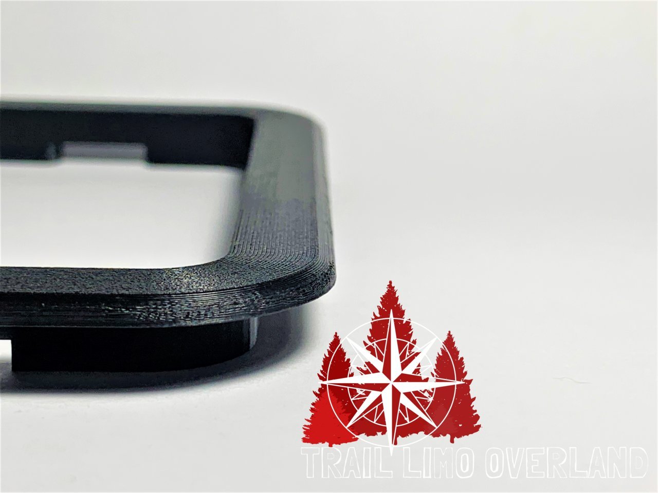

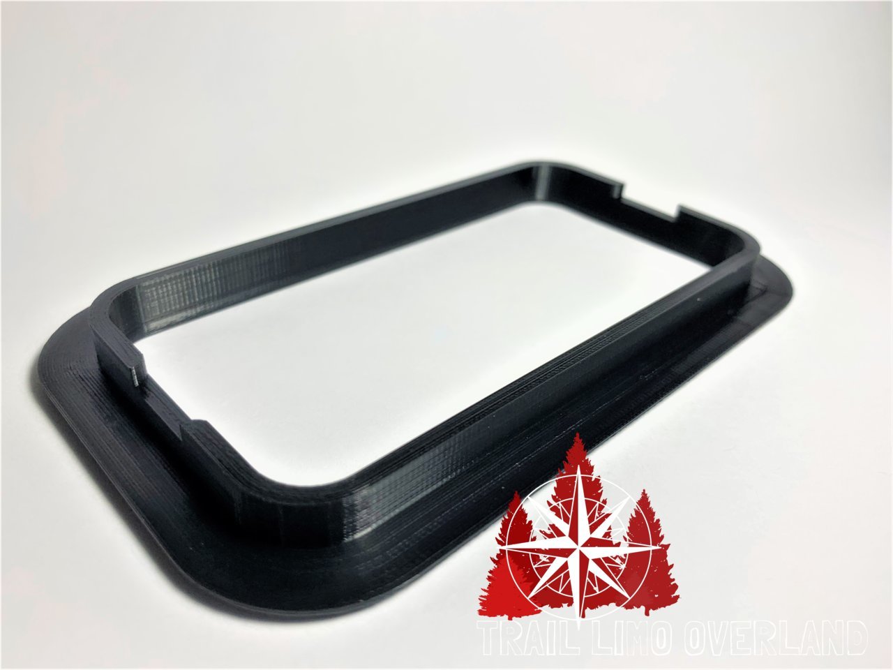

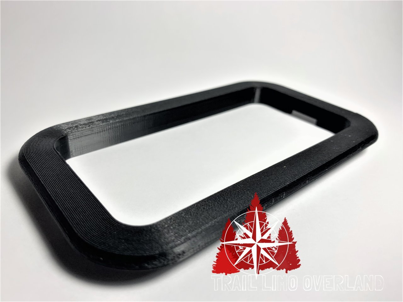

    Hey all! Reviving this threat to announce that I’m printing bezels for Switch Pro controllers.

    Looks good. PLA, ABS, PTEG?
    I’d hit the face with an acetone finish fto clean up the layers but other than that nice job:)

    I am using PLA. Accetone is not as effective as on ABS. Sanding, wet sanding and a metal polisher would do the trick.
