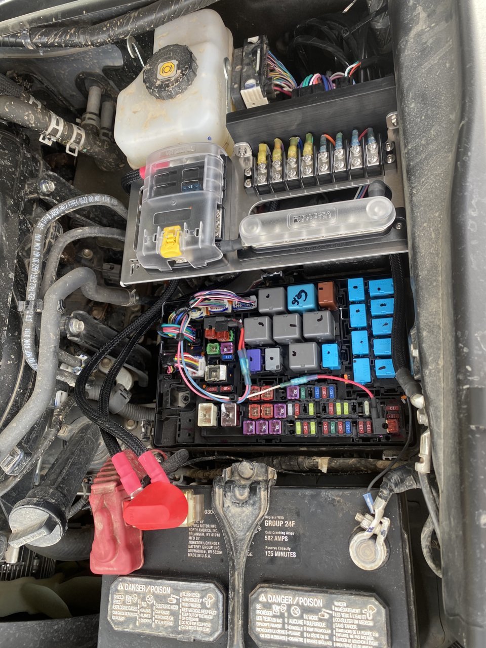

    baja squadron pros
    Just finished my install over the weekend. Absolutely love this thing. Now i need more stuff.lol614404D0-4D97-4433-AC34-1B6EE16C5F7C.jpg
