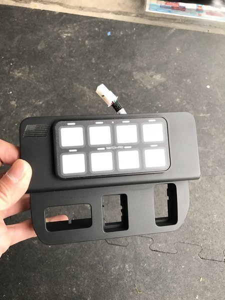

    Joethebugman
    Joethebugman [OP] Well-Known Member
    Aug 10, 2016
    #194254
    345
    Joe
    '17 Trd OR DBCLB
    $30 for the trim piece shipped. $499 for the SwitchPros unit.
