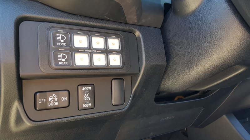

    Almost done. Just need to run the cable inside...

    Playing around with the strobe function last night...
