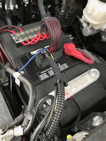

    Yeah, I saw the pic of the ARB harness on the main page and poked in to take a look. I'm looking at doing the same thing for the PDS, but a different solution. It looks like they simply tie into the factory ARB harness rather than making a new one, same with Spod. I think I'll be making my own from scratch.

    The loose ends connect to you your switchpro out puts. It looks like it takes 3 outputs, 1 for the compressor and 2 for lockers. the other end connects to the harness that comes with the compressor where the factory switches connect.

    I think it does becuase you use the harness supplied by ARB, this just plugs into that.
    The top harness is what powers the compressor and the second harness towards the front, that connects to the switches, is what gets replaced by the one they make. You can see the same 4 pin connector there.

    I just heard back from Switch Pros and they have confirmed this. The red wire goes to the switch wire on the sp8100 and the green/yellow are for connection to lockers.
    "All you have to connect is the red wire to the switch pro's red output wire, for air compressor operation.
    The green and yellow wires are for the arb air lockers, if equipped."

    did you use a ground bus bar as well? If so, do you have pics of that?

    Yeah it's the one below the Switch Pros module with the oval clear opaque cover...

    Where did you purchase the black protective wire covering?
    Sorry, I know that not the right name for it, but just cant think of it at the moment.

    Amazon has it. Its called woven wire loom I think
