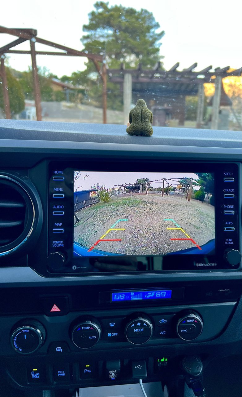

    You can also use a seat heater switch that puts both seats in one switch. 8D0C22A6-F107-4A7A-ADDC-F5876717F1D8.jpg
