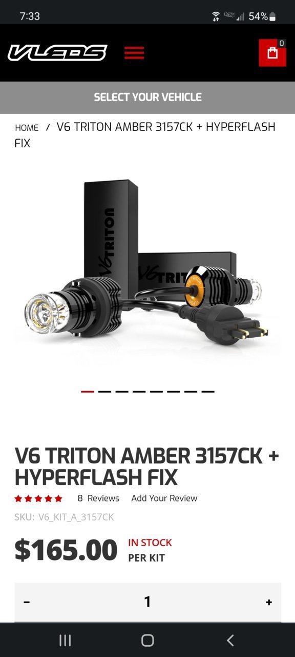

    I've done some research and been directed to these by some members. But been procrastinating on purchasing. Pricey, maybe that's why.

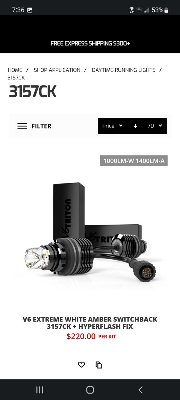

    They have other types/colors. If u want white for DLR I think this is the one .
