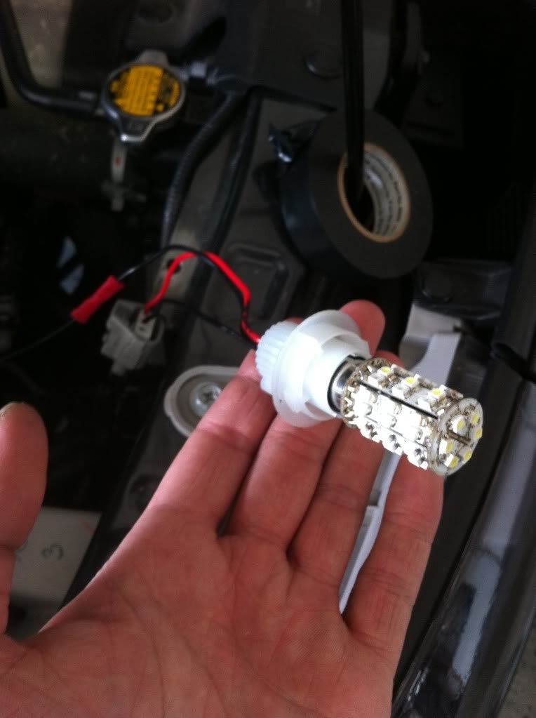

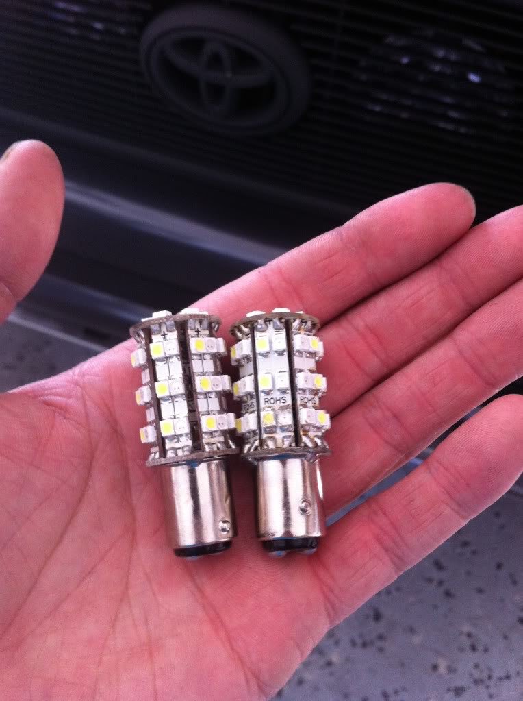

    yes its been done heres someone who did it
    i have these LED switchback lights i bought a few years ago for my old car. i couldn't quite sell or let them go, so i decided to try and install them on my truck.
    as you can see these bulbs are 1157 and in order for me to install these bulbs on the taco i would have to convert the stock 3157 socket to an 1157 socket. so thats exactly what i did. found some 1157 pigtail sockets at my local pepboys and spliced into the stock harness. i had already done the dtrl mod so i just had to figure out which wire went where. oddly enough i found the new socket pops into the stock housing pretty snug. i have to figure something out to make sure it doesn't come off when off roading though.
    now you ask why i went through all this trouble? this is why:
    48 SMT LED switchbacks: $30
    LED FLASHER FIX: $15
    (2) 1157 Sockets: $9
    to have 6000k white running lights and amber turn signal from just one bulb: PRICELESS!!!

    Well I was anxious and installed them with the load resistors. But for some reason they flash amber-white-amber-white after I cycled the DTRL on then off. Going to disable the DTRL alltogether tomorrow and see what happens.

    The LEDs are polar so try and switch them around in the socket. I installed them the same way you would do it on a 1st gen. Tapped power off the corners and put a resistor on both sockets.

    Ok so I pulled the pin for the green/red stripe wire out of the connector to permenently disable the DRL in my truck. I always keep my lights on anyways. Everything now appears to be working as it should.
