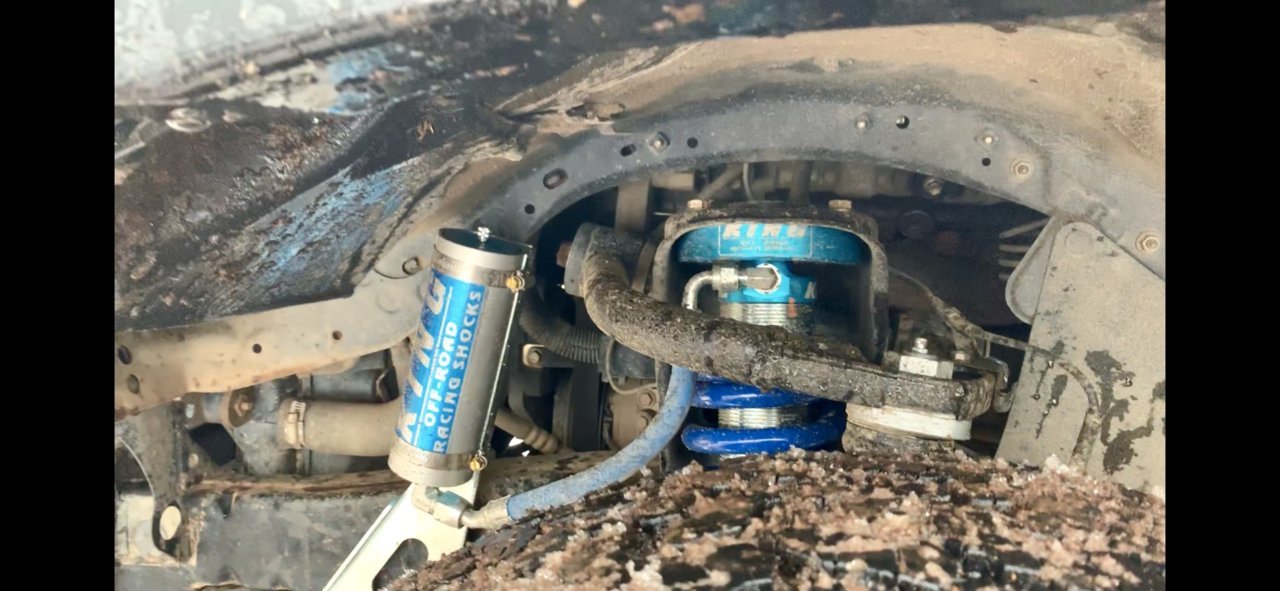

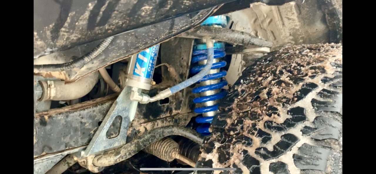

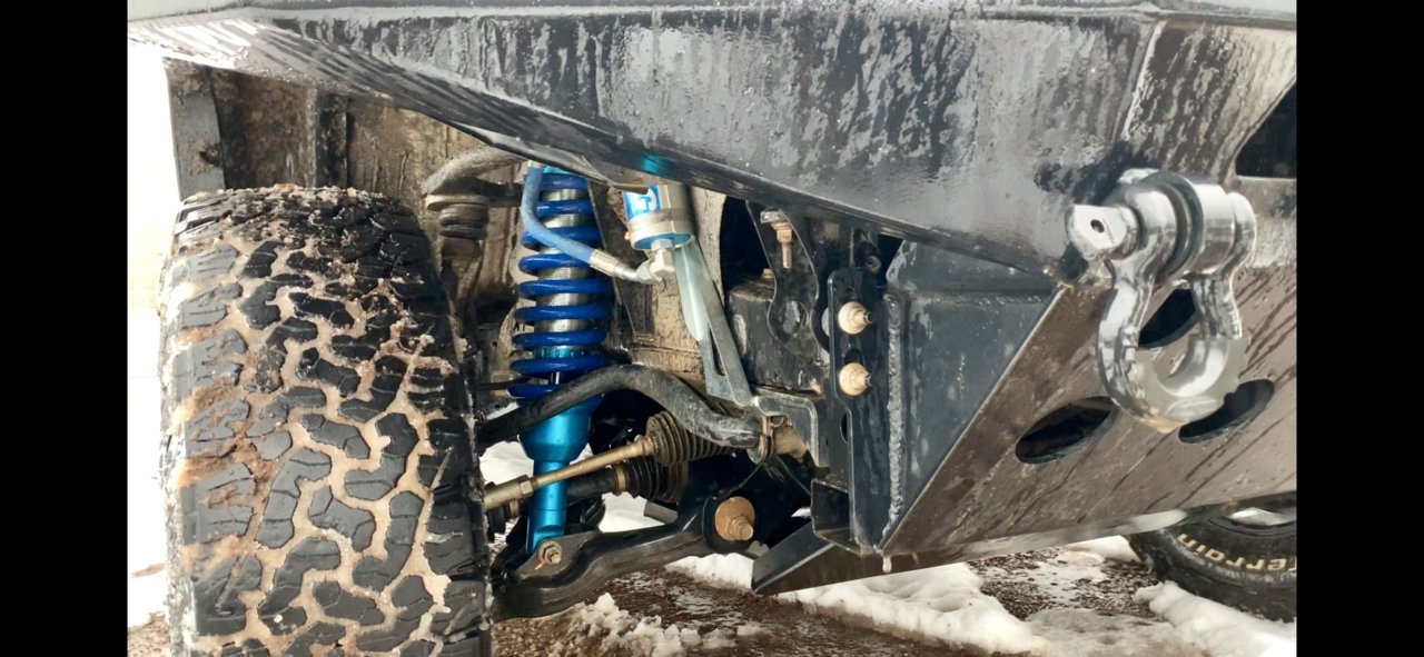

    I did notice a more responsive handling on the highway, cornering at 75 mph no problem. Up the mountain dirt road the King shocks mobbed the trail like nothing. I could feel the ride was smoother, the reservoirs do make a difference.

    King 2.5 OEM Performance Series Remote Reservoir Front Coilover

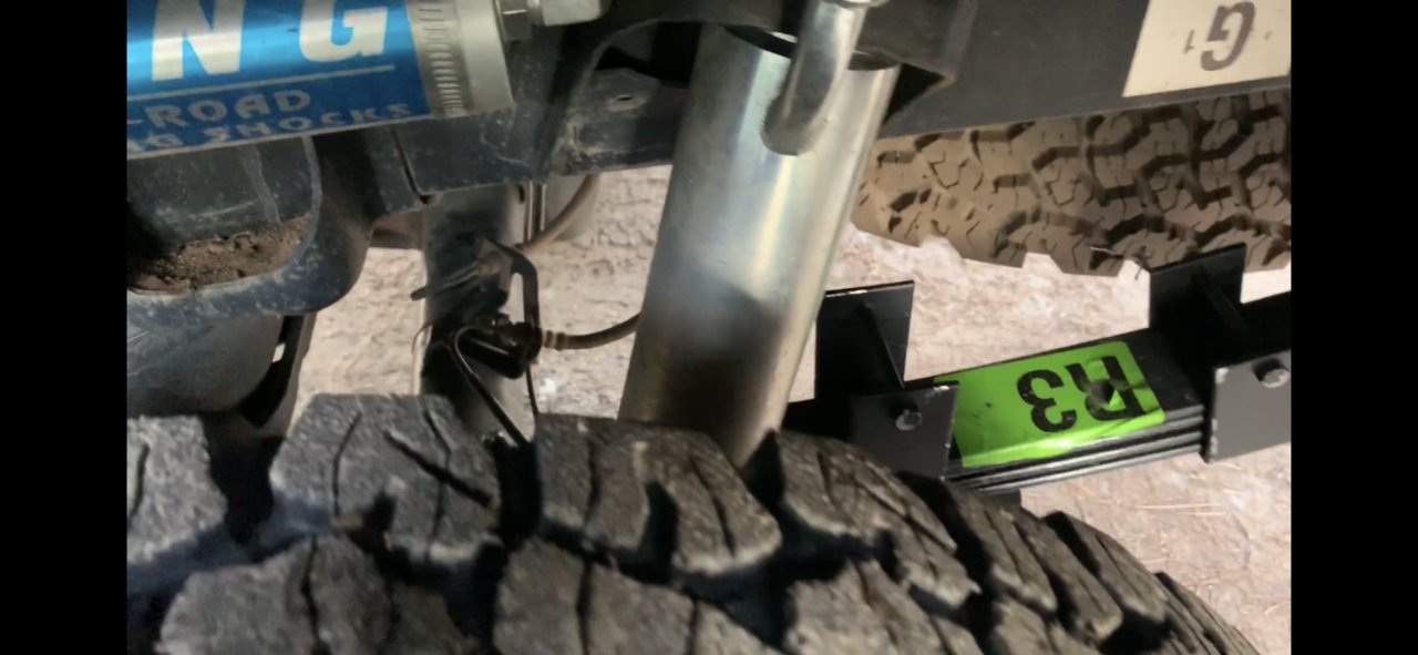

    King 2.5 OEM Performance Series Remote Reservoir Rear Shock

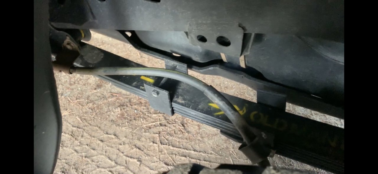

    To update the story, I had the King suspension on for a few days when I noticed that my traction control light came on and the steering wheel started pulling to the right. I pulled over and checked my suspension and found that the left rear U bolts were loose and missing a nut! The bump stop was gone, the springs were sagging and a leaf spring shim was sitting on one of the leaf. I suspected that the Toytec AAL broke and that's how the U bolts came loose. Damn. I should have just replaced the rear leaf springs when I got the King shocks installed... Luckily the King shocks were not the problem! (Sorry for no broken leaf pics. I was not in the mood to take sad pictures.)
    For some good fortune I found the missing bump stop on the road home! I limped back and retightened the 3 nuts on the U bolts. Went back to DC Customs to fix the broken AAL and order a set OME Dakar leaf springs EL095R and bushing set. DC took off the leaf springs and found out what I had suspected. Both of the Toytec AALs were broken. They replaced both of my leaf springs with a donor set and reinstalled my bump stop. I ordered the OME Dakar leaf spring set, OME bushing set and new U bolts then waited a few days.
    Came back to DC Customs and installed my new OME Dakar leaf springs. Since I have an open bed and don't haul too much weight in the back, they removed the 3rd leaf down for the best ride quality while maintaining ride height. I only carry gas cans, propane tanks and the occasional load of wood.
    "If you plan on carrying an extra 330 lbs you can leave leaf 3 in the pack for better load stability while maintaining ride height." (Quoted from Wheelers Off-Road website.)
    Finally the suspension was fixed (again) with new leaf springs, bushings, U bolts and an alignment. The alignment was very important because the toe was off from the AAL breaking and causing a ride height shift. The ride feels great and I love the stance. The OME Dakar leaf springs feel stout and handle the bumps well. No more stock leaf springs with a weak ass AAL. Do it right the first or second time.

    OME Dakar Leaf Spring EL095R
