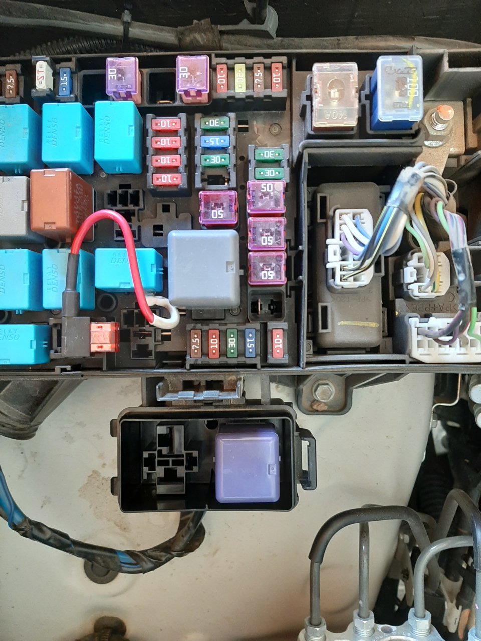

    You could use the ignition leg of the inverter relay if you have one, that's what I used to do the fog anytime mod on mine.20210107_204614.jpg

    DM93, Yes...I have one and THAT's a good idea. I did the Anytime fog mod too by tapping the ECI inside the main box. I'm not sure if that was a good idea or not due to how critical that circuit is.

    If you mean EFI fuse I would move it to something else, the EFI circuit will power up when the truck is off to run the EVAP leak test so if you accidentally leave your fogs on it could potentially kill your battery.
    Walldiver7[OP] likes this.

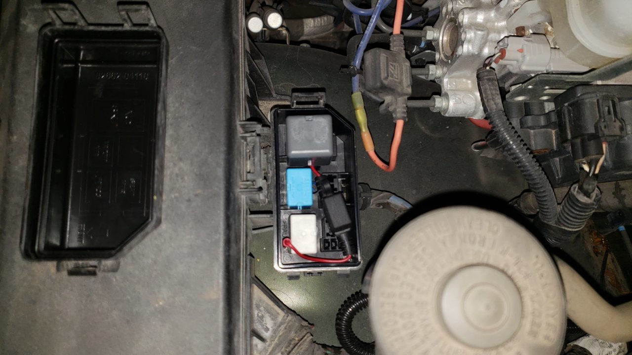

    Good to know.... Thanks. My side circuit box is a little different from yours. Is this the inverter relay?

    It's labeled AC Skt on mine
