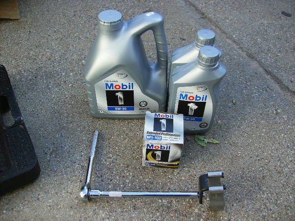

    After spending too much time here reading about oil and all kinds of other fun stuff, decided to change to Mobil 1 (28,000 miles).
    Still had my oil filter strap from my old S-10, worked great with an extension on the 4 banger. :) 14mm socket on the drain plug, set the torque wrench at 30ft-lbs for the reinstall. Mostly just because I wanted to try it out, just bought it today. Crazy cheap at Harbor Freight. Lot's of good tech info stored on this site. I've about given up on the Haynes Manual showing up from Amazon. :rolleyes:
    I think I saw this on a post from Chris4x4, great tip!

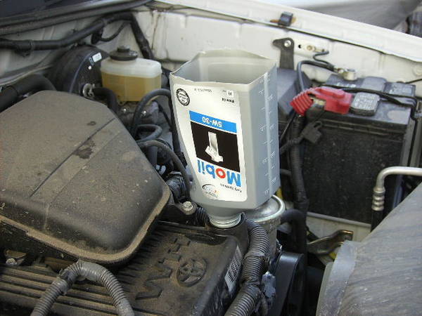

    5 quarts filled it to halfway between the marks on the dipstick. I'll check it again after driving to work (10 miles) to see if I need to add.
    Next up will be the 30k services - front and rear diff, transfer case, and transmission. :)

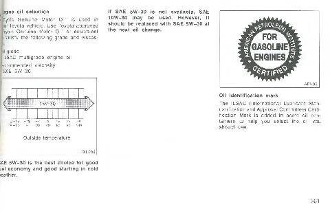

    Here's page 361 in the 2006 Tacoma Owner's Manual:
    Was this chnaged after '06? I'm sticking with 5w30...

    My 07 says 0W-20 or 5W-20. What does your oil cap say?

    5w-30. Looks like it changed in '07. Interesting.
