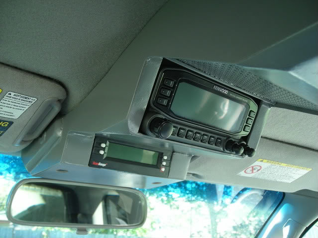

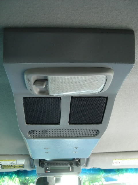

    I remember seeing a build thread where someone installed a CB speaker in the overhead. You'd probably want to drop the headliner down to see how much space you've got. In some spots there's probably room but in others you'll run into roof reinforcements. The other option would be to build a small console. You could do something like below, except only the forward part, and add switches:
    It was attached up forward with two screws to the rear view mirror mount. The back end used the stock screw holes for the dome light. Worked great til some d'bag broke into my truck and destroyed it stealing the radio.

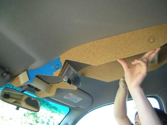

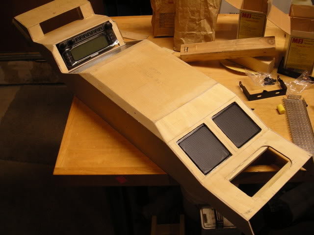

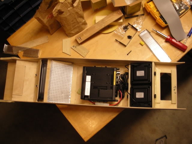

    Yeah. I used 1/8" hobby plywood with fiberglass reinforcement on the inside seams. It held the HAM radio body and head unit along with the speakers and scangauge. I eventually mounted the dual battery controller to the side. I had plans for finishing it more but had a lot of other projects on the table. Then the truck got broken into and I just haven't had the time to make another.
    I started off making the template pieces with cardboard, then transferred the lines to hardboard. Did a few mock-ups and tweaks before putting it all together:
    The whole console was higher than the rear view mirror, so visibility wasn't affected at all. You just had to be careful getting in and out of the truck if it was parked on a side-slope
    I ran across the templates a couple of weeks ago. Maybe I'll make a V2.0 someday.
