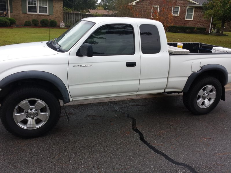

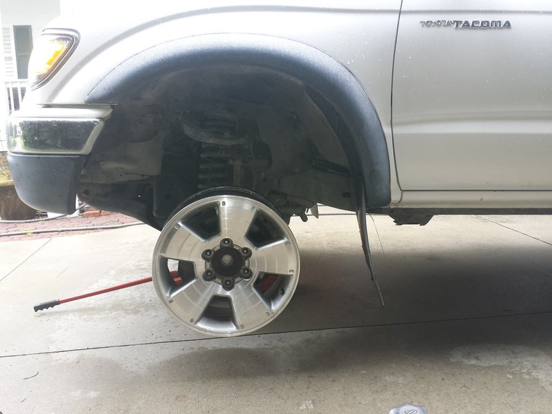

    The first picture is the new rims and the third is the original rims, very little difference if any. No spacers are on either pictures. You can see the new rim is'nt fully seated by the dirt markings :p Thanks for any input guys...I probably should of bought 265/65/R17's instead...to help some :s

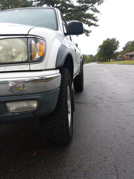

    Forgot to update on the tires and rims. Got them on and they look amazing spacers were perfect. Though it took over 3 weeks to get them made and delivered. Tires are nice and smooth riding not much road noise.

    looking good

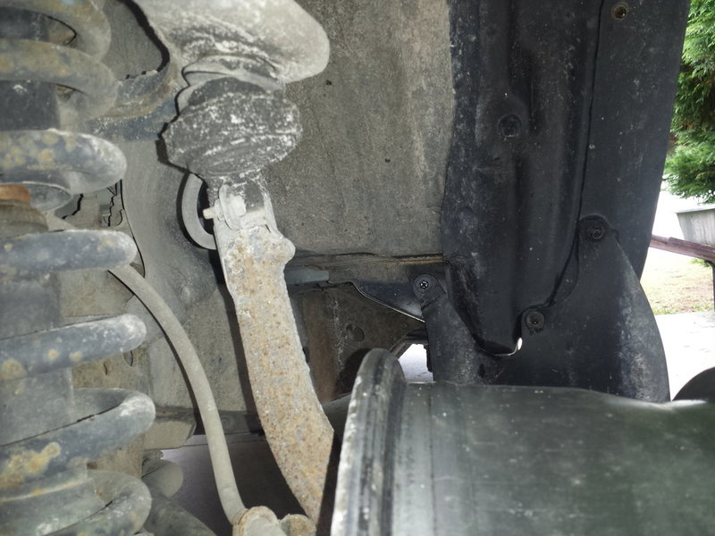

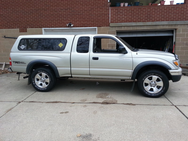

    btw here they are without spacers

    Nice clean looking Toyota! Those are 65's or 70's? They look like 65's
  10. Nov 2, 2015 at 7:06 PM
    frizzman
    frizzman Well-Known Member
    Sep 25, 2013
    #113212
    5,349
    Pittsburgh, PA
    04 XCab 4x4 TRD/OR
    OME 2.5,Tundra 17s,Falken Wildpeak AT3W hitch w/ 7-pin, ARE cap, JVC HU w/BT, HID/LED lights
    ya they were 265/65. the width wouldn't change so rubbing wouldn't be a concern if I had kept them and went to 265/70.

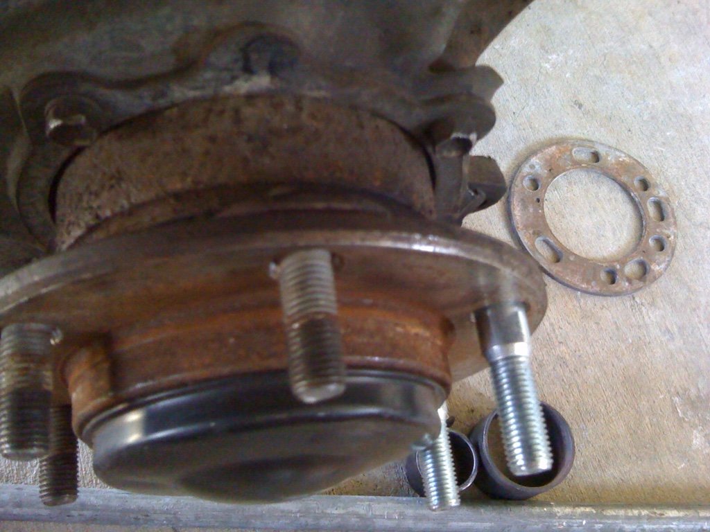

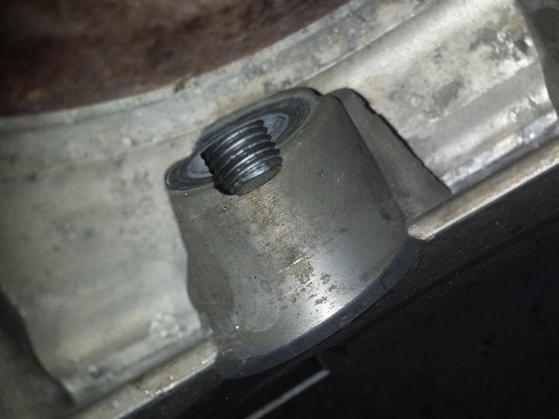

    I run some steelies and that 1/4" spacer laying there. No balance issues at all. The length is needed to get more than 3 threads on the nuts.
