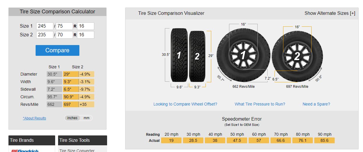

    Thanks Everyone for your input. I decided to go with 235/70 16 (Falken Wildpeaks). Less than a 10% change. Beyond the speedo being off a bit, the RPMs are up a little bit, most notably on the highway at +75 mph. Around town the RPM difference is negligible. Also the ride seems a lil rougher but the roads are in bad shape around here at the moment (I'll have to report back on this after a long road trip). On the positive side I do notice an increase in acceleration and better performance on the hills.
