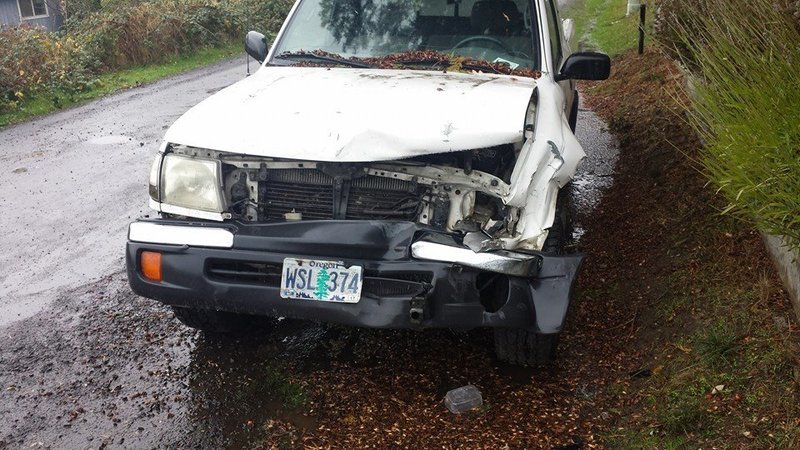

    What's up with the truck in the photo?
    Looks like it needs more than just synthetic oil.

    Hahaha I thought the same thing.
    Priorities I guess.

    Hahaha its all patched up now. Starting to change to fluids in the old lady.
