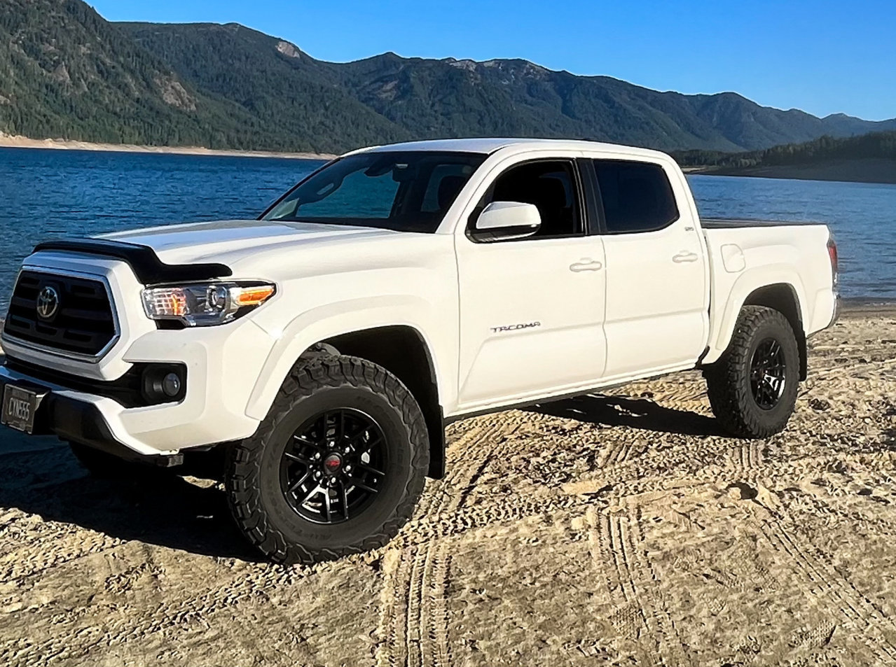

    Just switched over to E load KO2 in 265 75 16 from SL rated Toyo AT3 in the same size.
    I just finished a 1200 mile road-trip and here’s what I’ve found with E load KO2’s
    1) gas mileage from Missoula, Mt to Roslyn, Wa (403 miles) was 19.4mpg driving between 70 - 80mph, over two mountain passes. Coming home it was 19.2mpg. Less than 1mpg lost from the Toyos.
    2) The tires on the interstate we’re extremely quiet and roll smooth. Quieter than the Toyos. I’m at the recommended 37psi cold per BF Goodrich and warm was 41psi.
    3) you will feel the road more due to the stiffness of the tire. Cracks and other asphalt abnormalities will be felt more but it’s not overly jarring.
    4) I do feel the weight of the tire more with acceleration and breaking but I’m not a lead foot so it doesn’t bother me at all.
    5) the KO2 handles very well on the road overall. Doesn’t wander, tracks straight and rolls very smooth. A good balancing is critical in these heavier tires and don’t be surprised if you see that they take more weight to fully balance.
    6) on gravel and rocky forest service roads you’ll want to air down if you’re travel any long distances just to soften the ride. If you’re only going a few miles, just stay at the same psi and you’re good.
    I went with the E load KO2’s for two reasons:
    1) only E load was available in the size I needed and I didn’t want to change wheel size to go to a C load. I’ve always wanted to run the KO2 so I went with E load.
    2) we spend a fair amount of time traveling on gravel and rocky forest service roads and are usually wandering around some Montana backroad for an adventure and I’d prefer to not get a flat miles from anywhere. I had to repair my Toyo’s several times for very minor punctures and I’d lost confidence in the tire.
    The ultimate test was asking my wife on the road trip as we were on some very rough asphalt on the old highway between Ellensburg and Cle Elum if she thought the truck rode too stiff with the new tires. She said she didn’t even think about it and it rode fine to her.
    So, it’s really up to you and what your needs are. You’ll get a million different answers on this one…none are 100% right and none are 100% wrong.
