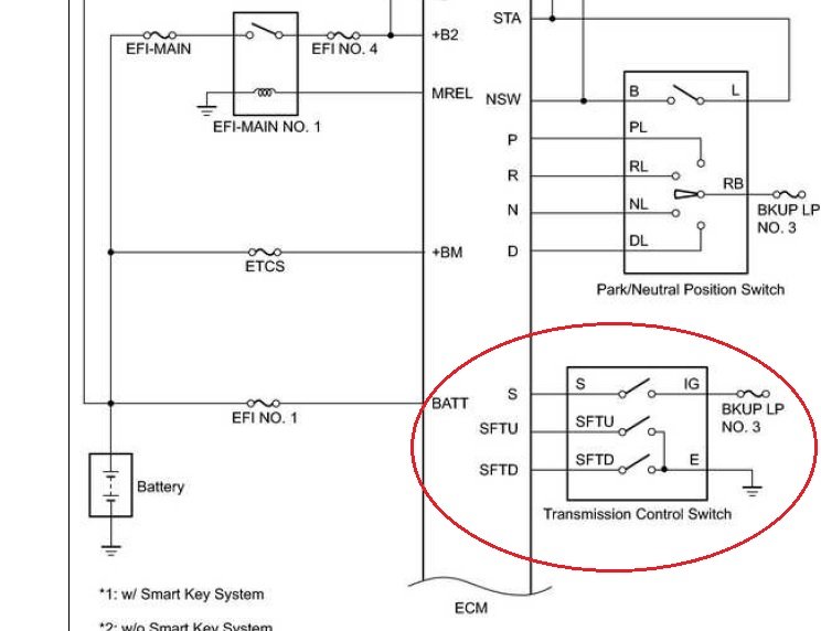

    I’m not sure if I’m reading it right but, do you think it’d be as easy as swapping the STFU and STFD?
  7. Jul 28, 2020 at 11:43 AM
    SmileyGuy
    SmileyGuy Well-Known Member
    Nov 21, 2019
    #311305
    499
    Darrin
    Nova Scotia
    20 Tacoma Off Road Voodoo Blue DC SB TRD Premium CAN
    Yes a ground is applied to those inputs when shifting.

    I have been considering this for a while. I want the shifts to go with momentum.
    Thank you for the diagram, I must say I'm not sure where the physical wires are located, what color they my be, and even how to properly interpret the diagram. I'm guessing its on the trans control switch?
    If this turns out to be an easy mod it could be one of those amazing mods that everyone will do. I hope it works out as it will make the Taco much more fun to drive.
    I'm still in the research phase. Again thanks for the diagram.

    Swap the green and red wire at the connector

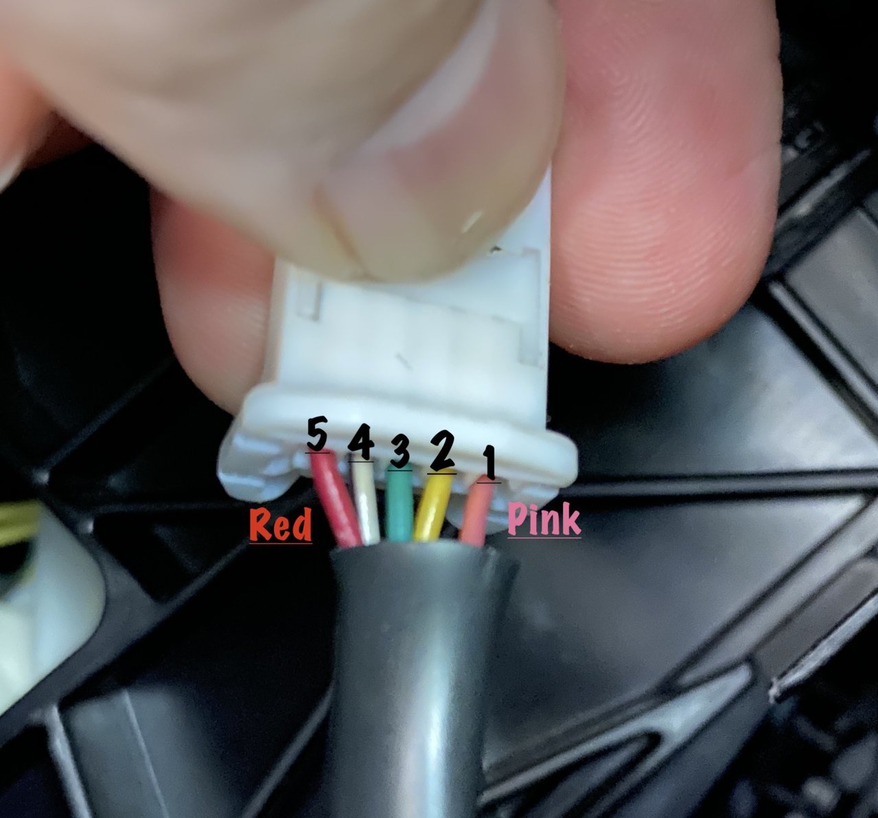

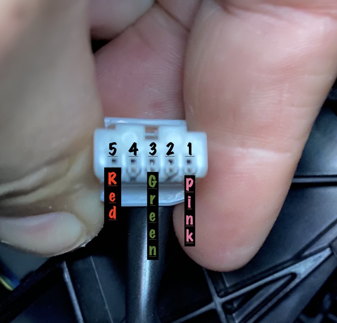

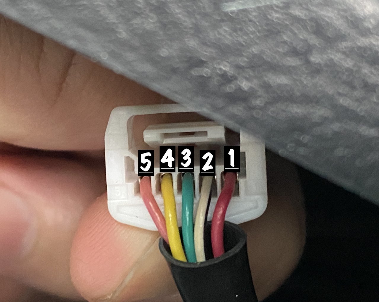

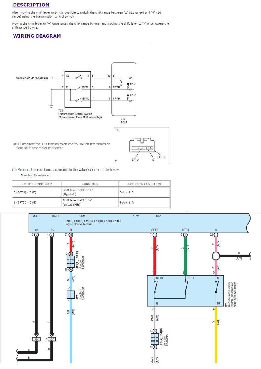

    I had a little time today to do some digging/ testing. I found the T23 control switch, but I believe I found a small issue.
    If I am reading the diagram correctly as I am looking at the connector it should be 1 through 5 from right to left just like in the diagram.
    Unless I'm looking at this wrong my 1 and 5 colors are in the opposite spot. Pink in 1, Red in 5.
    Let me know if I'm wrong. pics
    As shown in the diagram, with my wiring colors listed.
    Or should I be looking at the switch in this direction from the back with the wires coming in. wiring3.jpg
    jkish17[OP] likes this.

    I'm betting it's like your last pic.
    You can alway do a resistance test against 2-white from the shifter to find "up" and "down"
    2-white to 3-green should be "up"
    2-white to 1-red should be "down"
    SmileyGuy and davidstacoma like this.

    Last picture is correct 2 is E (ground wire) which is the white with black stripe wire. Now tell me where you guys get these color wiring diagrams, the ones I see in the 2016 service manual pdf I have are black and white.
