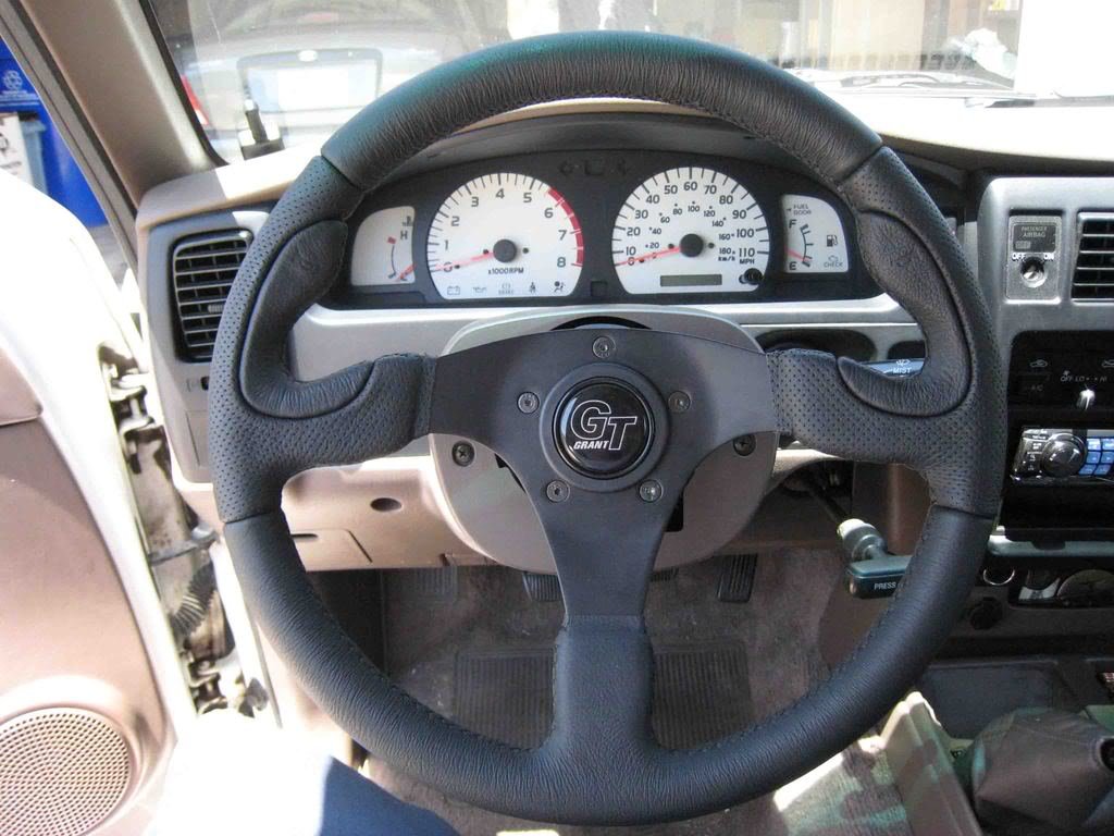

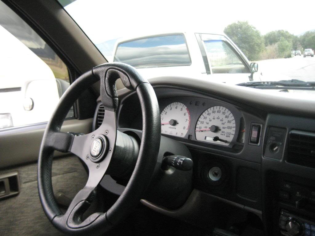

    I had a 98 base model with a 01-04 white face cluster with tach .. they were both from 4cyl 5 speed. thats the only catch.

    15 minutes, You have to take the dash apart under the wheel and the area surrounding the wheel.
    Philips screwdriver and I think a 10mm socket.
    Plug and play on the back of the cluster.. 3 wired connections.
    Do an led swap on the bulbs before you swap the cluster though.
    I did red and it looks amazing!
    the orange was boring..
