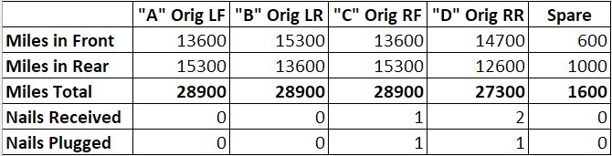

    Bought 5 new Falken WILDPEAK A/T3W 265/70 R16 tires in May of 2022. I've tracked them as "A" through "D" in the order LF, LR, RF, RR at the time of initial install. Usage has been as follows:
    Discount Tire has done the two previous plugs shown for C and D. Tire D recently got another nail but this one is too close to the sidewall to be plugged, but like the other nails it has luckily been in the tread block and not the tread void. It's either leaking extremely slowly enough for me to not even have noticed yet, or potentially not leaking at all?
    I have the full size spare tire which has never had a nail that I would like to permanently swap with tire D. Quetion: Given the Spare has 25.7k mi less wear than tire D - are there any issues swapping and keeping it in normal use to make tire D the new Spare? Not sure if having 1 of the 4 tires with significantly less wear than the other 3 would cause other issues. Thoughts?

    It’ll wear quicker than the others and eventually catch up, which isn’t ideal but will work. You’ll have to keep a closer eye on it so you don’t get one-sided wear. The open diff sight different sized tires left/right basically acts as if that tire is turning all the time.
    Check out the link in my signature about mismatched spares. Has more info along the same lines

    Ended up rotating as normal and not using the spare. I couldn't even find the nail in "tire D" even after slowly looking over it 4 times in a row, so maybe the 2nd nail wasn't a full nail or already fell out? Tire pressures remain stable regardless.
