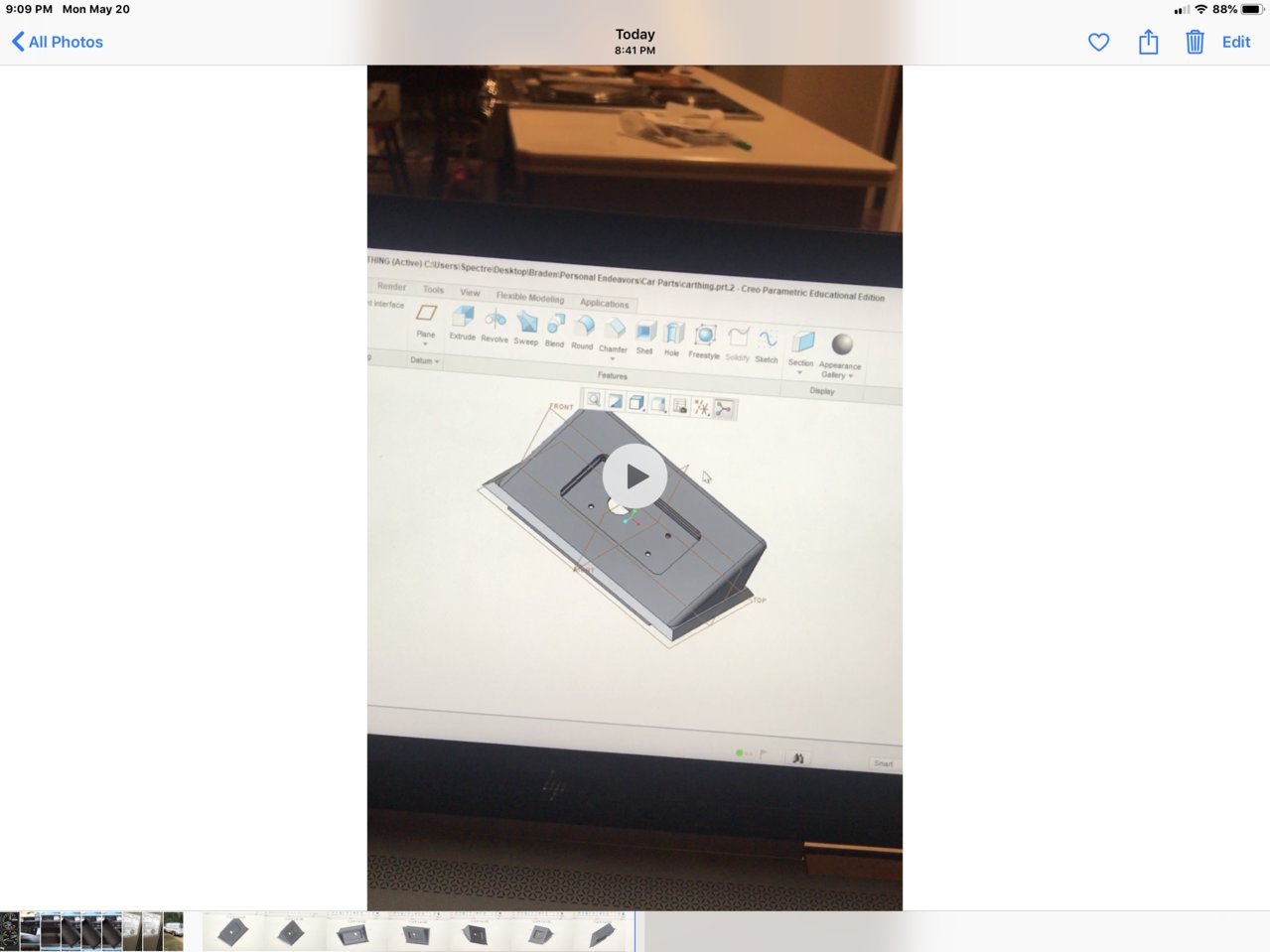

    i have searched for a overhead mount to fit a 3rd generation Tacoma to fit a SwitchPro SP-9100 switch panel and at the current time no one offers it. So I have a friend designing one to take the place of the sunglasses holder. Here’s the initial rendering he sent and the only mistake I can see is that the large hole for the wiring pigtail is on the wrong end of the mount.
    If there is any interest I will be providing a free STL file once completedF89D489E-141F-444C-844A-EDF2AA59900C.jpg to be used with your 3D printer of choice. A initial print will be coming shortly.

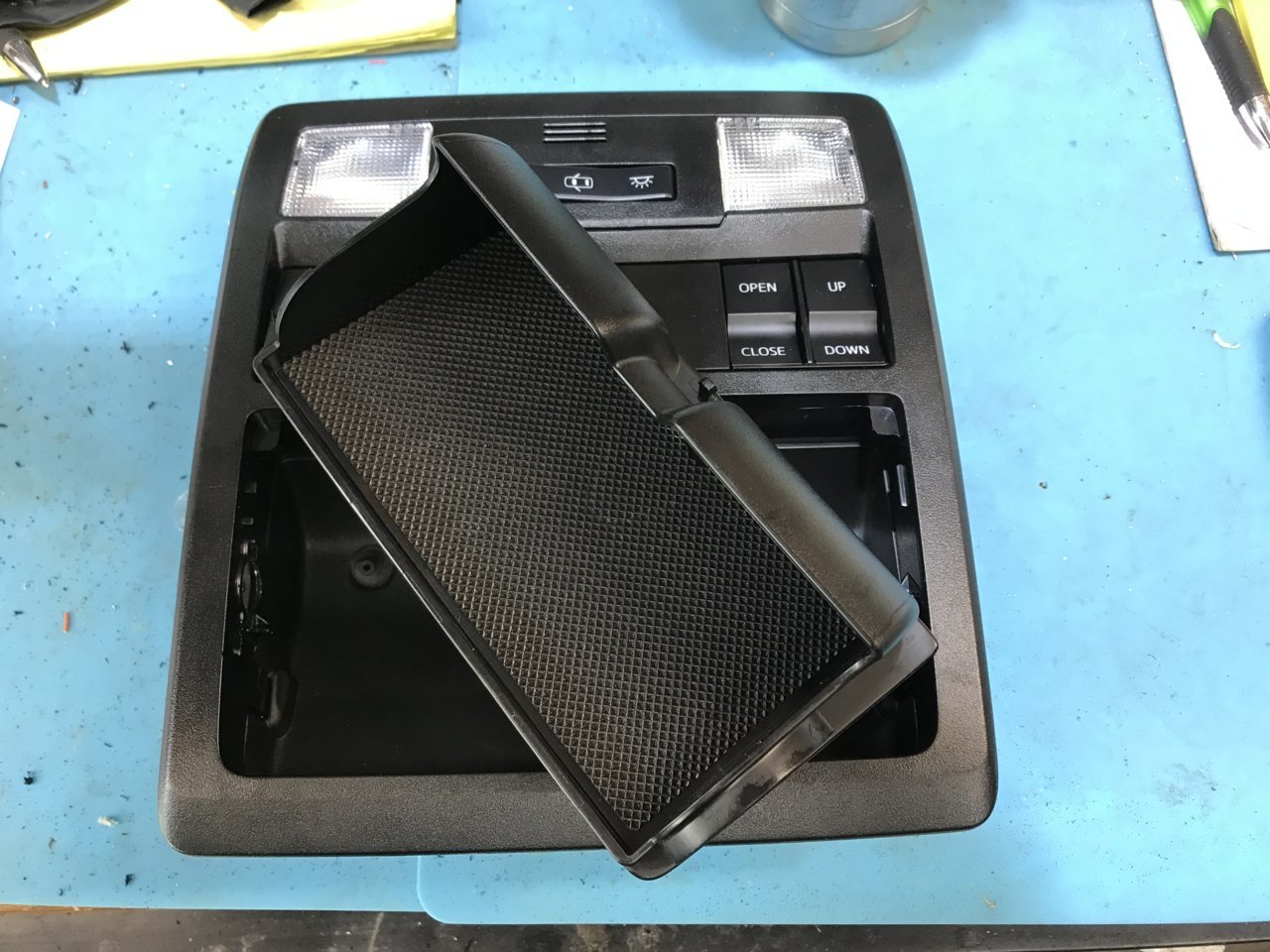

    Began by my removing the sunglasses holder

    Man I hate Creo, hopefully you don't have to use it every day.

    I’m going to assume Creo is some form of CAD program. I can do a lot of things but CAD isn’t one, and that’s where my buddy comes in thankfully. All I did was hand him my overhead console, switch panel, gave him a couple of suggestions and turned him loose.

    Ah gotcha hah, yeah Creo is the CAD software shown in your picture. Your buddy's a good resource, buy him lots of beer :cheers:

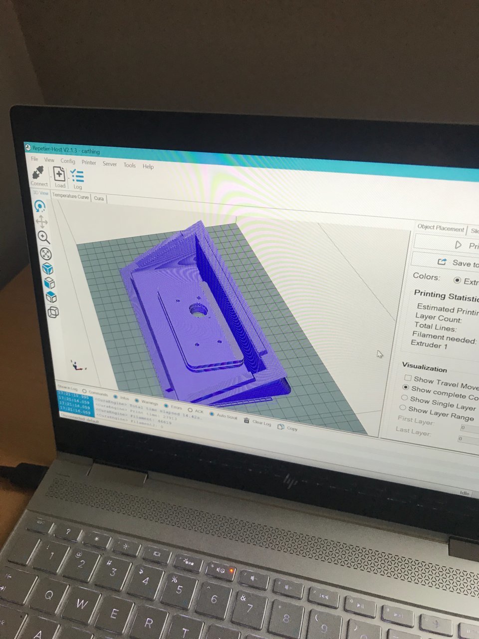

    I figured a lip for a bead of silicone since there is no real weight involved. This is the printing position for the test print to minimize supports.

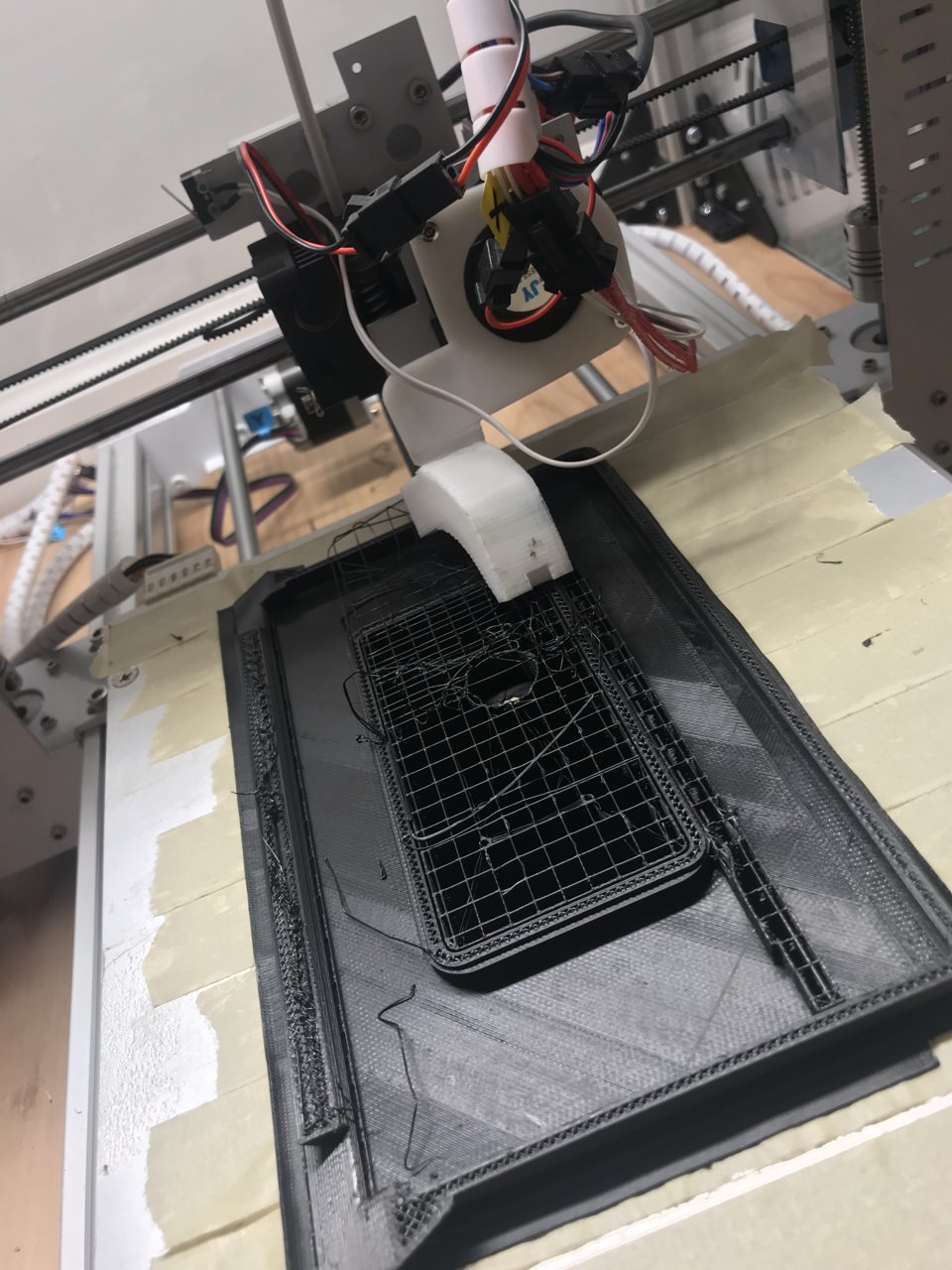

    Ran a test print for fit and all was going well until the printer fan took a dump. Murphey’s Law applies

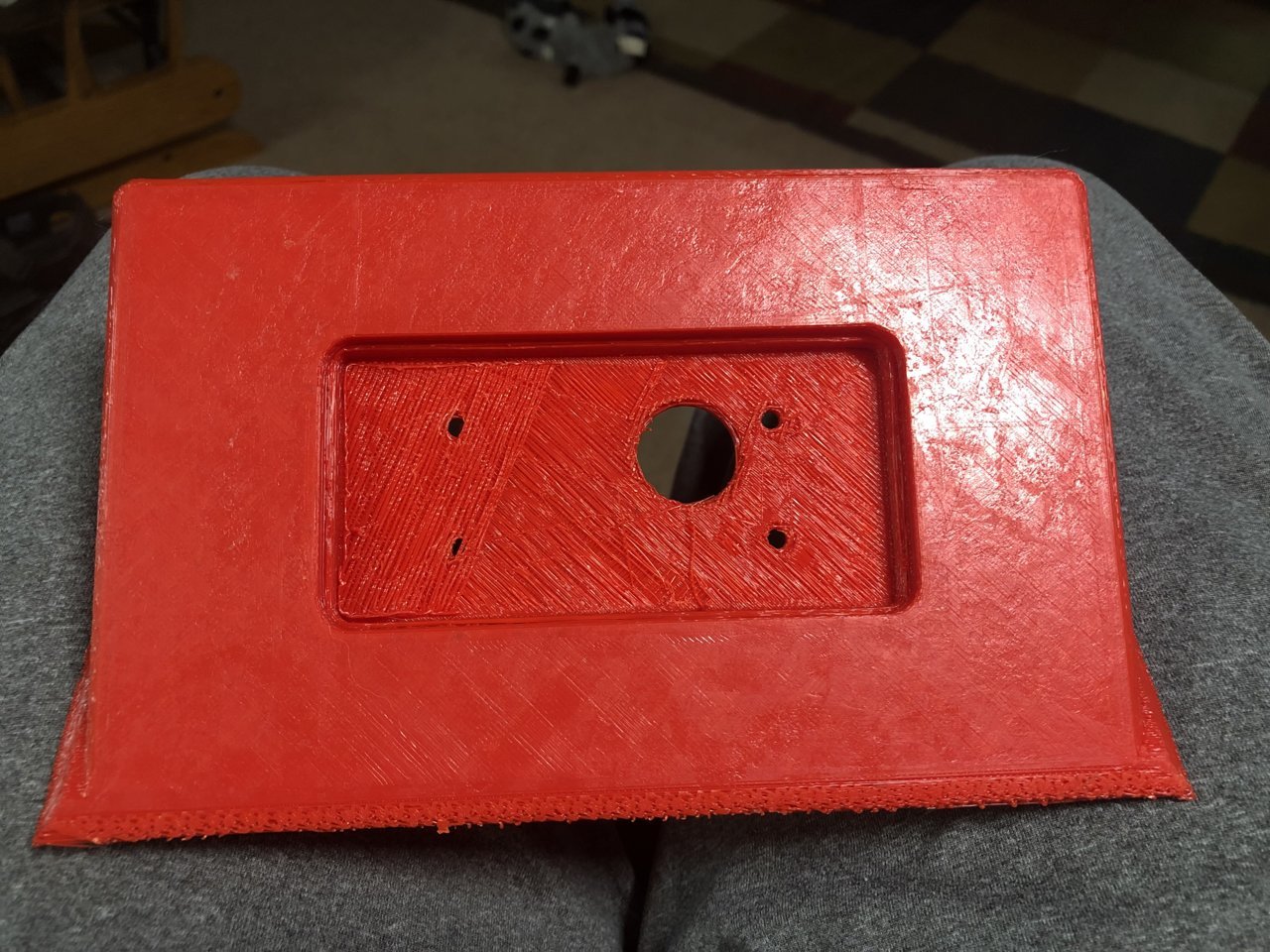

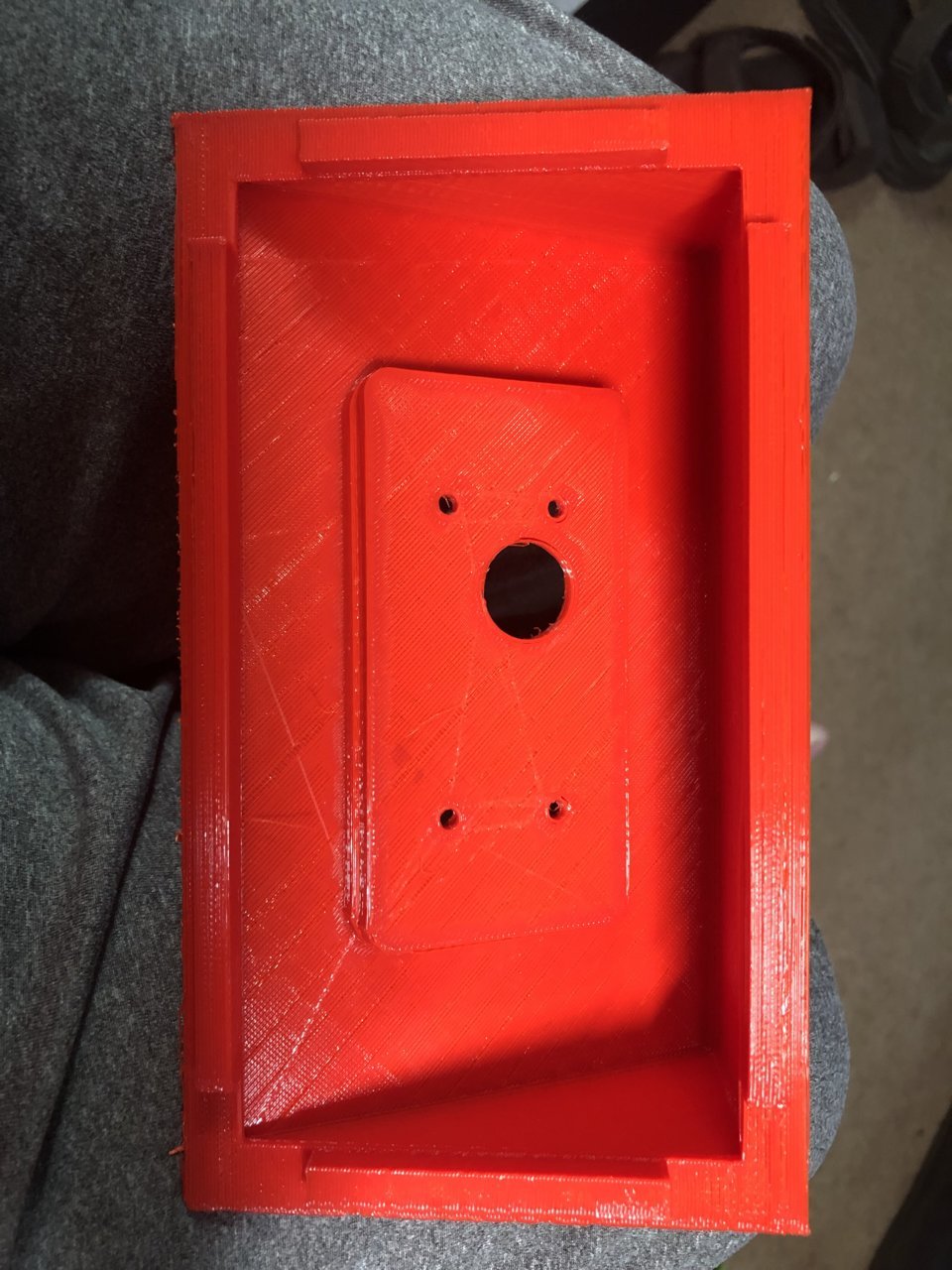

    488112A7-7441-411C-8DEE-B79F8E8BACFC.jpg BB08EA14-9D06-448B-B379-F922332C9FB0.jpg This was the first full print done in coarse, PLA, for a size check. I’m going to take a good look at this tomorrow in the overhead console as I’m thinking the viewing angle of the panel needs to be steeper. I know, I know but I used red because that’s what I had most of and it shows blemishes better.

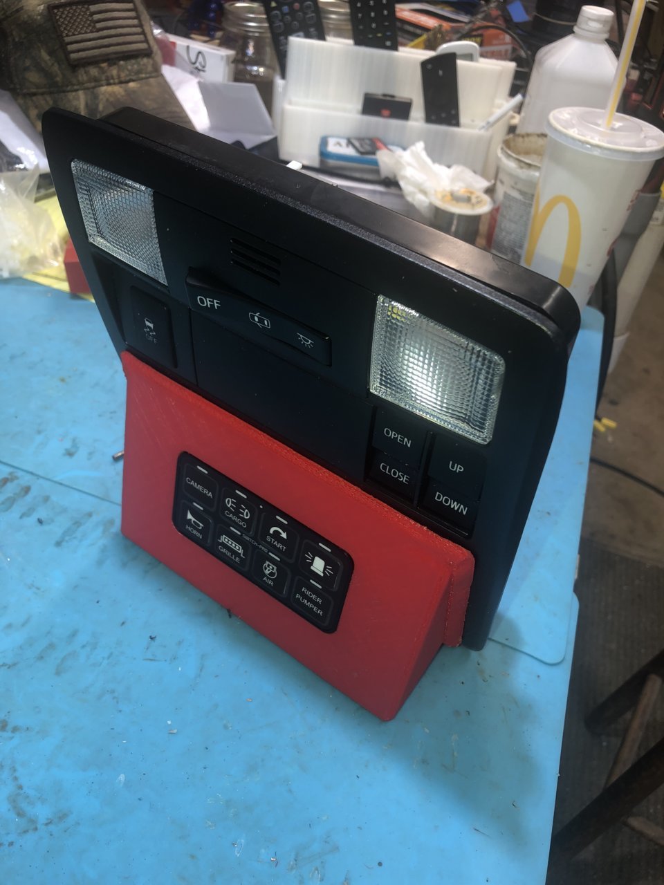

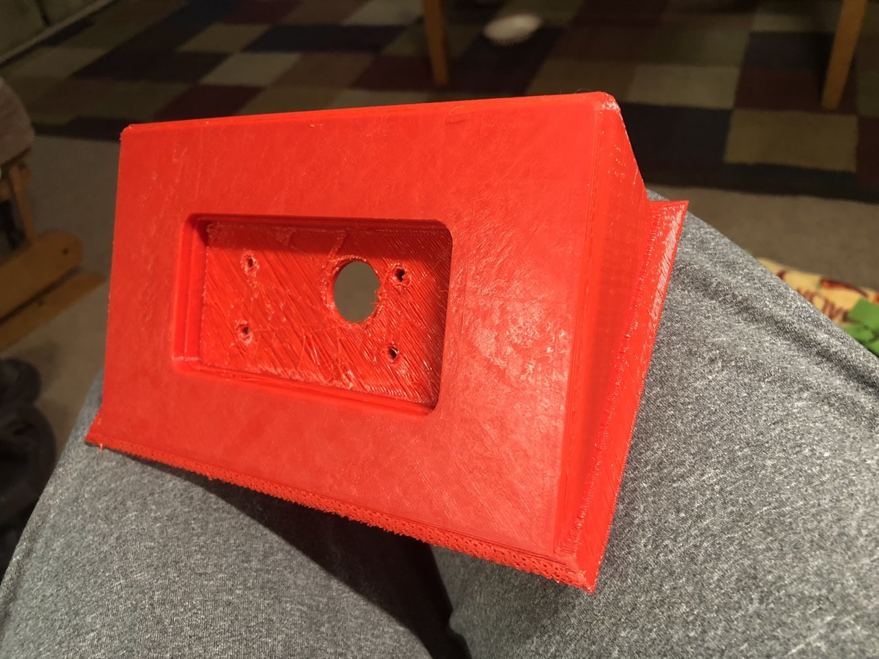

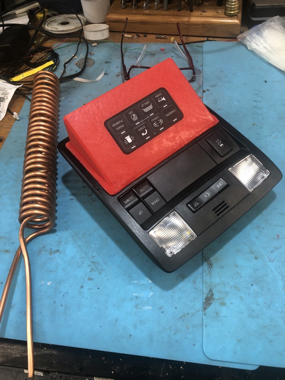

    This test print is not mounted but I wanted to snap it together to check the fit. I’m satisfied with the fact that the switch panel face will end up flush but the angle of the panel doesn’t suit me at all once placed overhead. So we are going to make the 2nd print much steeper to see how it compares.
