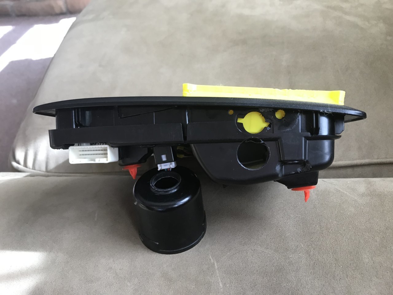

  11. May 24, 2019 at 6:06 PM
    #31
    HiProofProducts
    HiProofProducts [OP] Well-Known Member
    Mar 28, 2019
    #288305
    207
    NE Ohio
    2017 Tacoma TRD Sport

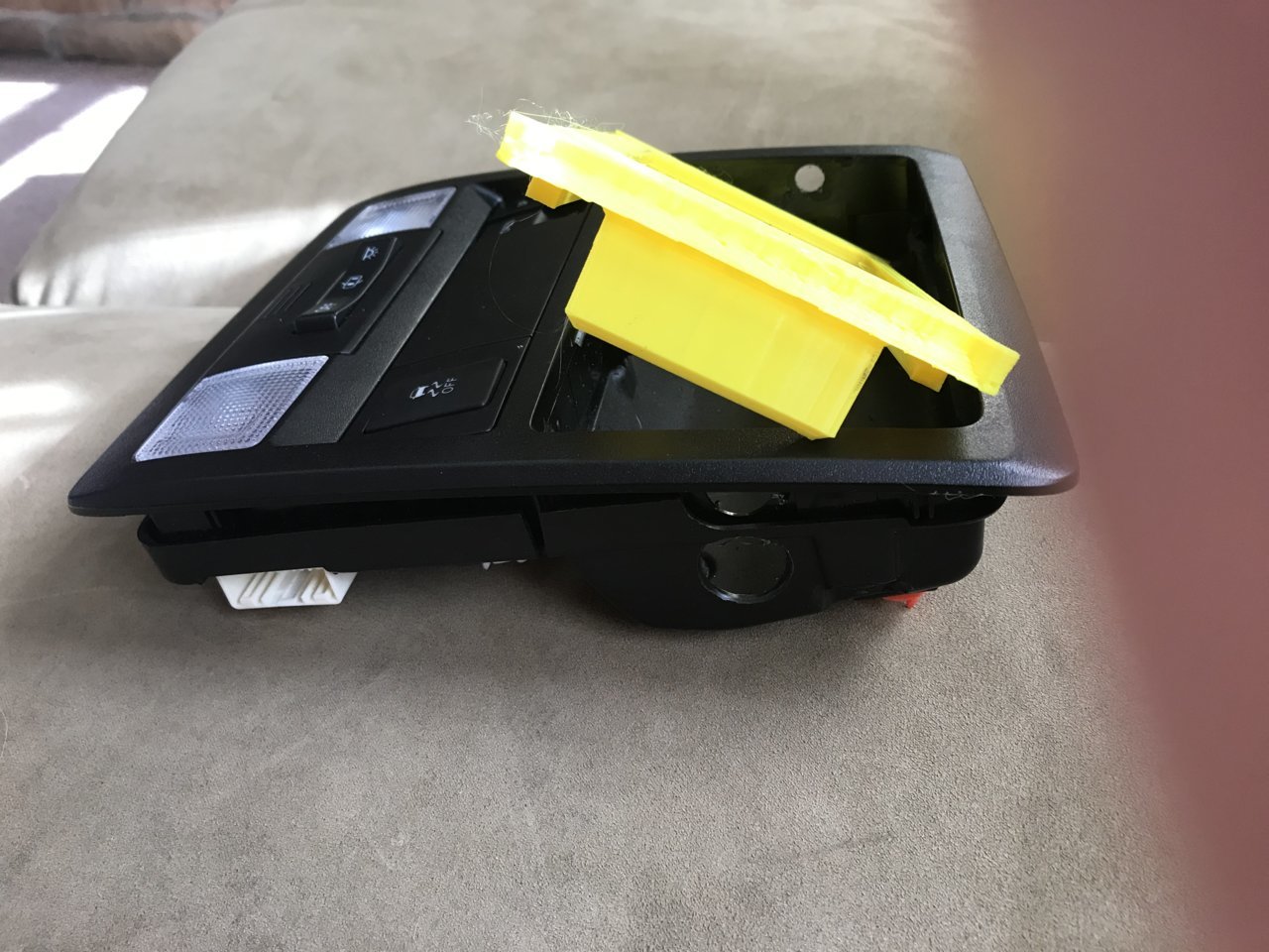

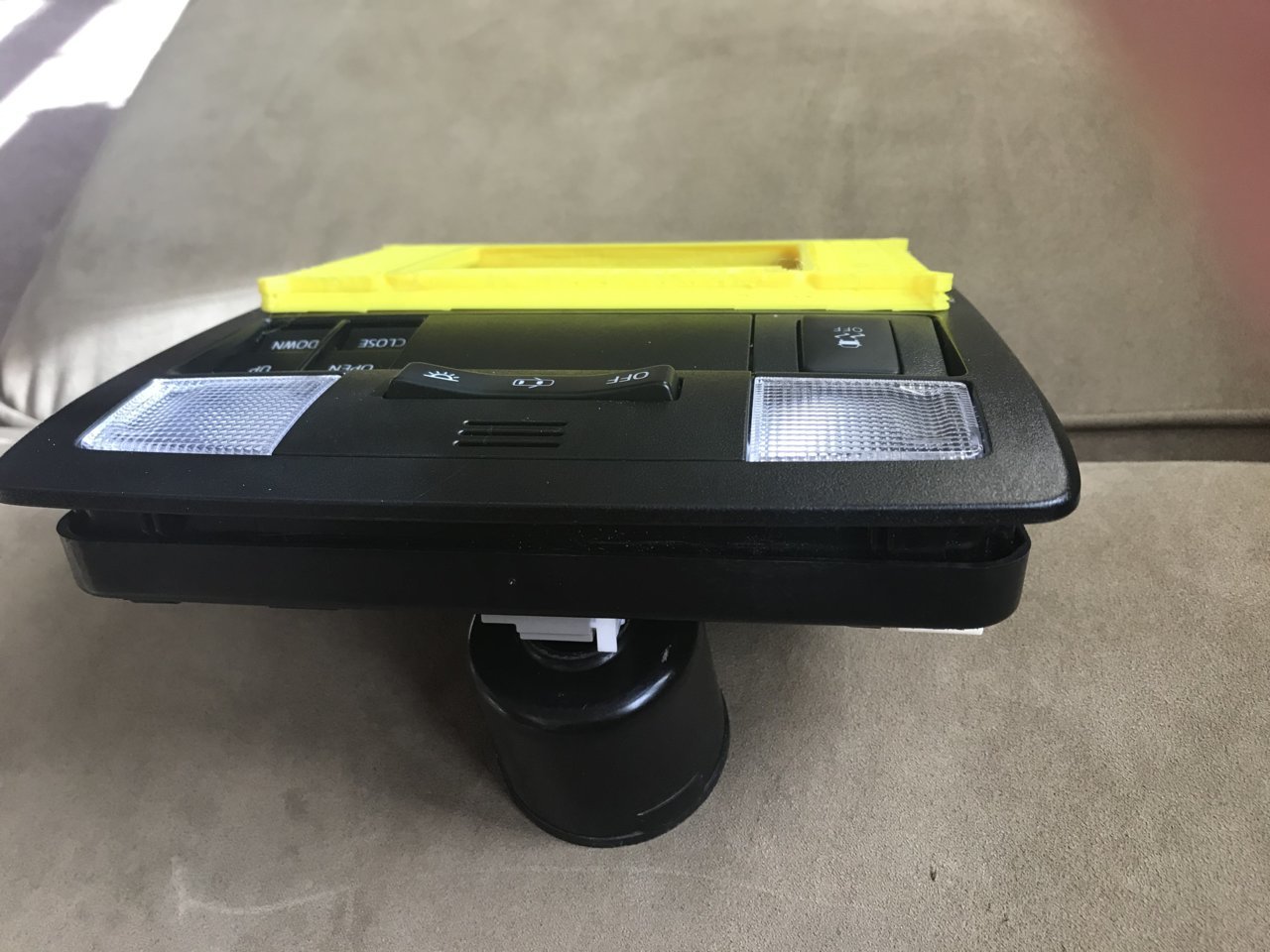

    Made the viewing angle steeper and narrowed the enclosure.

  12. May 30, 2019 at 2:03 PM
    #32
    HiProofProducts
    Mar 28, 2019
    #288305
    207
    NE Ohio

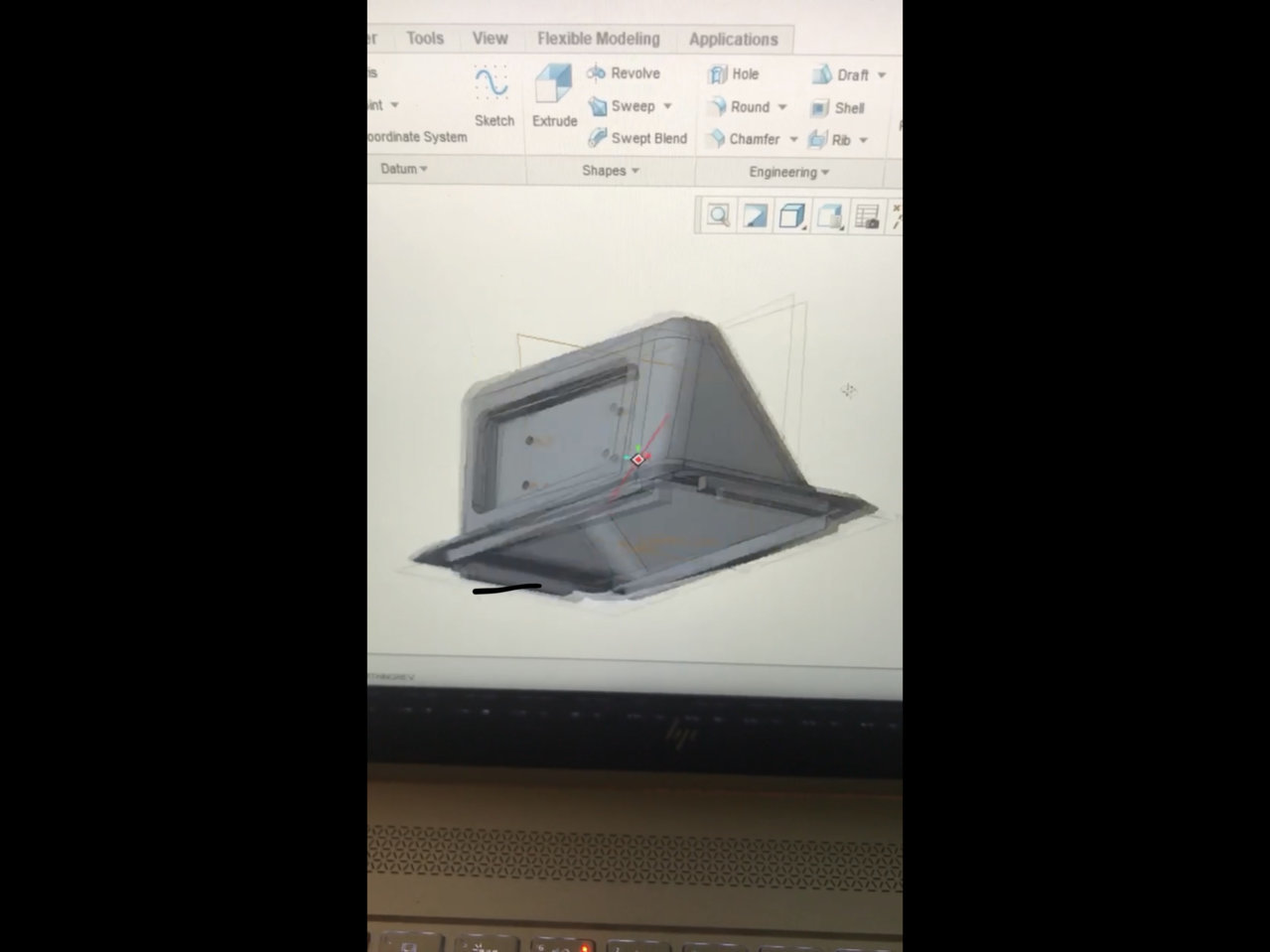

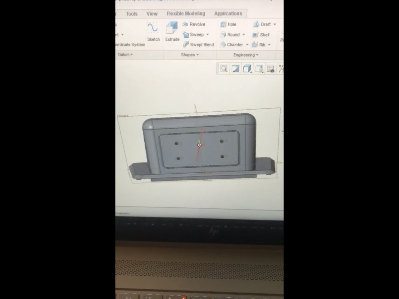

    This is the final design and we made the angle of the panel steeper so it would be easy to read. We also made the enclosure as shallow as possible so as to block the rear view mirror as little as necessary. Printed a test print in PLA and the fit was good. We are now printing in ABS and if all is still good the STL will be posted at Thingiverse. Once that has been done I’ll put the link here and if you want to print one for yourself that’s fine.

  15. Jun 21, 2019 at 6:05 AM
    #35
    HiProofProducts
    Mar 28, 2019
    #288305
    207
    NE Ohio

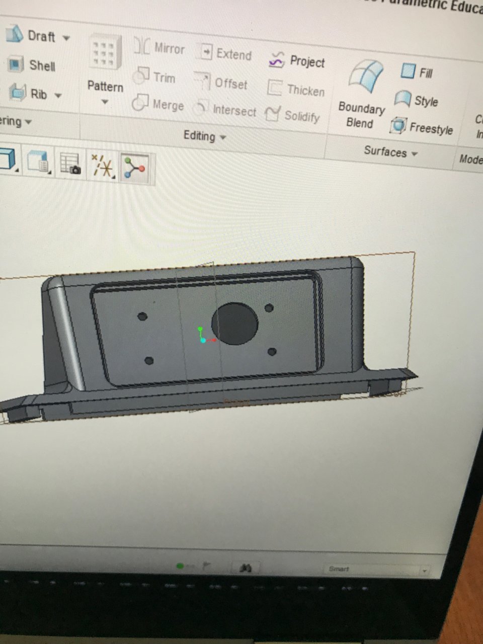

    E6E974FA-9330-41F7-83C0-923D302EFC2C.jpg 902D1D43-0FAE-4F19-990B-F99185BCB580.jpg 2FFD8A48-9AF8-4806-85E8-8701FAB1AEF6.jpg So we stuck with the idea and tweaked it further. Wasn’t happy with the way our print mated to the overhead console. The angles have now been changed to rectify that. The width of the mount itself was also narrowed to make it look cleaner. Lastly we increased the depth of the 2 bosses on the short ends of the print so the mount could be snapped into the overhead console and 2 hidden screws will hold it in place.
    I printed just the very bottom half so you can get an idea of what I have described. Next i’ll Print it fully in black ABS, get it mounted and take a few shots to post. Instructions will be included.
    This is NOT the file we posted to Thingiverse, it will be available soon.

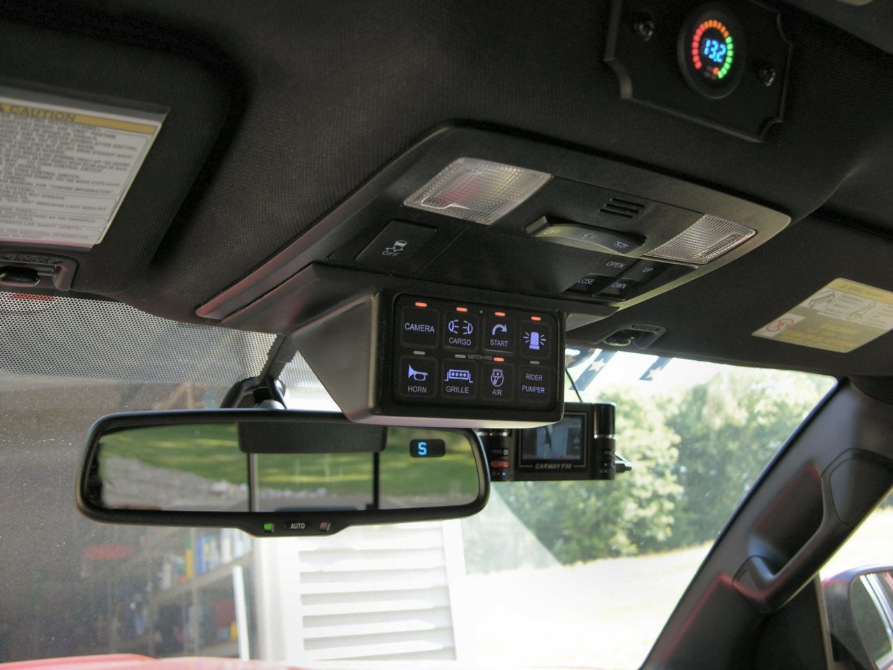

    Well after a bunch of tweaks here's the final design. I'm not crazy about Thingiverse so I'll be posting this at one of my websites shortly. then if you want to do your own thing you can download the file for your own printer. i printed mine in ABS on a Creality CR-10S
