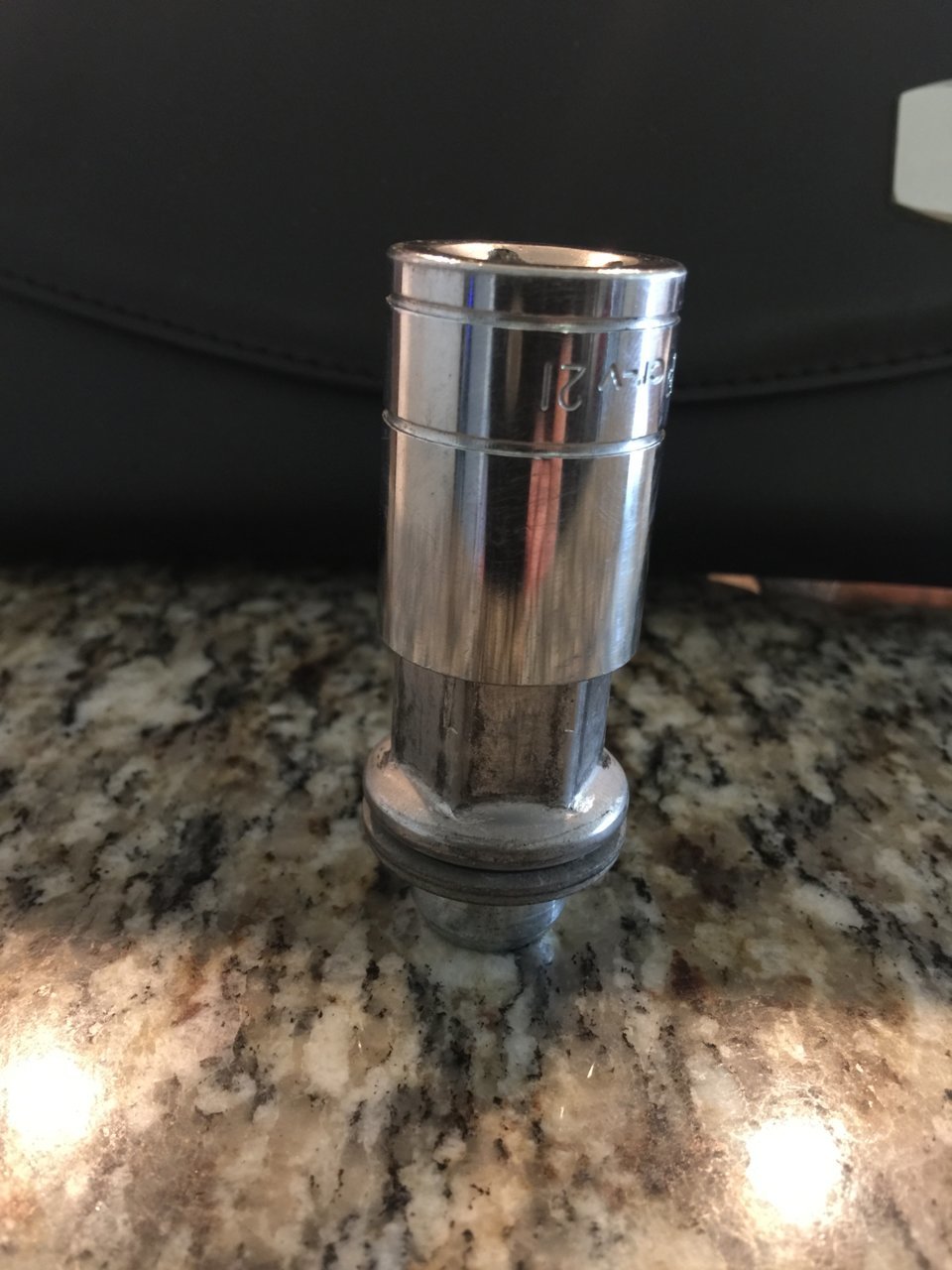

    Here is the swollen lug nut. 21mm stops at the tip. Visually it looks just like an unswollen lug nut. No sign of rust. My truck is pretty much rust free.

    Yep, too many air gun hits. You can probably use a hammer to tap the socket onto the lug fully, but it may be a PIA to remove. If that a 12 or 6 point socket? A six point may slide on easier. You can also remove the shell with a grinder, but you will have boring looking lugs. May be time for some new lugs.

    It’s a 12 point. Yep, I ordered a set of new 24 lugs and a 6 point deep socket.

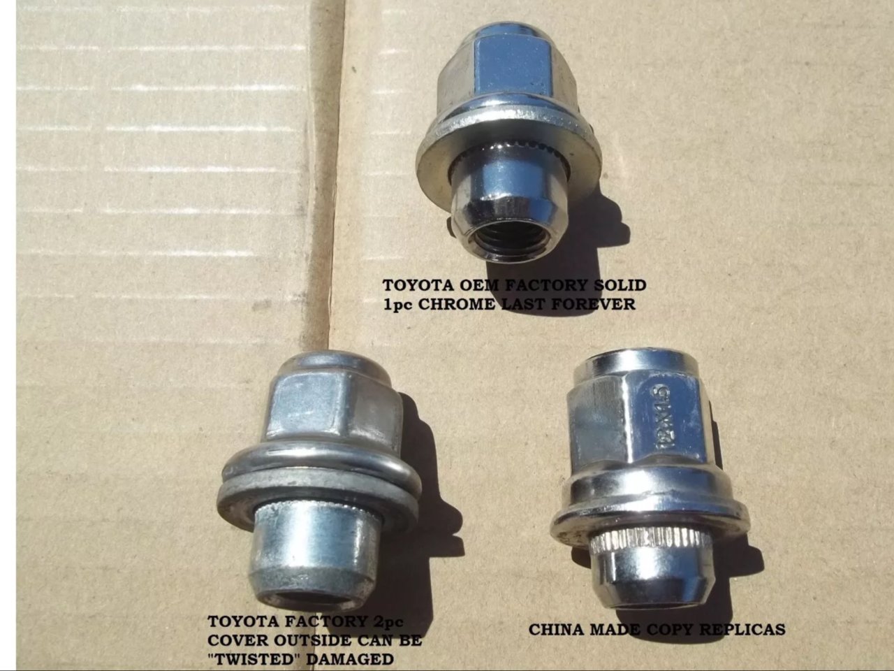

    This is not my photo.
    I bought a set of 24 Toyota factory 1-piece solid chrome lug nuts. Very happy.
