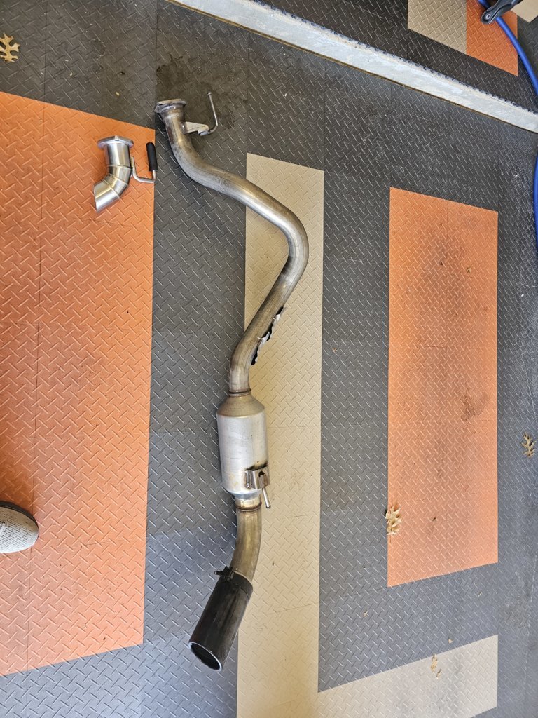

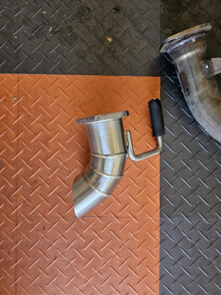

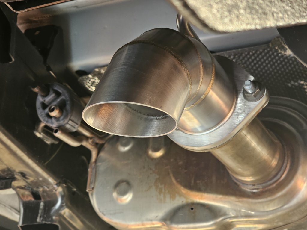

    I can't figure out why this addition is necessary instead of simply cutting off the horizontal portion of the pipe, removing the resonator, and letting the exhaust exit horizontally. There's plenty of turbulence under the truck to clear out the exhaust. Plus your exhaust is exiting a couple of inches higher than this down-turned pipe, in case you're buried in mud or snow. Seems more likely your exhaust would back up with the down turned pipe getting more easily plugged if you're bogged. Not that it's the most important factor if you're bogged, but it's not irrelevant if you're bogged. What am I missing?

    Not necessary...
    But the diameter of this pipe is a little larger than the factory pipe coming off the muffler...
    Less pipe = less restriction....
    less weight
    Looks totally clean & out of site completely...
    Just another variation of someone trying to make a dollar off of us.
    Just like fishing lures....
    You can easily also make a turn down with the factory pipe, just by cutting the pipe in the same area as the turn, flipping the pipe & flange assy over on the muffler & reweld the hanger to the top...
