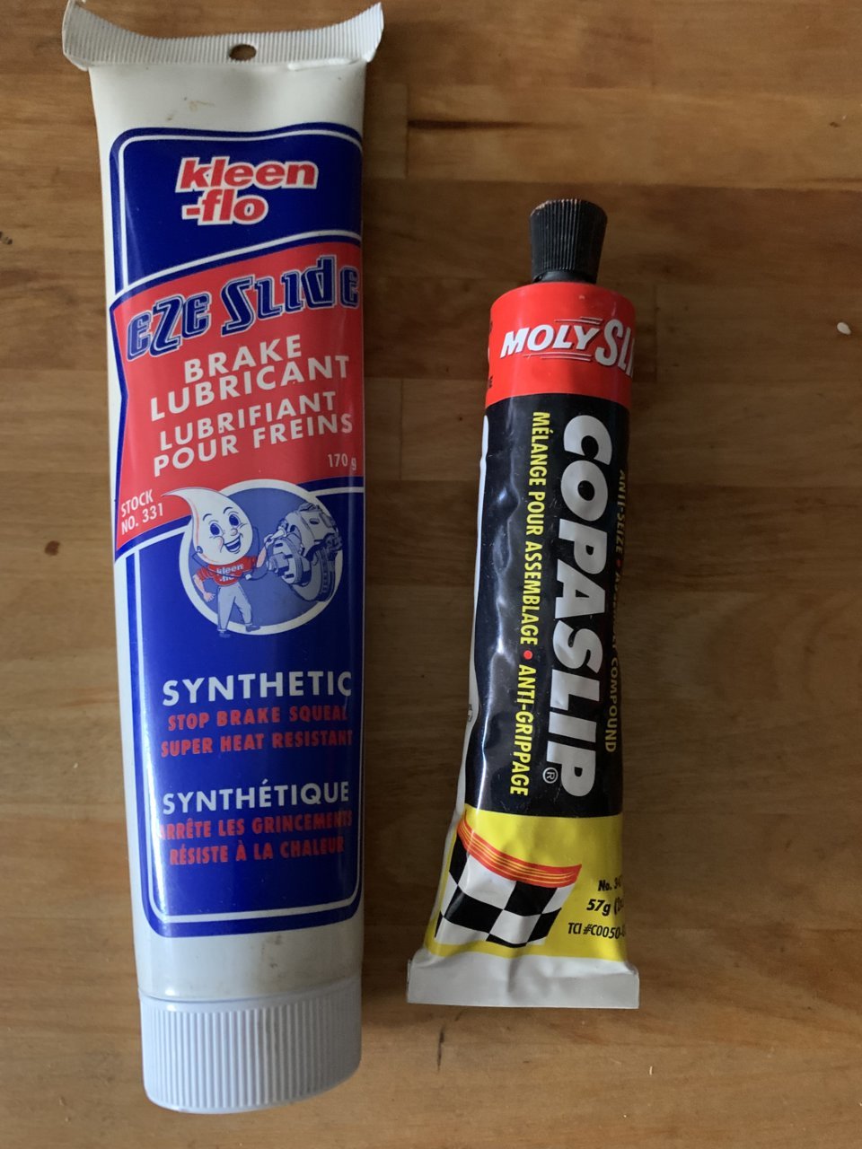

    My experience is the handbrake will replicate the problem.
    The dealer I used to go to used torque sticks the clowns overtightened some of the bolts. Loosening and torquing properly fixed the drum issue.
    I had another vibration in my 2021 taco and it was brakes requiring servicing.
    You gotta pull the pads and clean the shims and pins and apply Molly kite copper lube and lube the slider pins with brake grease.
    Now that I know this I service the brakes twice a year when I change to snows/ all seasons.
    Truck drives like it should now.

    IMG_2364.jpgThis is what I use on all vehicles.
