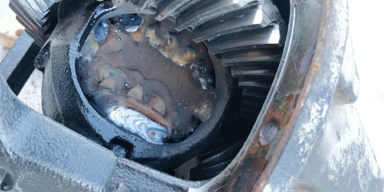

    E30325
    E30325 [OP] Well-Known Member
    Nov 23, 2016
    #203171
    4,271
    Nick
    2000 Tacoma TRD 5spd
    5100's and OME 881's, AAL and KM3's
    Went to a drivetrain shop and explained to to him and asked his opinion, he didn't have time to jack it up and look at it.
    From what I described he seemed to think it could be a shim on the spider gears that is getting eaten up, he said he doubted the actual gears are messed up because I would probably hear/feel that driving. His suggestion was to pull the drain plug again in a week or so and see if more metal is on it.
    Basically without having the third pulled he said he couldn't say for sure what it is, so I'm thinking of pulling the third myself and taking it in and having it inspected by him, he said it'd only be like $50 for him to inspect and figure out what's wrong once it's out of the truck

    Ring gear/gears look ok from pic , E-lockers aren't as strong as I once thought
