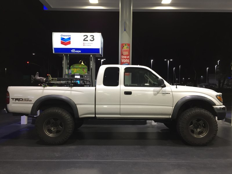

    Raised the front a bit, installed the following:
    - Bed rack with hi-lift jack
    - Tie downs in the bed along with spare tire
    - Repainted and installed front and trans RAT skid plates

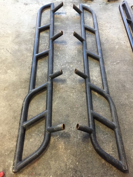

    Going to try and weld on the Beefed Taco sliders I originally had on this truck. If anything, I'll end up bolting on the BAMF set I had on my previous truck:
    quetzal and boostedka like this.

    Got the sliders on today. Thanks to @Ritchie for welding them on and the bro in law @nihkon for hanging out (ah, I guess you helped a little).
    @Ritchie and @nihkon
    Our guard dogs for the day
    @Ritchie lots of love and $$$ into this clean truck
    @Ritchie and I doing work
    Done

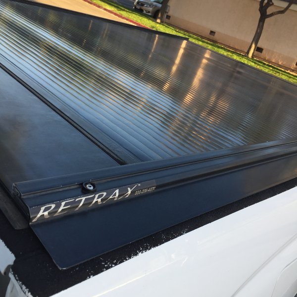

    1,368
    San Diego
  13. Feb 18, 2017 at 7:17 PM

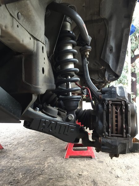

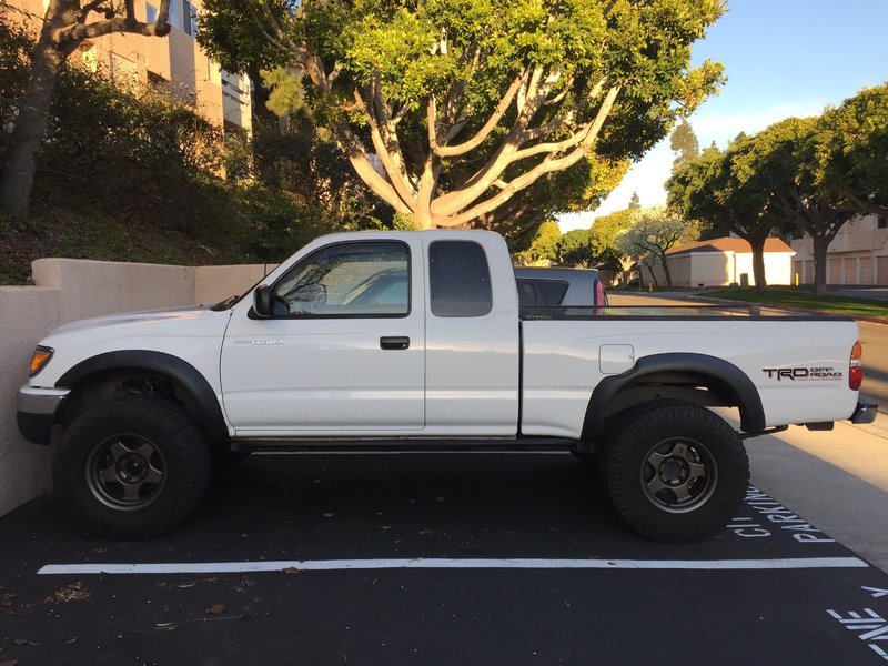

    Removed front sway bar, fender flares and got these installed (thanks @Speed Freek):

    Did you notice any difference w/o the sway bar? I've thought about getting rid of mine
  15. Feb 18, 2017 at 8:35 PM
    #115
    synergy10
    synergy10 [OP] @synergy10.sd
    Mar 28, 2013
    #100826
    1,368

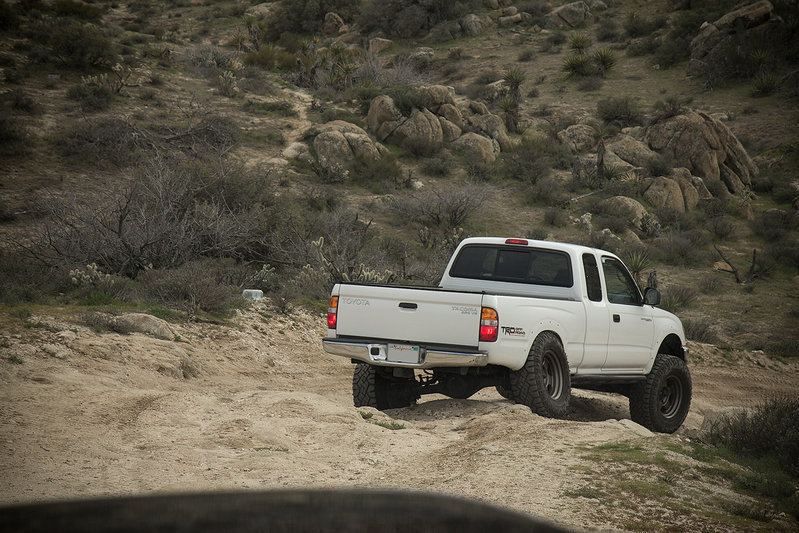

    San Diego
    I was expecting to feel the difference but it feels exactly the same on road. I can say that when I removed the 3rd leaf and 1 of the overloads in my leaf pack (this is when I still had my front sway bar on), the rear suspension rode a lot softer and that gave me more body roll. I plan to reinstall my 3rd leaf next week since the rear is actually too soft now. So we'll see how the ride feels once I have that back in.
    I'm going out to hit the trails tomorrow with some friends. I'm curious to see if removing the sway bar helps when off road at all. Based on the guys I know that have removed it, as long as you have aftermarket/stiffer springs up front, on road it feels the same but makes a difference off road.
    boostedka[QUOTED] likes this.
