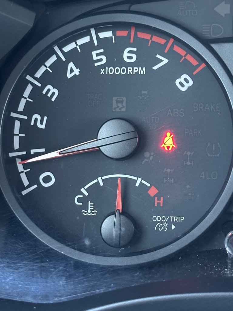

    Hey what rpm should it idle at? was just sitting in parking lot and started to get a slight vibration in the seat almost as if it were going to stall. Turning ac on or off made no difference. Haven’t noticed this before. I don’t know if it’s running hot either where the temp usually is

    Thanks for the info Rob tried to pm but I guess you can’t had another question just posted above for you or anyone thanks

    That's perfect. 800 RPM +/- & the temp 1/2 way up.
    Exactly like mine, I'll post a pic, if I remember to take one.
    Have a great night buddy. :cookiemonster:

    You're throttle body probably needs to be cleaned. Take off the intake hose & spray it in there with the engine running. Helps if someone steps on the gas off & on.
