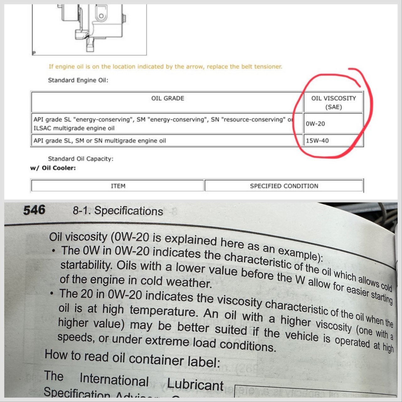

  10. Jul 23, 2023 at 10:01 AM
    #310
    lavrishevo
    lavrishevo Well-Known Member
    Jul 11, 2023
    #428769
    553
    2023 Trail Edition
    Refuse to believe the owners manual? I suggest you read it again if you think You can’t run thicker viscosity than 0w-20. Page 546 if that helps. Also, it’s obvious what the service manual states. You can run anything between 0w-20 to 15w-40.
    e6400ultra and AM6217 like this.

    Oh I'm fully aware of what's in the manual this is why it is important to actually read it. Toyota spend millions of dollars perfecting these things listen to them not what the want a be neighbor mechanic suggested. Personally I like my 5K changes it also forces me to check every thing while I'm under it actually greasing U joints etc. I'm a 38 year veteran of the fix it industry before I got a clean job!
