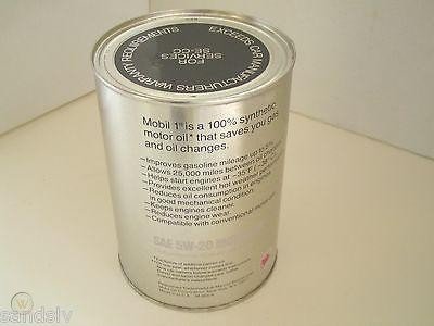

    Nice Marketing claim. Did Mobil test the oil in EVERY engine configuration or just a few???
    Although, the Mobil 1 may be good. I have to wonder if Mobil knows more about my engine than the folks who designed it, tested it, engineered it and wrote the Maintenance schedule based on the results of the design and testing.
    Thanks just the same. I'll be following the Maintenance Schedule for my truck.

    The interesting thing about Marketing claims.
    The claim only needs to be supported by a repeatable test and data from 1 (one) sample.........
    After that, the consumer can believe or assume the "benefit" will apply to his need.
