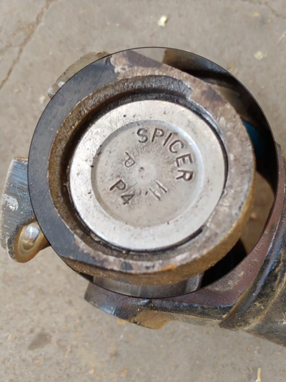

    Are you planning to do the carrier bearing and u-joints yourself or have a shop do them?
    I did mine myself. Keep an eye on the yokes,
    Better shot of the damaged flange.
    I have no idea how long I was driving around like that. The rear u joint had been replaced before I bought it.
    This yoke would not budge, I soaked it with PB all day and still nothing. I needed a shop press, again.

    Help me out here bro. Not sure what damage I am looking for in these pics. I just changed out the carrier bearing in mine last week.

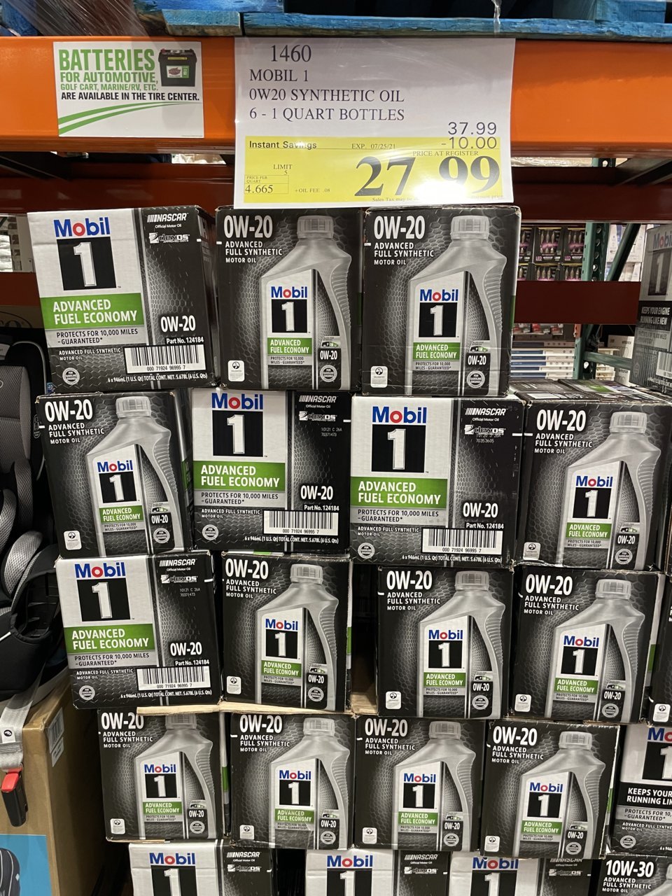

    Synthetic is better than conventional and well worth the extra cost. Brand doesn't matter, just buy the right weight. Even if it costs twice as much, it lasts twice as long and will protect better. I used to not believe that, but I've seen too much evidence.
    I can buy 10 quarts ( two 5 qt jugs) of synthetic at Costco for $25 and change it myself at 10,000 miles. Doesn't get much cheaper than that.

    Help out here bro. Not sure what damage I am looking at on the pics?

    Have a close look.
    Looks like the retaining lip for the Snap ring is busted off?1F4830FF-6B16-4E0B-A9AB-7ECDA1131C1E.jpg

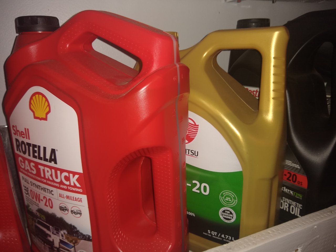

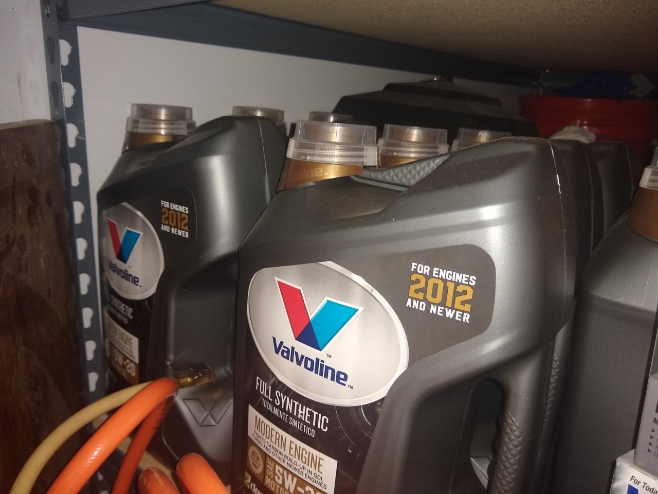

    OP synthetic allows you to extend oil intervals and gives extra protection at the extremes, hot and cold. Dino oil is fine, just not as fogiving about longer oil changes.
    I prefer to change brands, since they have different additives.
    Buy syn oil on sale. Every November and December Autozone clearences it out for $2 to $1 a quart.
    My average cost for the oil below is about $1.50, 1.60 a quart., $10 to $5 for a 5qt jug.

    That’s right. Thanks for pointing that out @TnShooter I was busy today. I’m guessing when the u-joint was installed they hammered it in from the other side and blew out that retainer lip. If that thing had let go mannn, that would have sucked.
    As far as the yoke by the carrier bearing goes mine was just seized on the splines, nothing was broken there.
