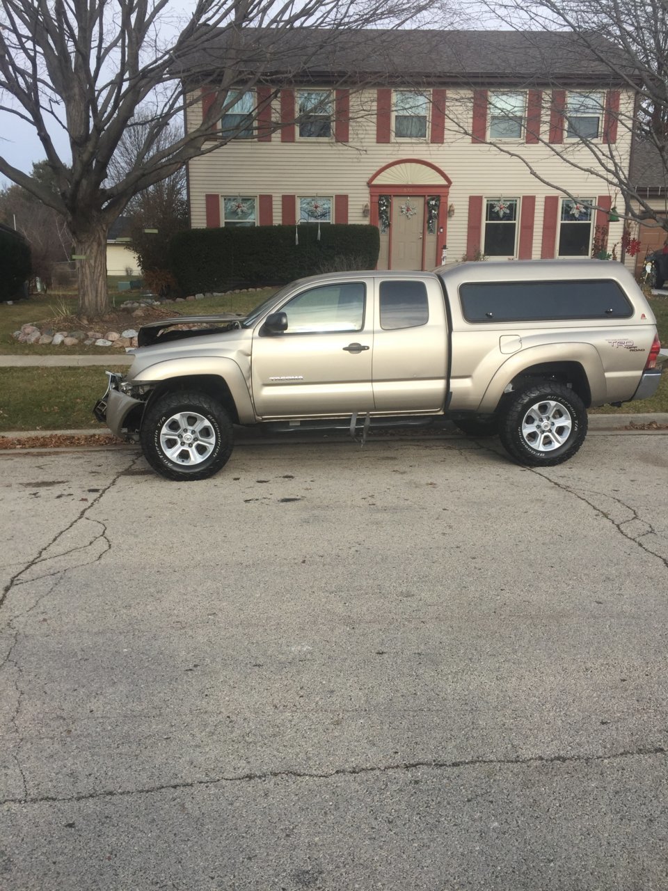

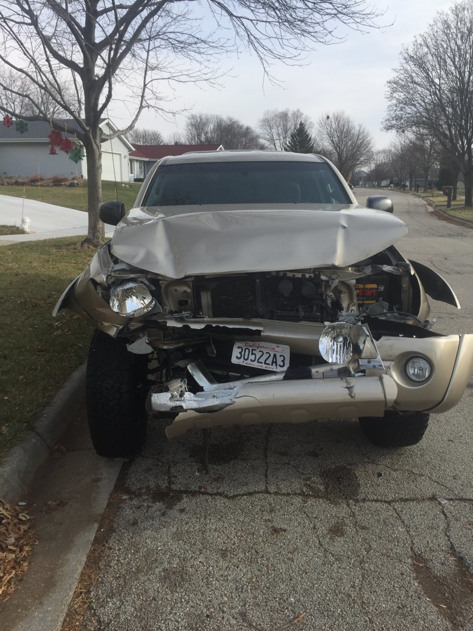

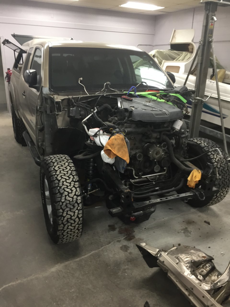

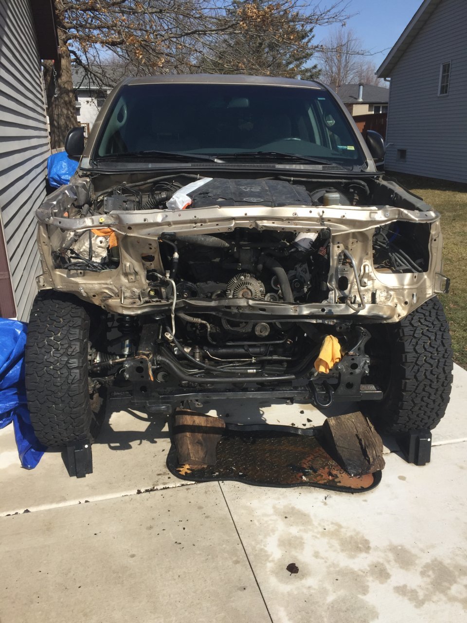

    Ok ....After the crash and before the body shop

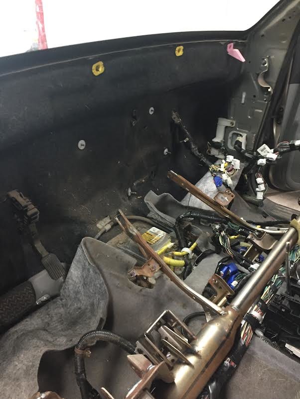

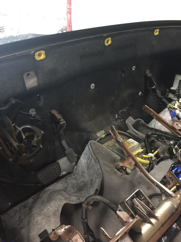

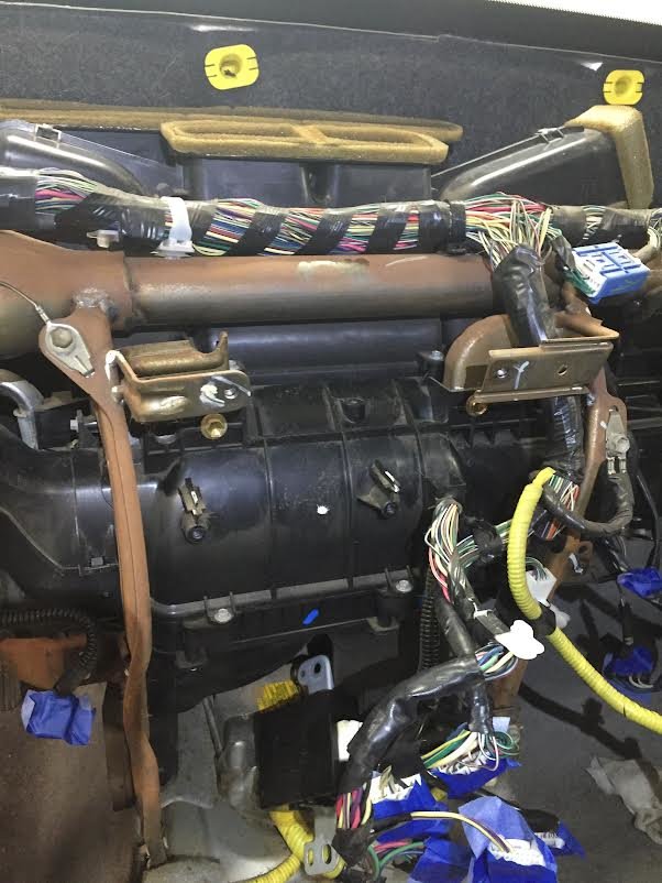

    I had to pull open the dash for the body shop to weld in the new apron fender. The carpeting need to be pulled away so it didn't catch fire. I cleaned the HVAC Box and reinstalled. 0-5.jpg0-1.jpg 0-2.jpg

    the immobilizer is separate from the airbag system, the airbag system will send a signal to the PCM to cut the fuel pump when a crash is detected but a key cycle resets it.
    Typically when there is a collision with airbag deployment the affected crash sensors, airbags, pretensioners, and the airbag ECU have to be replaced.

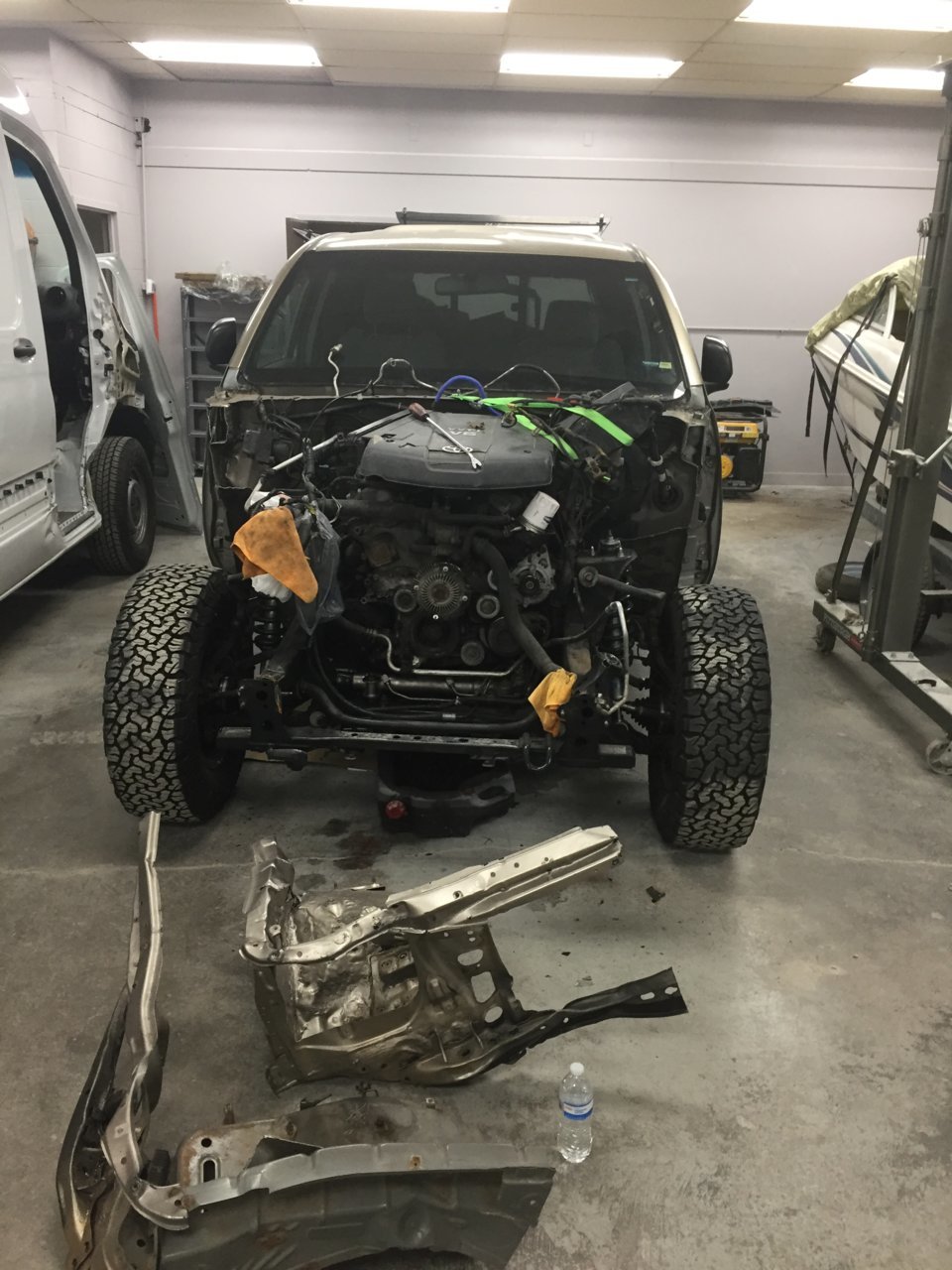

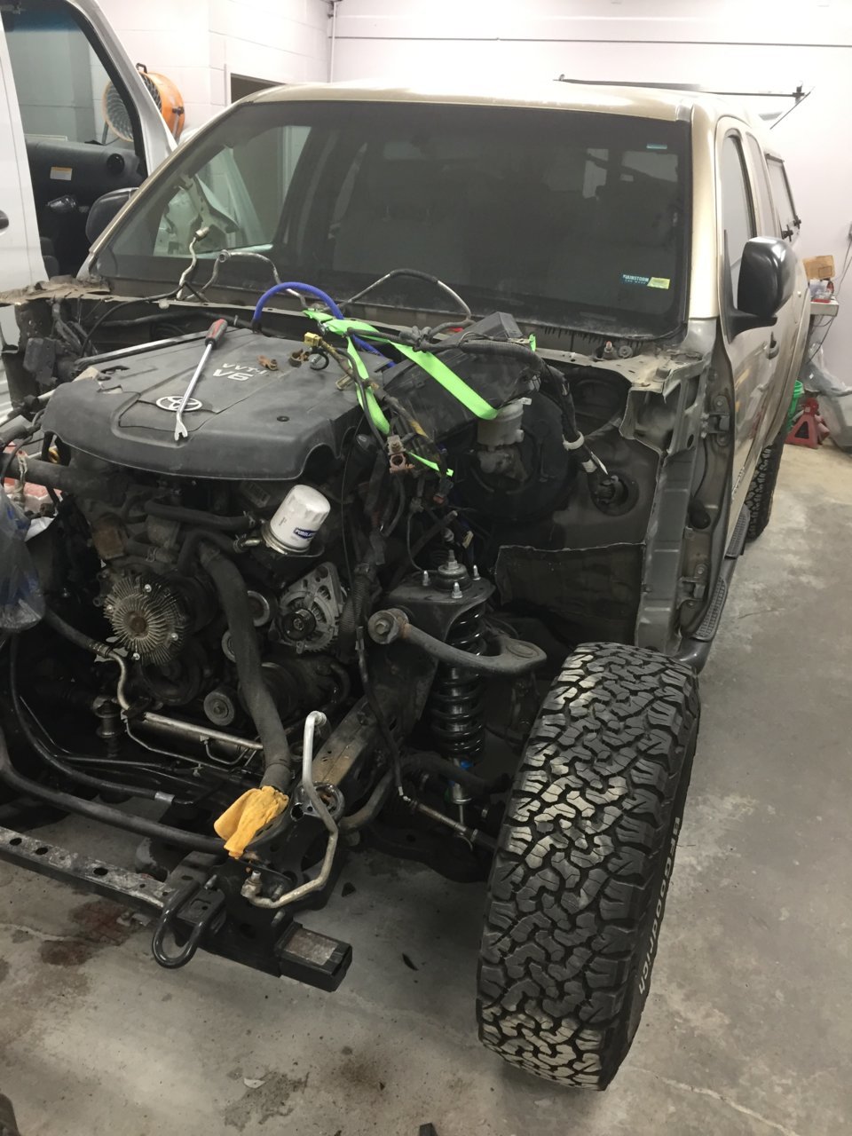

    In the body shop.....You don't see them like this much!

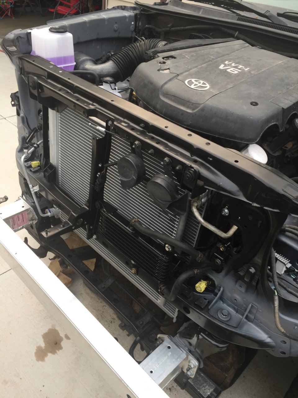

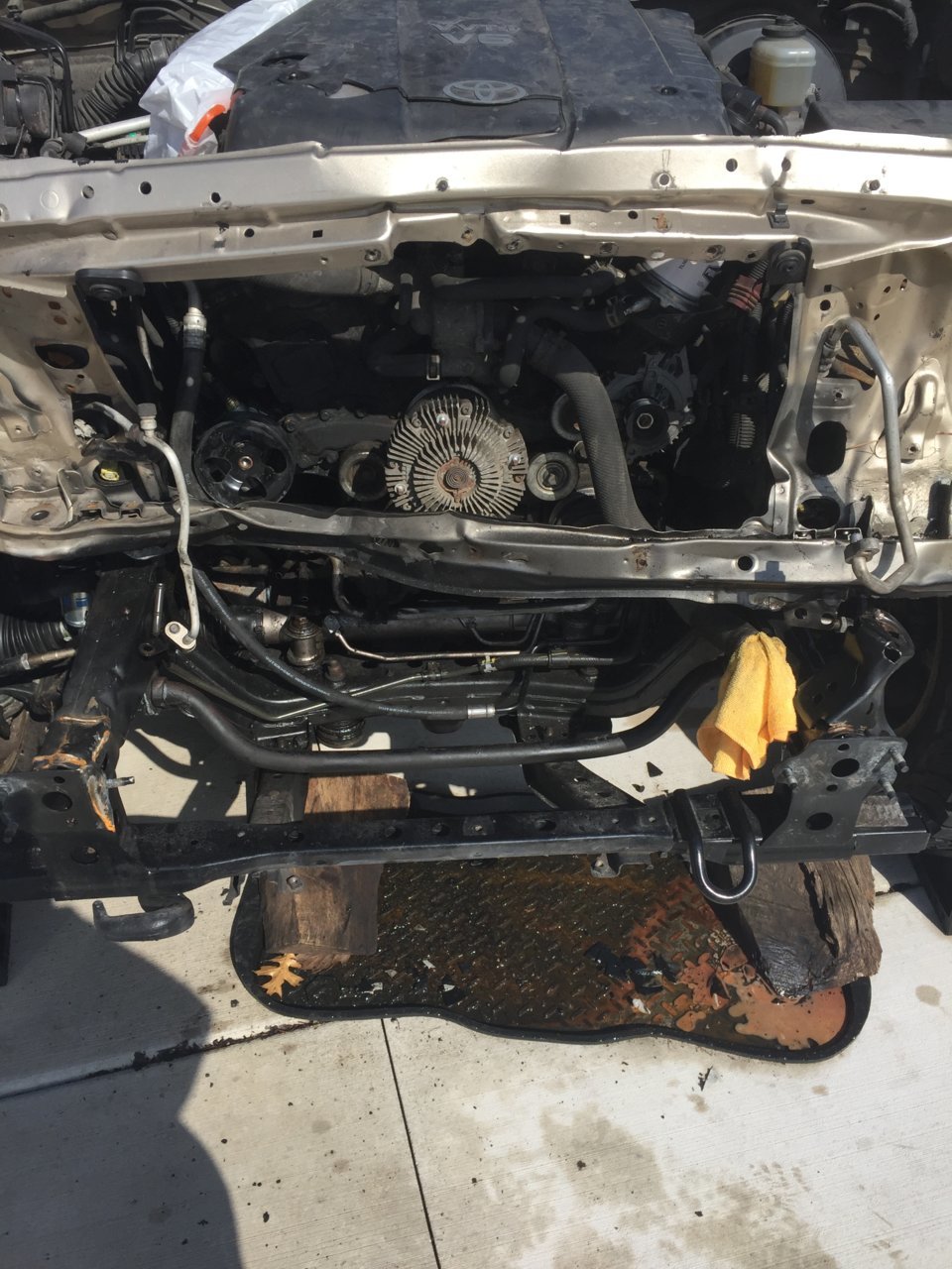

    I'm getting closer

    Things I've done since i got it back from the body shop.
    Dash reassembled
    Power Steering Pump Pulley swapped
    New Fan, Fan Clutch and Shroud
    New AC lines and Condenser
    New Radiator and Trans Cooler
    New Clock Spring, Air Bag and Seat Belt
    New Air Bag Sensors and Control Module
    New Bumper Bar
    She's holding fluids!
    I need a couple fuses, Battery charged and I'm gonna turn her on!
    I'm waiting on a Hood ....back ordered for three more month...ugh!
